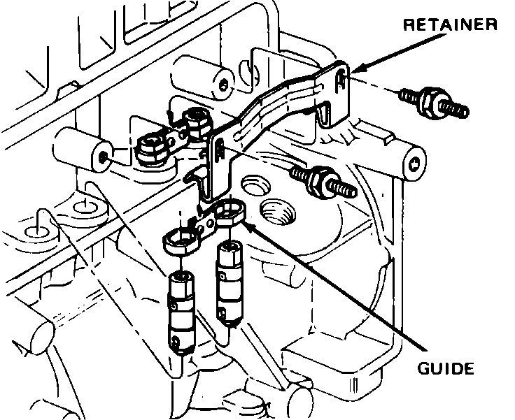

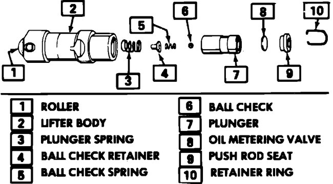

Is this a 2.5L? They didn't offer the 2.2 in the truck in 1990. I believe it was introduced to the S-10 line in 1994. Please confirm that for me. Also, this engine uses hydraulic lifters that are not adjustable. Here is the only thing I have for adjustment. The two attached pics correlate with the directions.

Fig. 5 Lifter & Guide Plate Removal
pic 1
Removal/Installation
1. Remove rocker and side covers.
2. Loosen rocker arms and remove pushrods, noting position for installation.
3. Remove guide plate and clamp, Fig. 5, then the lifter.
4. Reverse procedure to install, tightening side cover nuts to specifications.
Fig. 6 Hydraulic Roller Lifter Exploded View
pic 2
SERVICE
Disassembly
1. Depress pushrod seat with pushrod, remove seat retainer, Fig. 6, then slowly release spring tension.
2. Remove pushrod seat and metering valve.
3. Invert lifter and tap on flat surface to remove plunger. If plunger cannot be removed, clean with solvent and repeat step 3.
4. Remove ball check valve assembly using small screwdriver.
5. Remove plunger spring from lifter body.
6. Clean lifter components in solvent, keeping components for each lifter separate.
Inspection
1. Inspect lifter body for internal and external wear and scuffing, and inspect bottom for wear grooves and flat spots.
2. Inspect roller for free operation, flat spots and pitting. Replace lifter if roller is worn, pitted, or if roller cannot be freed-up.
3. Inspect pushrod seat, and replace lifter and pushrod if seat is scored or excessively worn.
4. Inspect check ball and replace lifter if ball is pitted or scored. Do not attempt to recondition lifter assembly by interchanging components from other lifters. If components are damaged or worn, lifter assembly should be replaced.
Assembly
^ Ensure lifter components are kept clean during assembly, as small particles of dirt or lint can cause lifter to fail.
1. Position check ball on small hole in bottom of plunger.
2. Install check ball spring and retainer, Fig. 6, over check ball, then press retainer into position in plunger with small screwdriver.
3. Install plunger spring over check ball retainer, align oil holes in lifter body with plunger, then slide body over spring and plunger.
4. Fill lifter with SAE 10 engine oil and proceed as follows:
a. Using a 1/8 inch drift, press plunger into lifter body until oil holes in plunger and body are aligned.
b. Insert 1/16 inch pin through oil holes to lock plunger into body.
c. Remove 1/8 inch drift and fill lifter with SAE 10 engine oil.
5. Install metering valve, pushrod seat and seat retainer.
6. Depress pushrod seat to relieve spring tension, then remove 1/16 inch pin holding plunger.

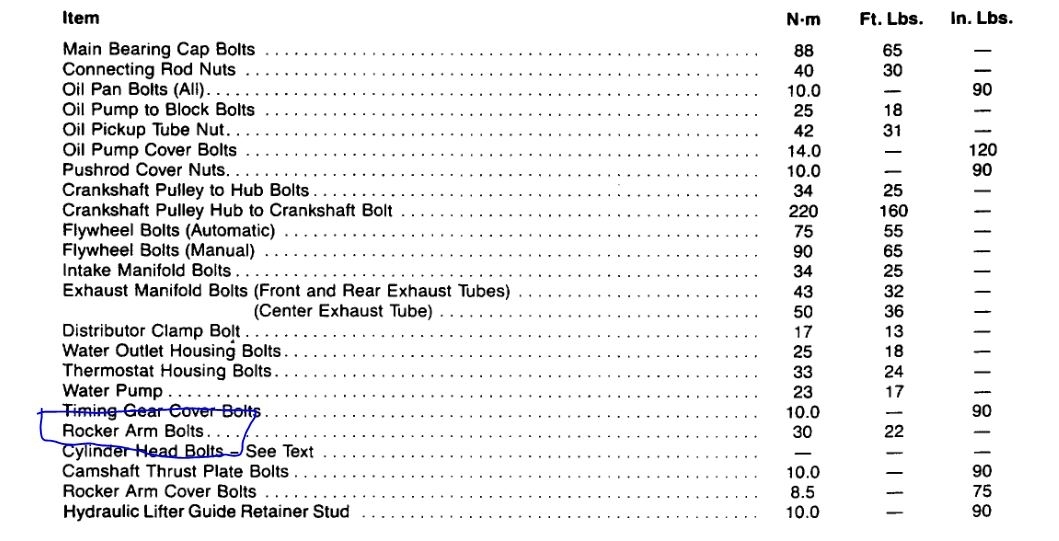

Apr 14, 2020 at 10:21 AM
Good evening,
They only list the 2.5 engine is I am going to give the procedure for that.
The valves are not adjustable.. They are torqued down to a spec..
This engine uses hydraulic lifters that are not adjustable.
I attached the torque specs for you below.
