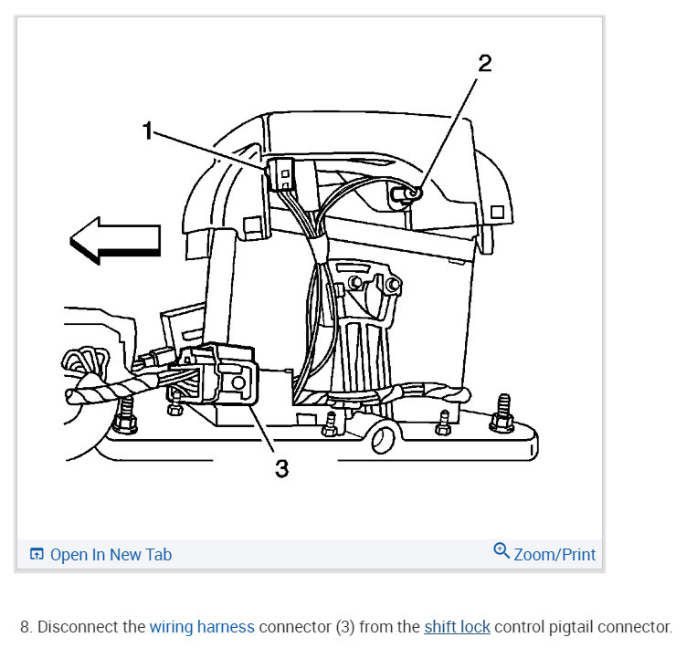

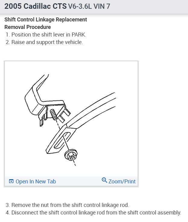

I drove my vehicle the other day and everything was running fine then the following day I tried starting the car and it wouldn't crank at all and my key gets stuck in the ignition. which I have to push the release button under the steering wheel column. But, everything else are all working fine. The service theft system showed up on my DIC screen. I also scanned it without engine light and my OBDll detected PO160 which is o2 sensor bank 2, position 2 and U0100 is the network issue. I know one problem is the cause/causing everything else to malfunction. I have tried relearning/reprogram the key as I have in the past and I succeeded but now It will not work. In need of help if possible without going the "stealership", thanks.

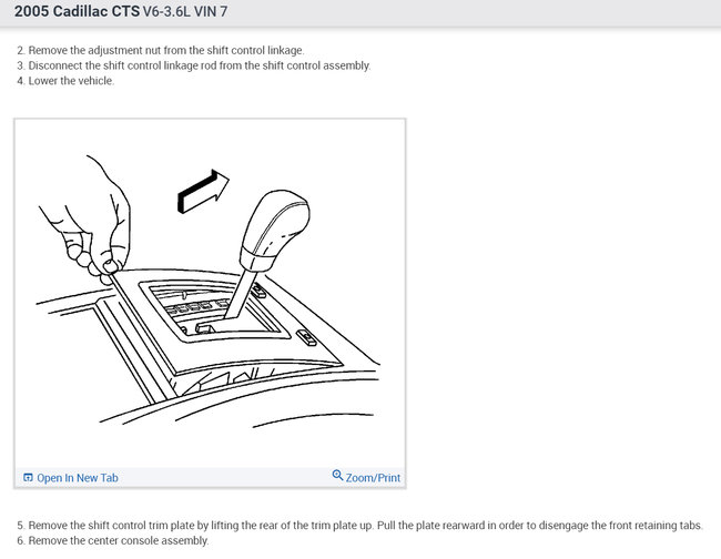

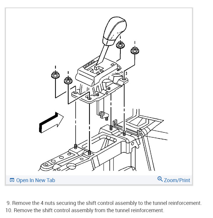

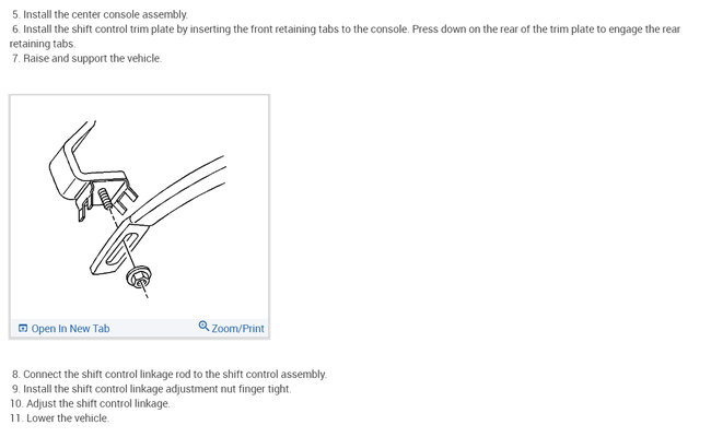

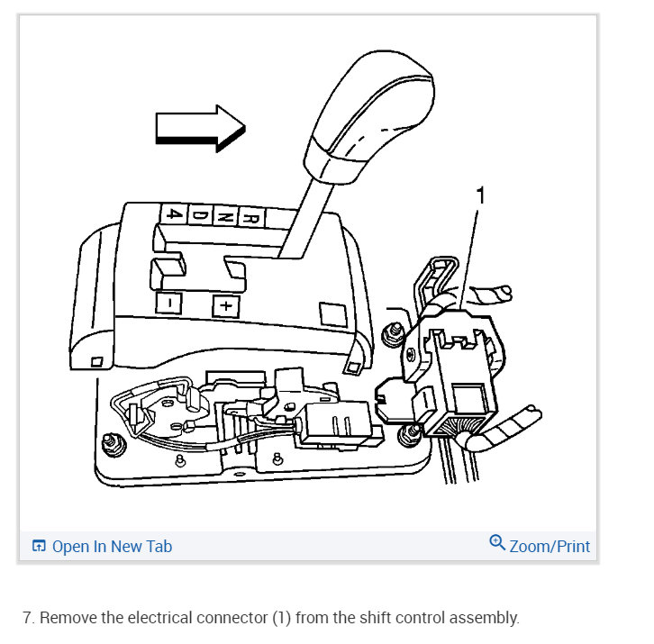

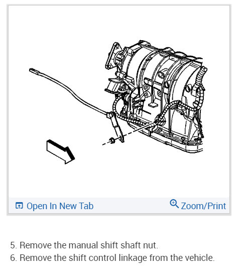

Yep, common problem with these cars the shift arm needs to be replaced. here are instructions and diagrams to help you fix it. Check out the diagrams (below). Please let us know if you need anything else to get the problem fixed.
