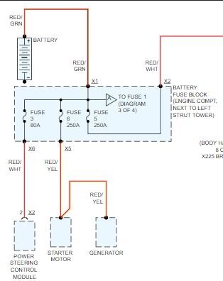

Like a day of two ago it was having some issues starting so I jumped it, but couple days later today I tried to start it and there was no juice. I even tried jump starting it after letting it charge but it no lights come on or nothing starts. so I can't even get it to turn on now. is there any safety parameters that kicked in or something?
Please help

Have you checked all the main fuses in the underhood fuse box?
Jan 1, 2019 at 5:13 PM
INDERBIRSINGHDEOL
  • 11 POSTS
I checked all the fuses they all seem okay, none of them was burnt or anything. how can I get the car started?

If there are now blown fuses, did you check to see if there is power to the fuse box? If there isn't, then you need to check the main fuses in the battery fuse box located near the left strut tower under the hood. If there is no power, confirm fuses 5 and 6 are good. See the attached schematic.

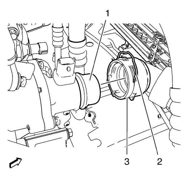

Now, if you find compression low in cylinder 4, add about a tablespoon full of motor oil into cylinder 4 through the spark plug hole. If compression increases, then the problem is related to the piston rings. If it doesn't, then we have to check for a possible blown head gasket. Here is a link that shows how that is done:
If you find the head gasket isn't an issue, then the cylinder head needs removed so you can inspect the valves for damage. Here are the directions for cylinder head replacement. They are very extensive. Don't even consider this until you have done the aforementioned tests. Also, once you do the tests, I will be better able to give you an idea as to what it may cost to fix.

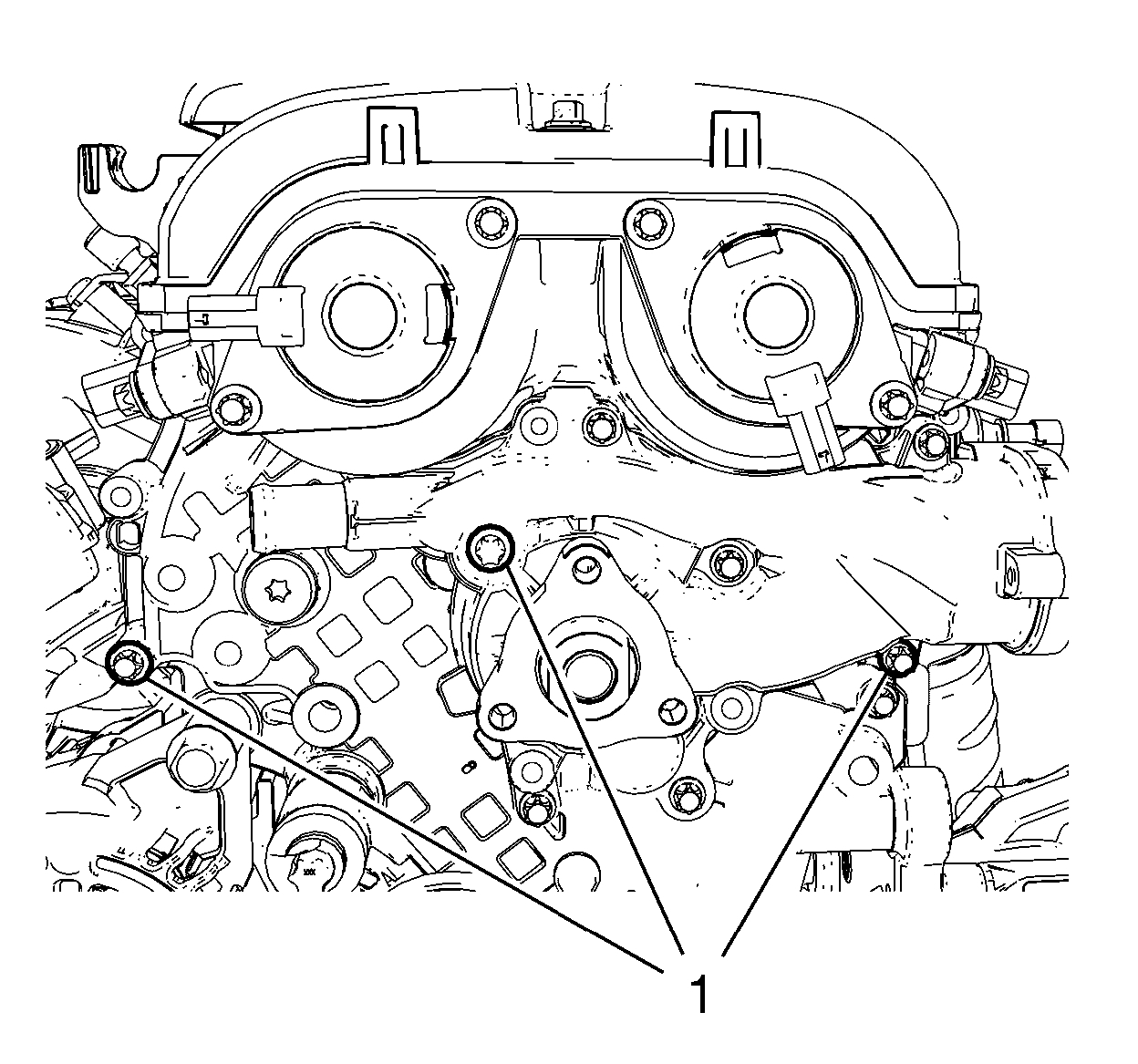

CYLINDER HEAD REPLACEMENT
Cylinder Head Replacement All attached pictures correlate with these directions.

1. Disconnect the battery negative cable. Refer to Battery Negative Cable Disconnection and Connection See: Negative > Removal and Replacement > Battery Negative Cable Disconnection and Connection.
2. Remove the engine sight shield.
3. Remove the air cleaner assembly along with the air cleaner outlet duct. Refer to Air Cleaner Assembly Replacement See: Air Cleaner Housing > Removal and Replacement and Air Cleaner Outlet Duct Replacement See: Air Cleaner Fresh Air Duct/Hose > Removal and Replacement > Air Cleaner Outlet Duct Replacement.
4. Remove the positive crankcase ventilation pipe. Refer to Positive Crankcase Ventilation Hose/Pipe/Tube Replacement See: PCV Valve Hose > Removal and Replacement > Positive Crankcase Ventilation Hose/Pipe/Tube Replacement.
5. Remove the intake manifold. Refer to Intake Manifold Replacement See: Intake Manifold > Removal and Replacement > Intake Manifold Replacement.
6. Remove the turbocharger. Refer to Turbocharger Replacement See: Turbocharger > Removal and Replacement > Turbocharger Replacement.

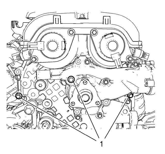

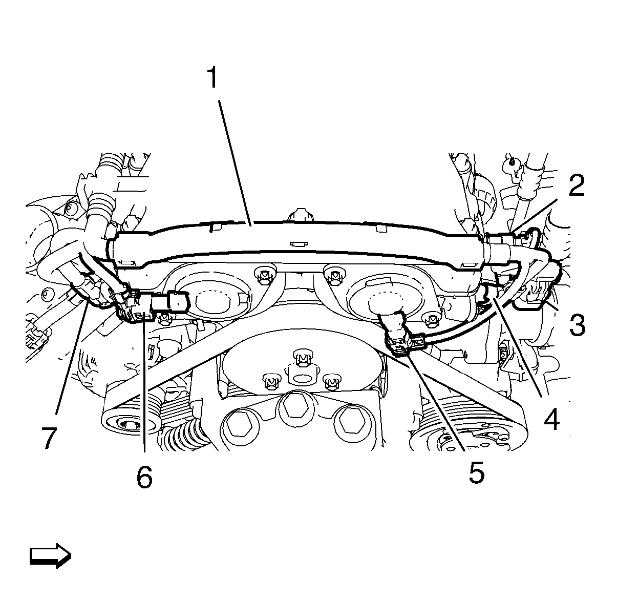

7. Remove the engine control module wiring harness (1) from camshaft cover:
* Disconnect the intake camshaft position sensor wiring harness plug (7).
* Disconnect the intake camshaft position actuator solenoid valve wiring harness plug (6).
* Disconnect the exhaust camshaft position sensor wiring harness plug (4).
* Disconnect the exhaust camshaft position actuator solenoid valve wiring harness plug (5).
* Disconnect the engine coolant temperature sensor wiring harness plug (3).
8. Place a drain pan underneath the vehicle.

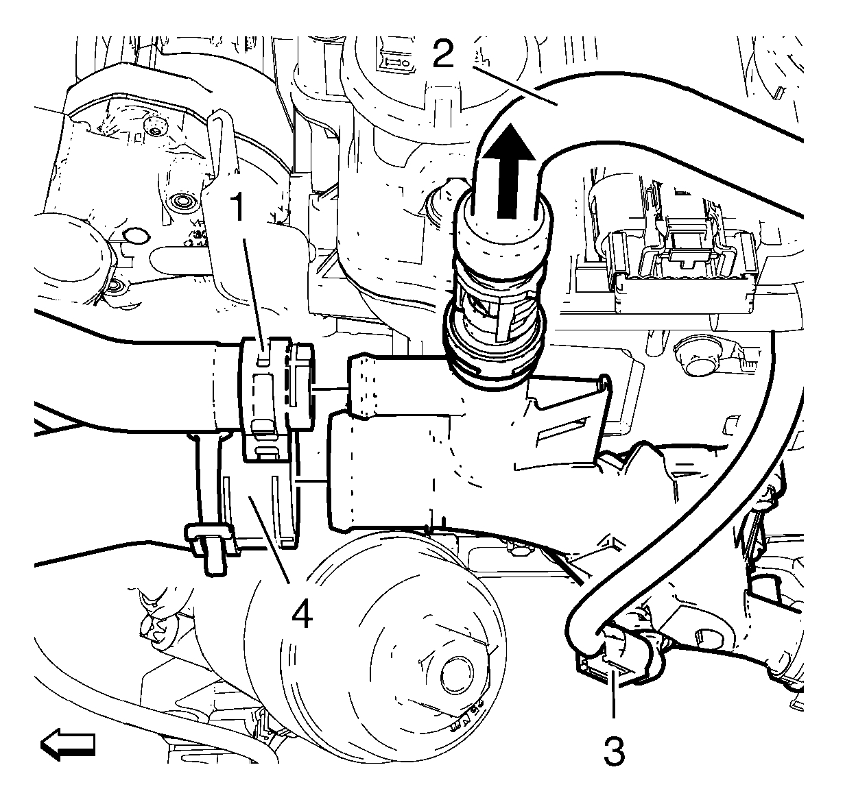

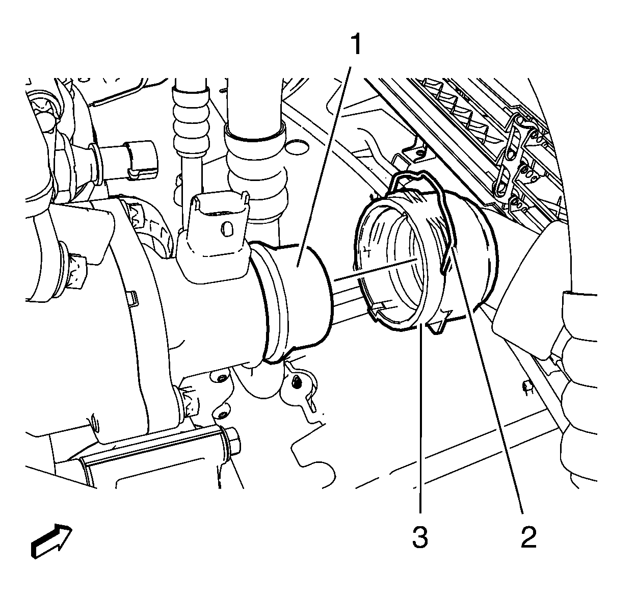

9. Remove the oil cooler inlet hose clamp and the oil cooler inlet hose (1).
10. Remove the radiator inlet hose clamp and the radiator inlet hose (4).
11. Remove the engine coolant air bleed hose (2).
12. Disconnect the engine coolant temperature sensor wiring harness plug (3).
13. Remove the heater inlet hose from the water outlet. Refer to Heater Inlet Hose Replacement (1.8L LUW and LWE) See: Heater Hose > Removal and ReplacementHeater Inlet Hose Replacement (1.4L LUV) See: Heater Hose > Removal and ReplacementHeater Inlet Hose Replacement (2.0L Diesel LUZ) See: Heater Hose > Removal and Replacement.

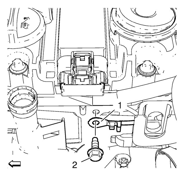

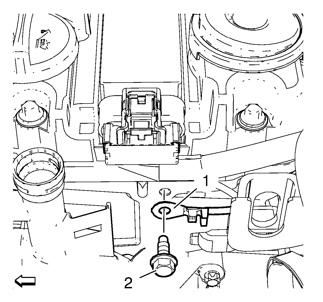

14. Remove the ground cable bolt (2) and the ground cable (1).
15. Unclip the radiator outlet hose quick connector clamp (2).
16. Remove the radiator outlet hose (3) from the engine coolant thermostat housing (1).
17. Remove the engine mount bracket. Refer to Engine Mount Bracket Replacement - Right Side See: Engine Mount > Removal and Replacement > Engine Mount Bracket Replacement - Right Side.
18. Remove the drive belt. Refer to Drive Belt Replacement See: Drive Belt > Removal and Replacement > Drive Belt Replacement.
19. Remove the water pump pulley. Refer to Water Pump Pulley Removal See: Engine > Overhaul > Water Pump Pulley Removal.

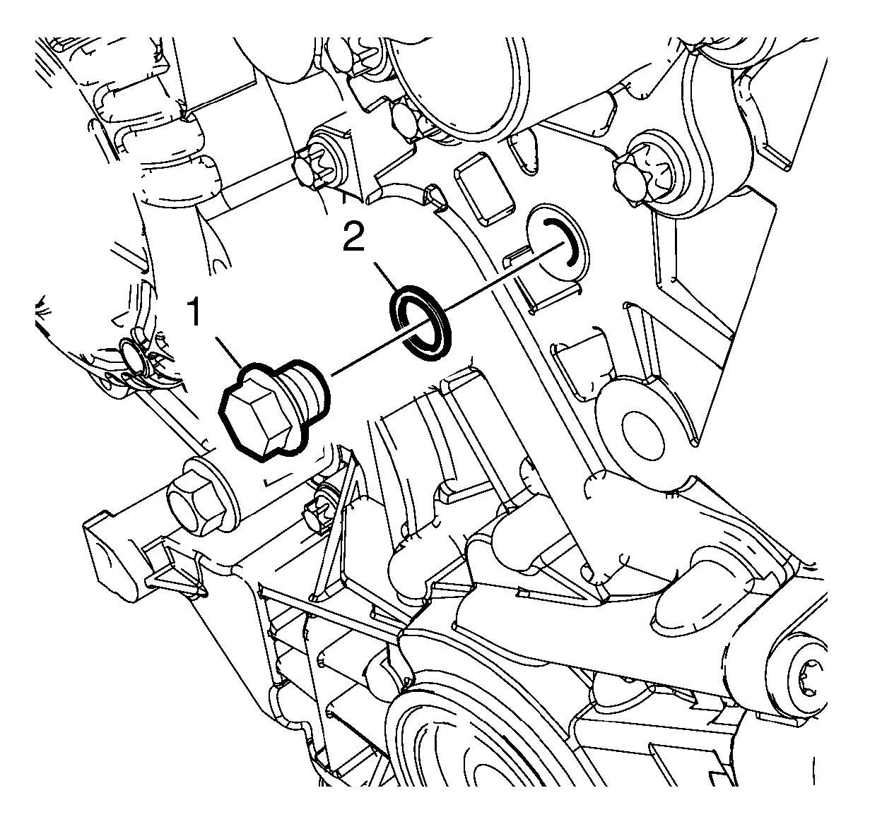

20. Remove the drain plug (1) and the seal ring (2) and allow the remaining coolant fluid to drain out of the engine block. DISCARD the seal ring.
21. Install the drain plug (1) and a NEW seal ring (2) and tighten the plug to 15 Nm (11 lb ft).

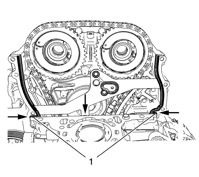

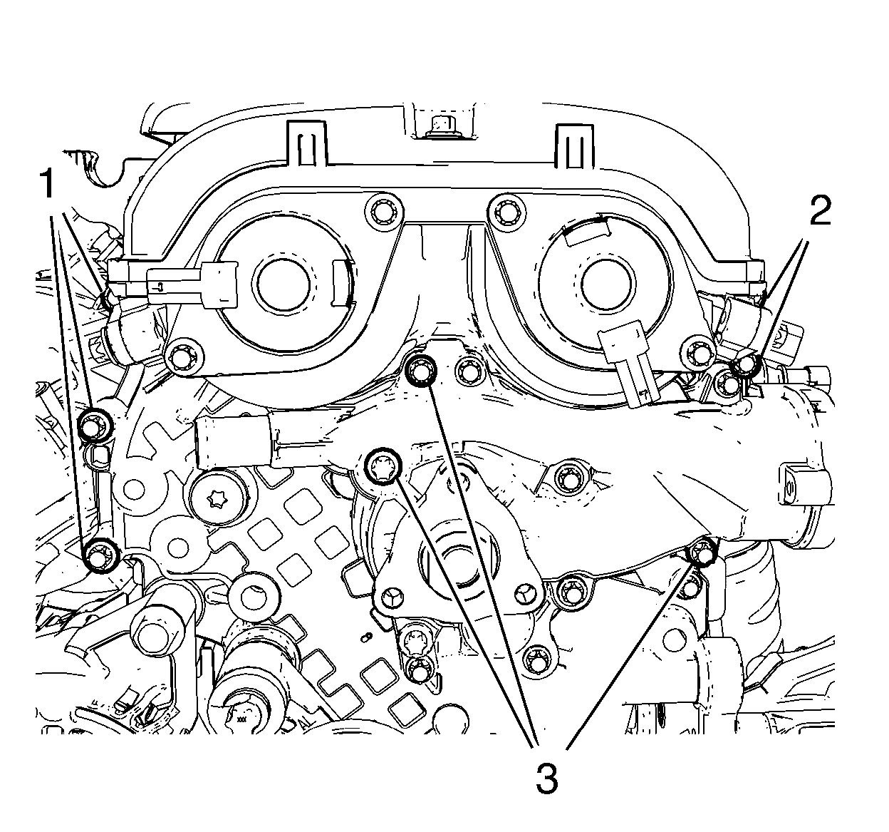

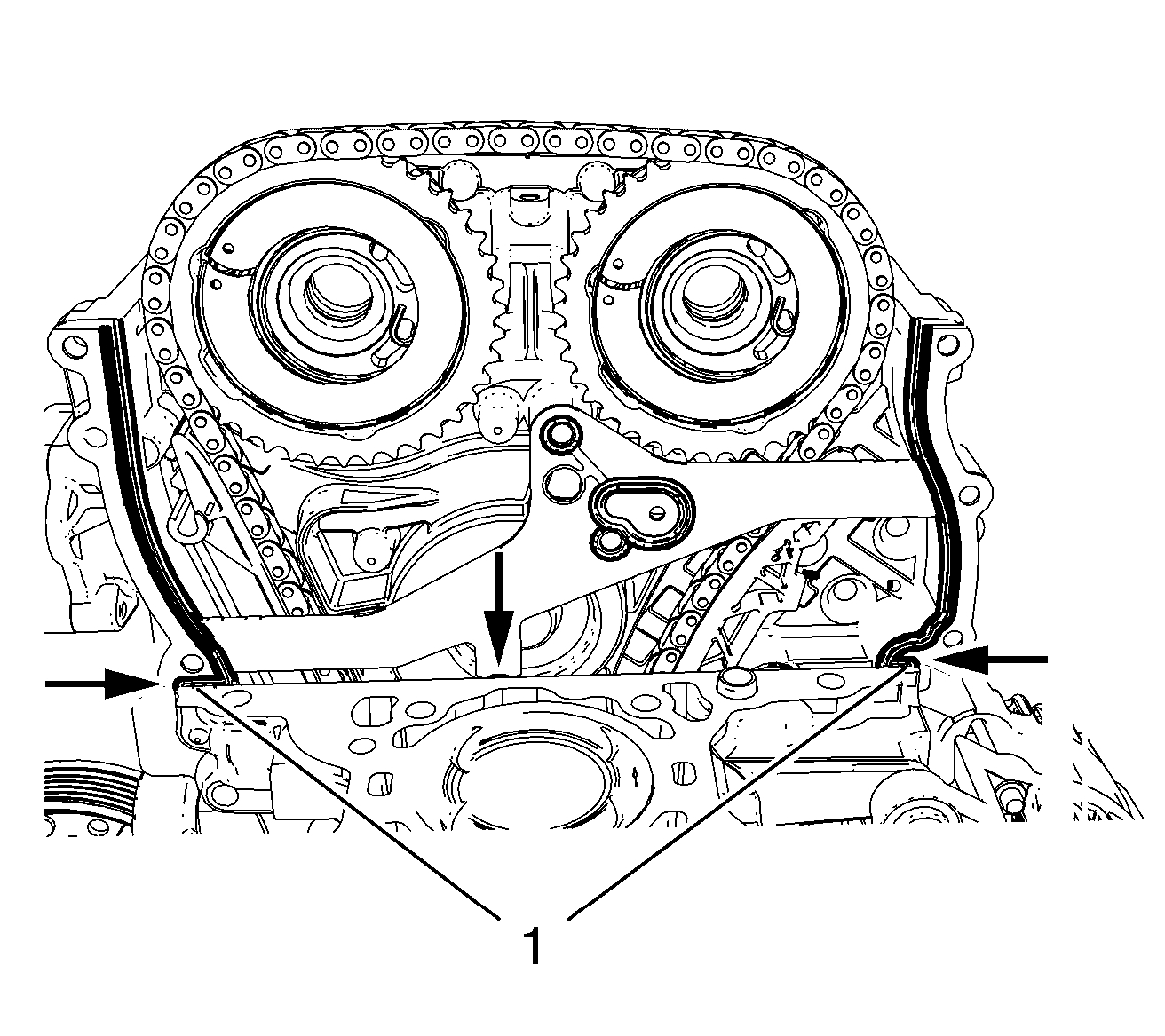

22. Remove 5 engine front cover bolts (1, 2).
23. Remove 3 water pump bolts (3).

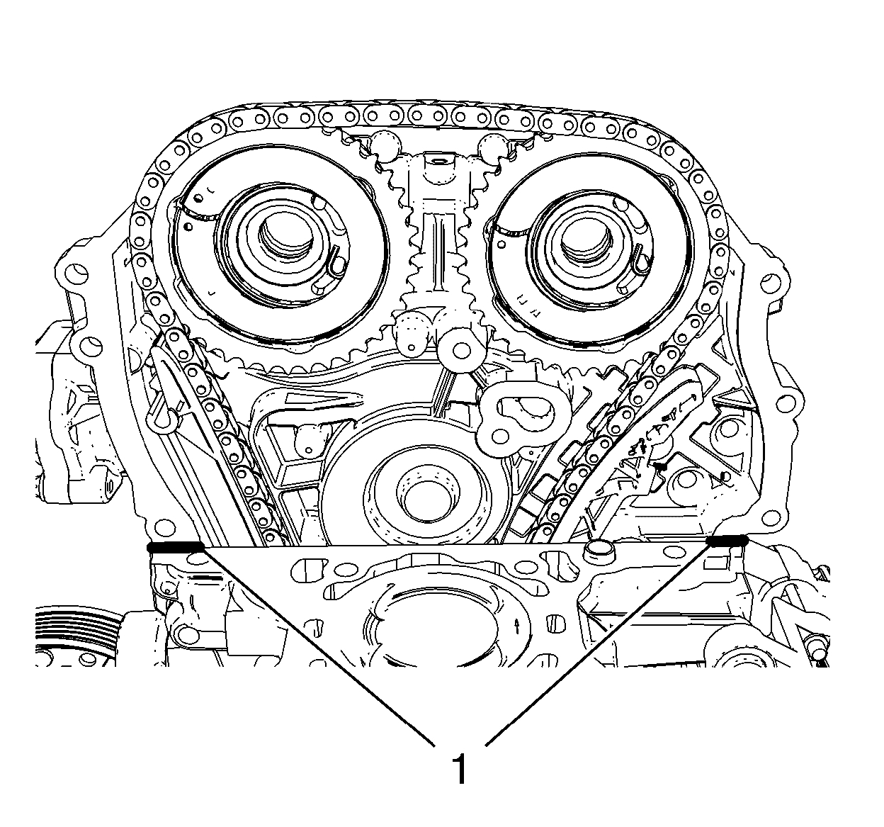

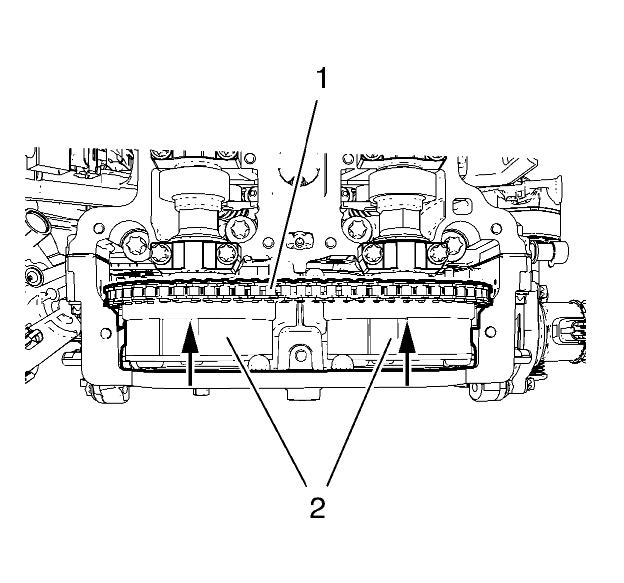

28. Set engine to TDC. Refer to Camshaft Timing Chain Adjustment See: Engine > Overhaul > Camshaft Timing Chain Adjustment.

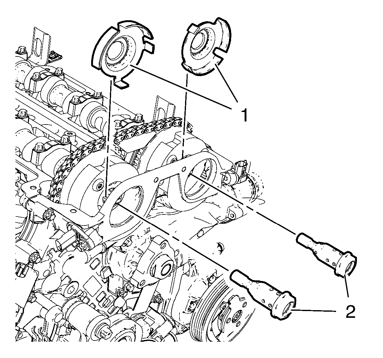

29. Remove the 2 camshaft position actuator solenoid valves. Refer to Camshaft Position Actuator Solenoid Valve Removal See: Engine > Overhaul > Camshaft Position Actuator Solenoid Valve Removal.

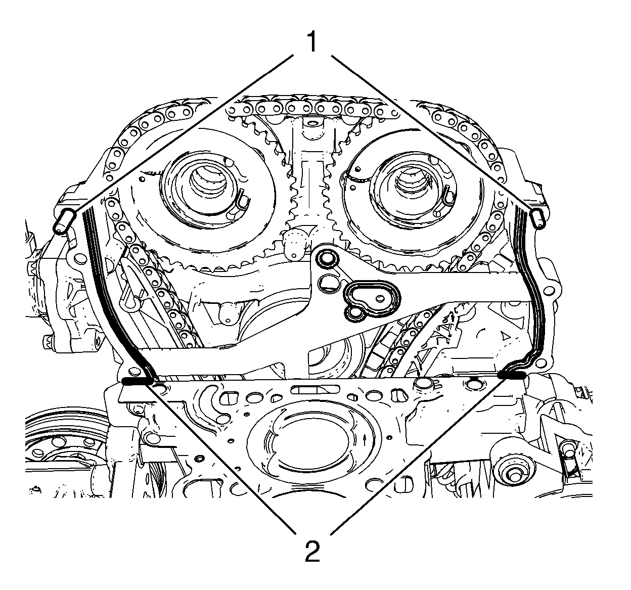

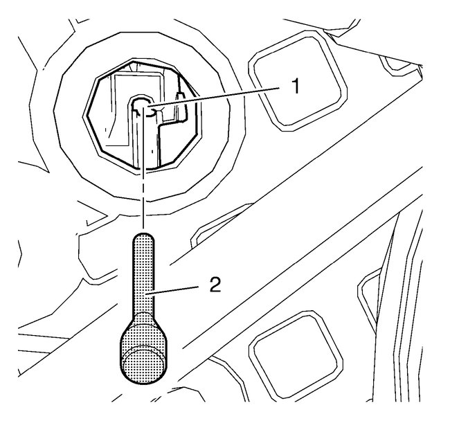

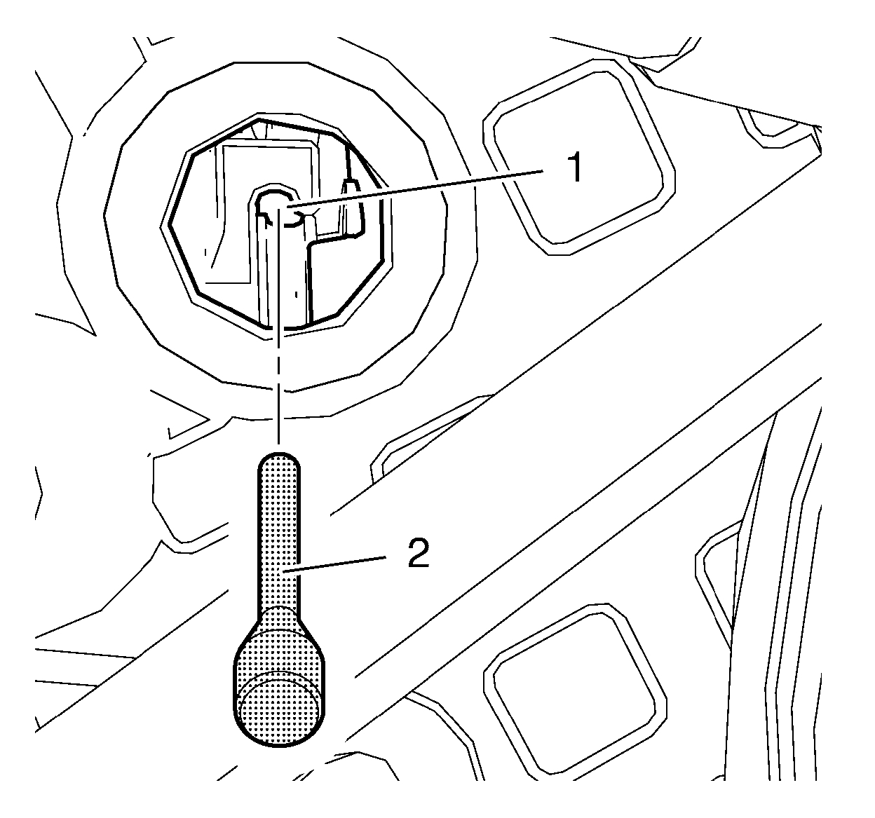

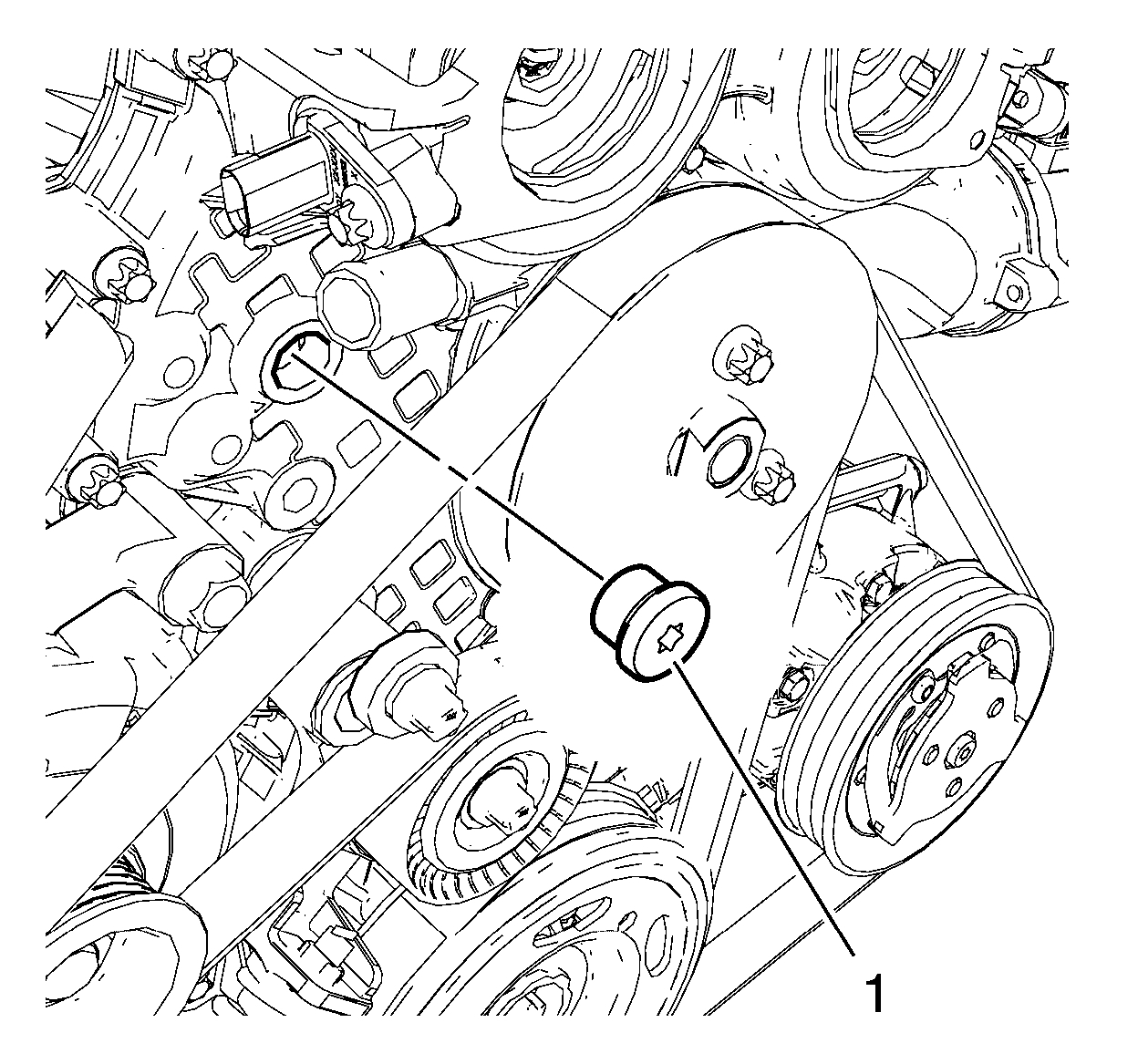

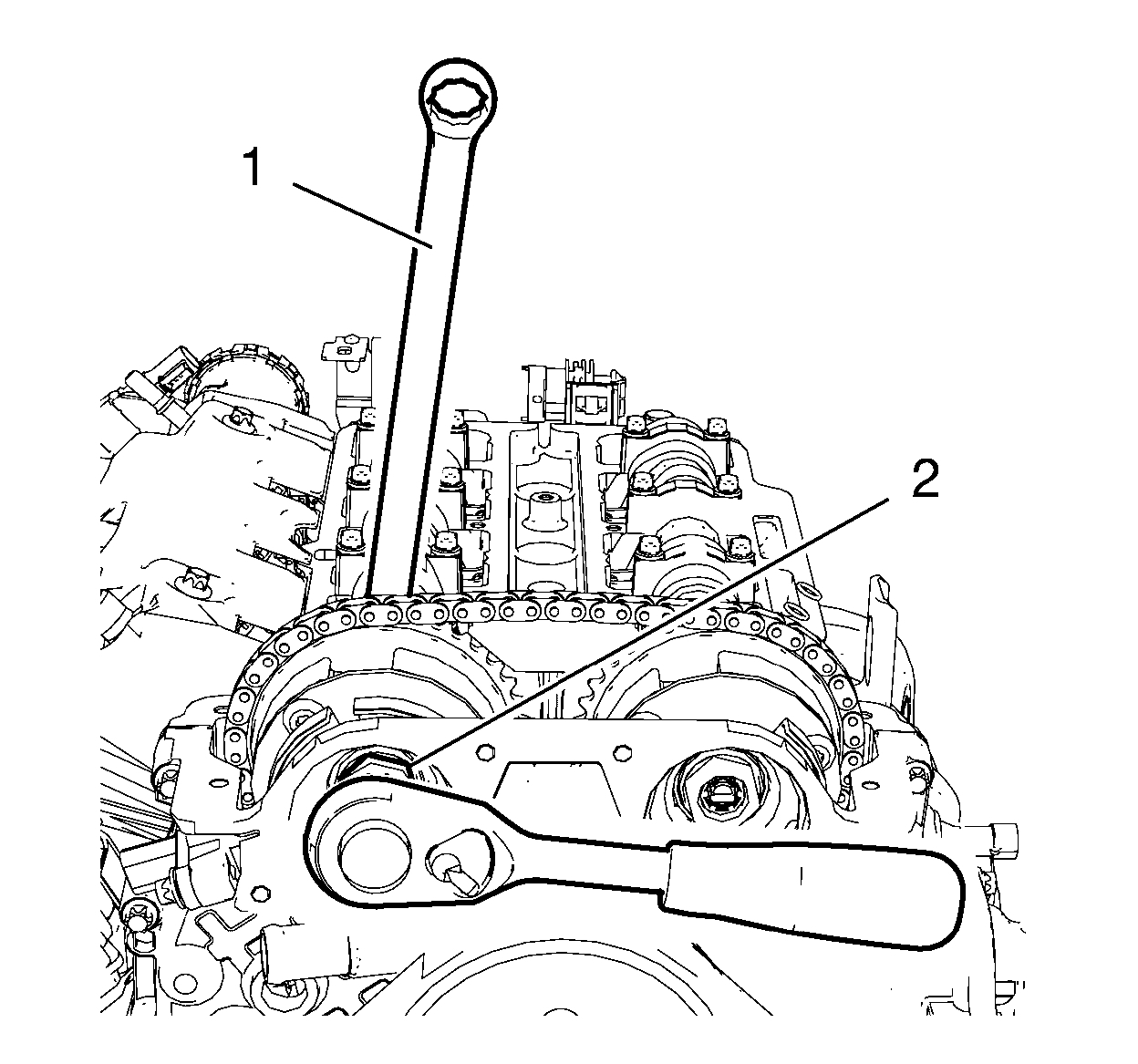

30. Remove the timing chain tensioner plug (1) from the engine front cover.
Note: Remove and reinstall the EN-953-A - fixing tool for this step.

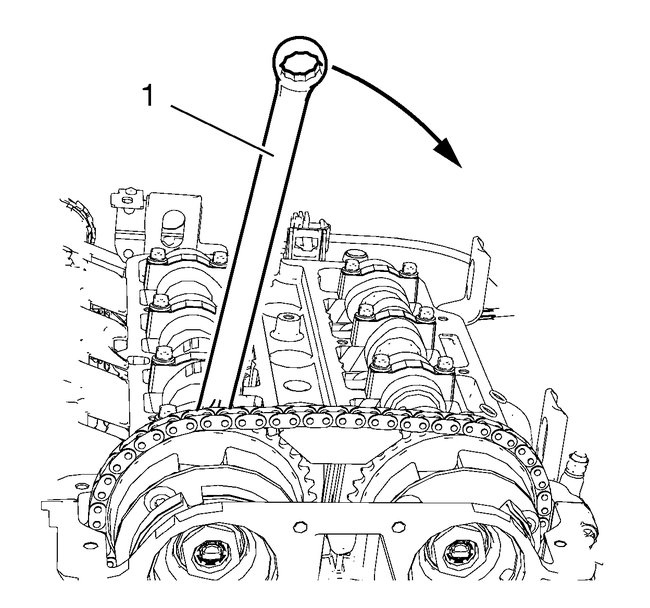

31. Install a wrench (1) to the hexagon of the intake camshaft and rotate it in direction of the arrow to apply tension to the timing chain and hold.
32. Install EN-955-10 - pin (2) to the timing chain tensioner bore (1) to secure it in place.
33. Remove the wrench from the intake camshaft.

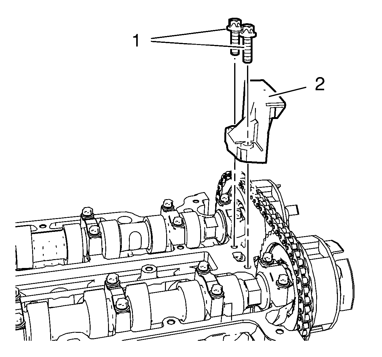

34. Remove 2 upper timing chain guide bolts (1).
35. Remove upper timing chain guide (2).

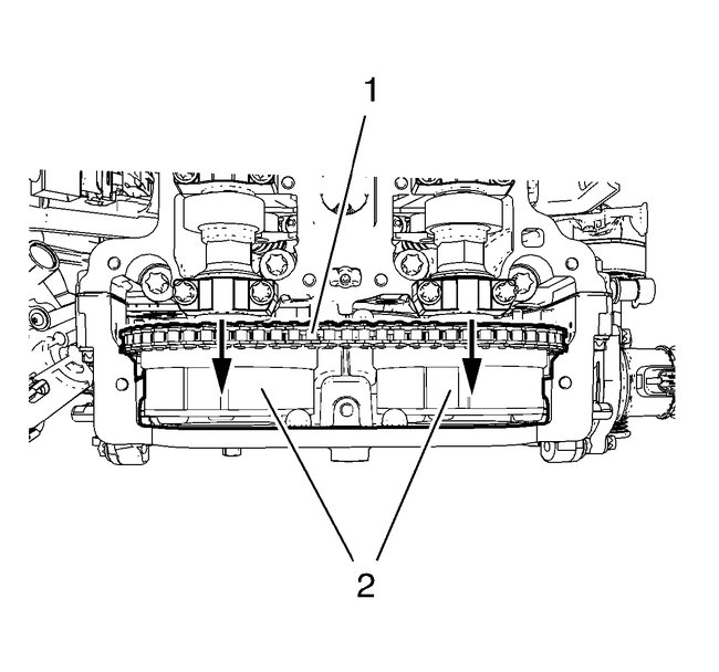

36. Loosen the intake camshaft sprocket bolt (2) while holding the hexagon of intake camshaft sprocket with a wrench (1).
37. Loosen the exhaust camshaft sprocket bolt while holding with a wrench.
38. Remove the 2 camshaft sprocket bolts (2) and the 2 camshaft position exciter wheels (1).
39. Remove the 2 camshaft sprockets (2) along with the timing chain (1) and place it in the engine front cover.

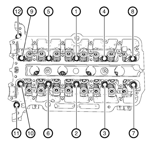

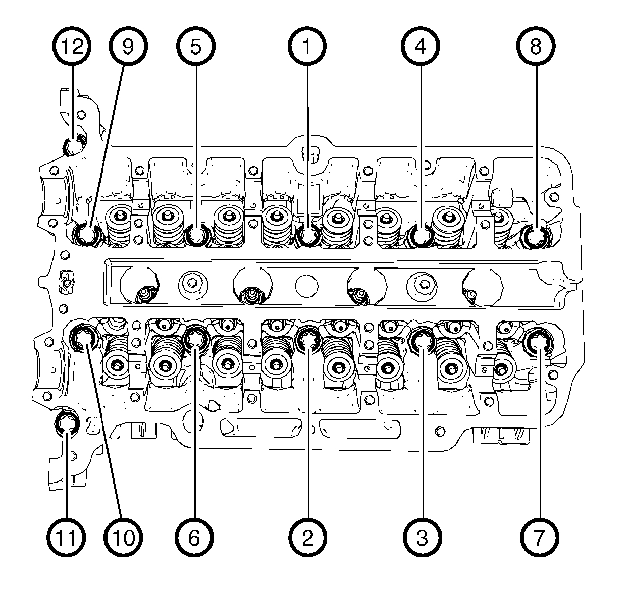

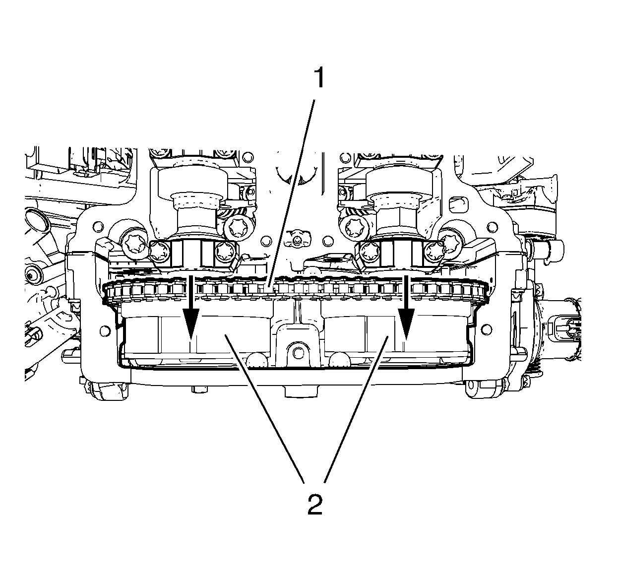

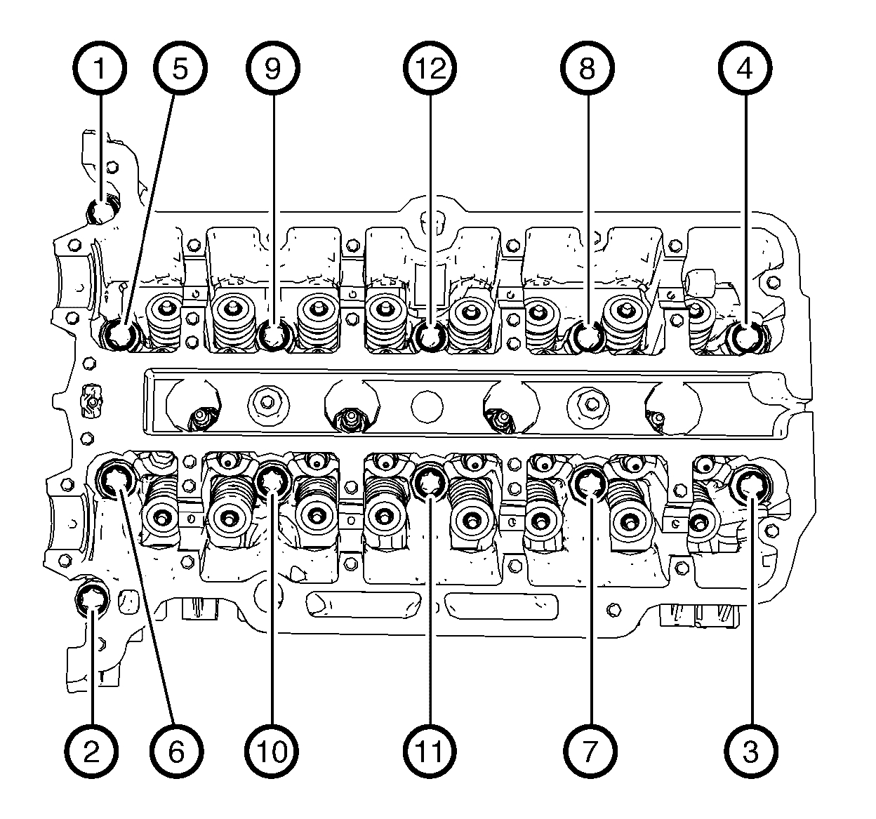

40. Loosen the 12 cylinder head bolts in the sequence as shown. Use the following procedure:
1. Loosen the cylinder head bolts 90 degrees.
2. Loosen the cylinder head bolts 180 degrees.
41. Remove and DISCARD the 12 cylinder head bolts.

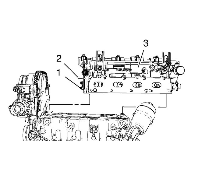

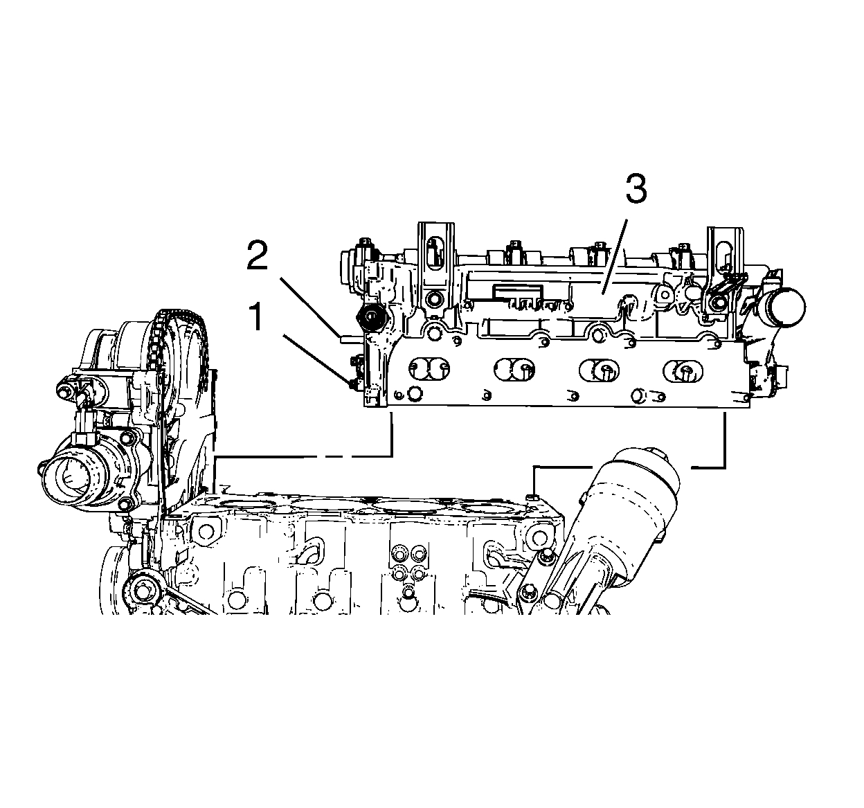

42. Move the cylinder head assembly slightly in direction of the transmission.
Note: Mind the timing chain tensioner and the timing chain guide pin.
Note: A second technician is required.
43. Remove the cylinder head assembly.
44. Remove the cylinder head gasket.

Note: Adjust the camshafts using the hexagon and a wrench.
* Install the EN-953-A - fixing tool.
2. Cut the 2 elastomer sealing lips (1) from engine front cover gasket.
3. Bend down the engine front cover gasket at the predetermined breaking points (arrows).
4. Clean sealing surfaces of engine front cover and engine block from grease and old gasket material.
5. Inspect cylinder block and cylinder head for flatness. Refer to Cylinder Head Cleaning and Inspection See: Engine > Overhaul > Cylinder Head Cleaning and Inspection and Engine Block Cleaning and Inspection See: Engine > Overhaul > Engine Block Cleaning and Inspection.
Note: The thickness of the sealing bead should be 2 mm (0.0787 in).
6. Apply sealing compound to the shown areas (1). Refer to Adhesives, Fluids, Lubricants, and Sealers See: Engine > Fluid Types > Adhesives, Fluids, Lubricants, and Sealers.
Note: Mind the marking on the cylinder head gasket for top side.
7. Install the cylinder head gasket to engine block.
8. Install 2 engine front cover bolts (1) in order to guide the NEW upper engine front cover gasket.
9. Install the NEW upper engine front cover gasket.
10. Apply sealing compound to the shown areas (2). The thickness of the sealing bead should be 2 mm (0.0787 in).
Note: A second technician is required. Guide the timing chain guide pin (2) to the timing chain guide and the timing chain tensioner (1) with the installed fixing pin through the timing chain tensioner plug bore in engine front cover.
11. Install the cylinder head (3).
12. Loosely install 12 NEW cylinder head bolts.
13. Adjust the cylinder head to the engine front cover. Use a rubber mallet.
14. Locate the engine front cover to cylinder head by installing 3 bolts (1).
15. Tighten the 3 bolts (1) to 8 Nm (71 lb in).
Caution: Refer to Torque-to-Yield Fastener Caution See: Timing Components > Technician Safety Information > Torque-to-Yield Fastener Caution.

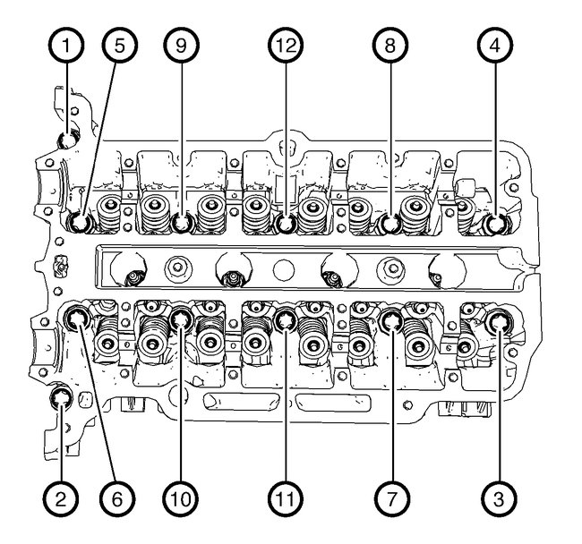

16. Tighten the cylinder head bolts in the sequence as shown and in the following order:
1. Tighten the cylinder head bolts a first pass to 35 Nm (26 lb ft).
2. Tighten the cylinder head bolts a final pass to an additional 180 degrees, using EN-470-B - wrench.
17. Loosen the 3 bolts from engine front cover.
18. Install the 5 remaining bolts to engine front cover and water pump.
19. Tighten the 5 engine front cover bolts (1, 2) to 8 Nm (71 lb in).
20. Tighten the 3 water pump bolts (3) to 8 Nm (71 lb in).

26. Install the 2 camshaft sprockets (2) along with the timing chain (1).
Note: Camshaft position exciter wheels should stay rotatable.
27. Install the 2 camshaft position exciter wheels (1) and the 2 camshaft sprocket bolts (2).
28. Adjust engine to TDC and tighten the camshaft sprockets and install upper timing chain tensioner guide. Refer to Camshaft Timing Chain Adjustment See: Engine > Overhaul > Camshaft Timing Chain Adjustment.
29. Rotate the crankshaft for 720° and check the engine timing again. Repeat the adjustment procedure if necessary.
30. Remove all special tools for timing chain adjustment. Refer to Camshaft Timing Chain Adjustment See: Engine > Overhaul > Camshaft Timing Chain Adjustment.
31. Install the timing chain tensioner plug and tighten to 35 Nm (26 lb ft).

35. Connect radiator outlet hose (3) to engine coolant thermostat housing (1). Clip quick connector (2).
36. Install the ground cable (1) and the ground cable bolt (2) and tighten to 20 Nm (15 lb ft).
37. Install the radiator inlet hose (4) and the radiator inlet hose clamp to the water outlet.
38. Install the oil cooler inlet hose (1) and the oil cooler inlet hose clamp to the water outlet.

42. Install the engine control module wiring harness to the camshaft cover:
* Connect the engine coolant temperature sensor wiring harness plug (3).
* Connect the exhaust camshaft position actuator solenoid valve wiring harness plug (5).
* Connect the exhaust camshaft position sensor wiring harness plug (4).
* Connect the intake camshaft position actuator solenoid valve wiring harness plug (6).
* Connect the intake camshaft position sensor wiring harness plug (7).
