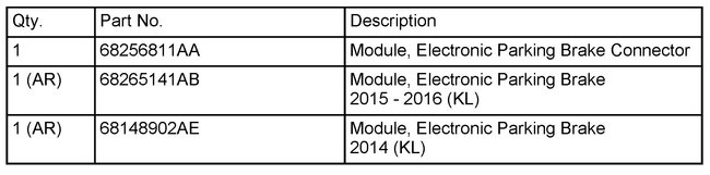

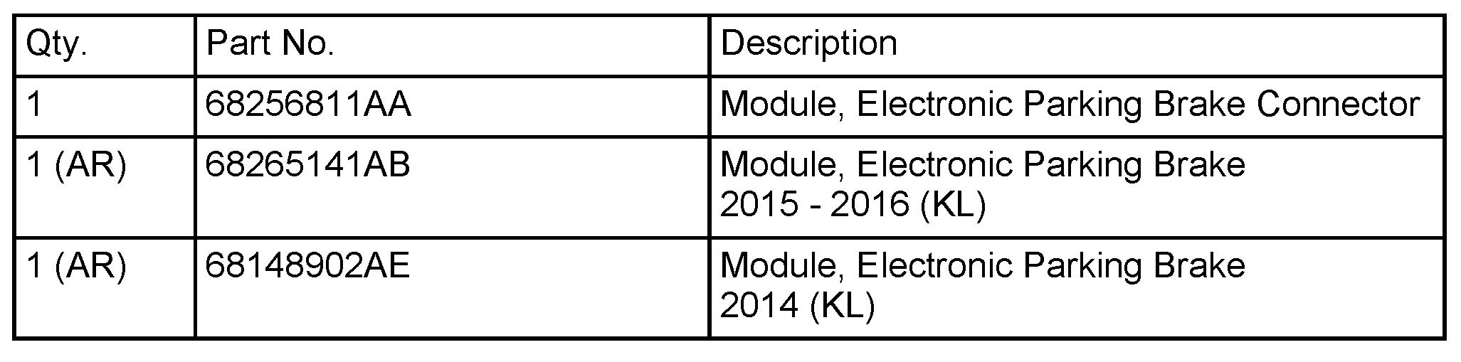

PARTS REQUIRED:
REPAIR PROCEDURE:

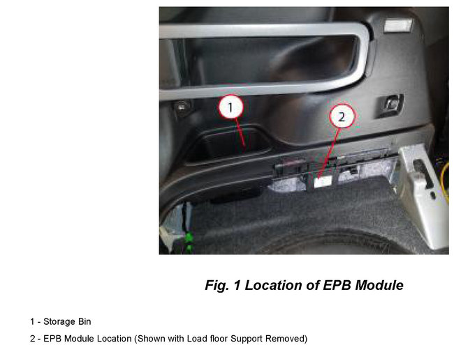

1.The Electronic Parking Brake (EPB) module is located in the back left side of the cargo area interior, near the spare tire (Fig. 1) and is attached by a slide locking retainer and fastener.
2.Remove EPB module hold down nut.

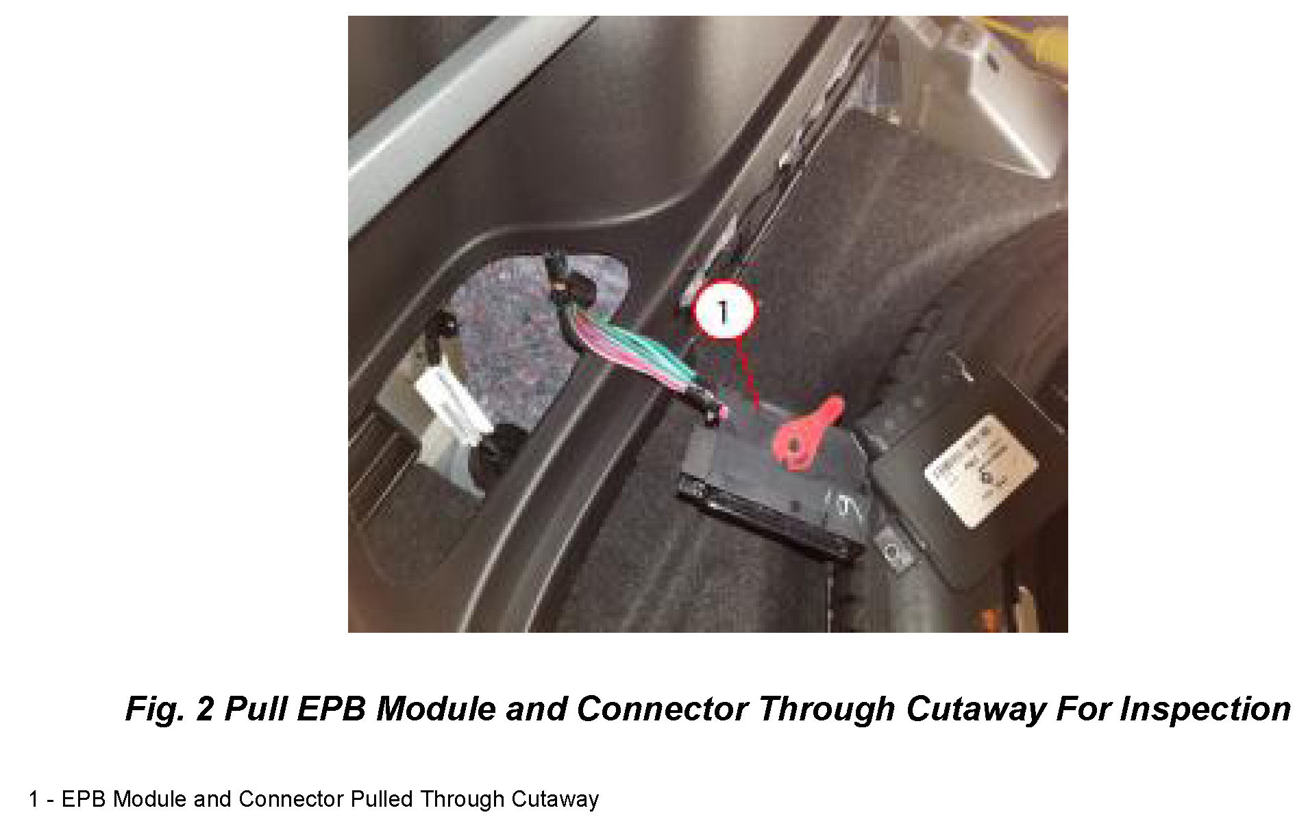

3.Remove the storage bin and pull EPB Module and connector through opening (Fig. 2).

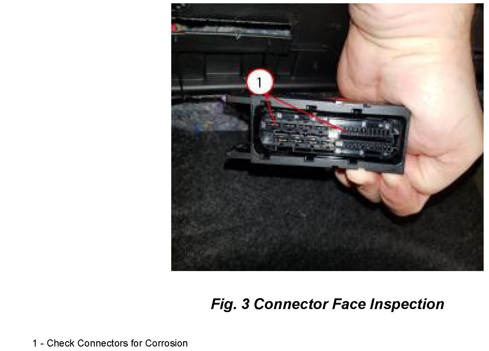

4.Remove the connector and inspect for terminal corrosion (Fig. 3).
5.Is there evidence of corrosion on the terminal(s)?
a. YES >>> Proceed to Step # 6.
b. NO >>> This Bulletin does not apply. Normal diagnosis should be performed.

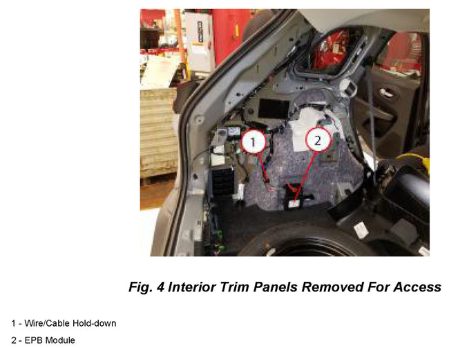

6.Remove interior trim panels to allow access to the harness for EPB connector pigtail replacement (Fig. 4).
7.Replace EPB Module and connector.
