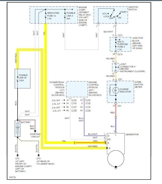

I just installed an underdrive pulley on my car listed above ralliart 2.4l,works beautiful for a day. now, the first turn of key to start car just clicks (like a drained battery) back it off and 2nd turn starts it no problem. Now Service engine light is on for the first time in cars lifetime. Battery stores 12.75 volts, 13.45 volts while running, leading me to believe it is not the alternator or battery. Help us appreciated.

The charge rate is low on the alternator. It should be 14 to 14.5 volts. Make sure the belt is tight.
https://www.2carpros.com/articles/how-to-replace-an-alternator

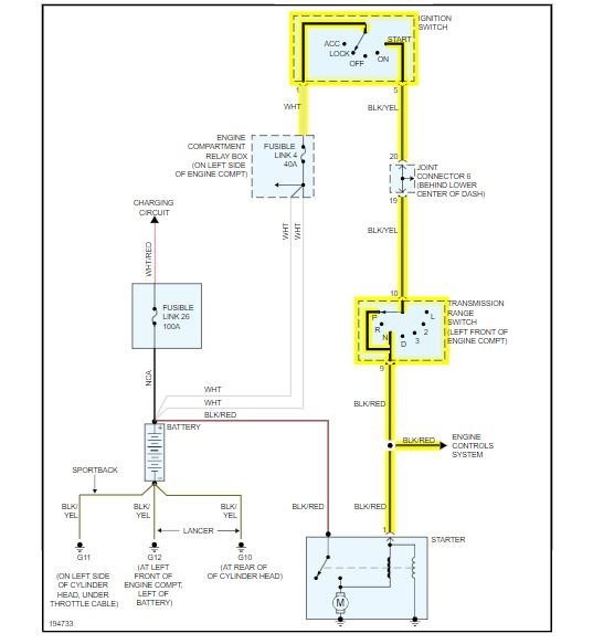

I attached a diagram for both the alternator and the starter. Check the voltage at the starter solenoid when you first try and start.

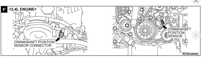

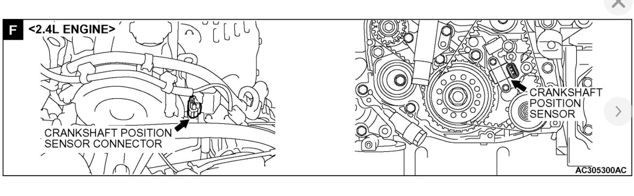

I hooked up an OBD, and got a code "crank position sensor" which is weird because all I did was change out the lower belt pulley and installed new belt. Never removed timing cover, never touched sensor. I cleared the code and now it starts fine, I will find out tomorrow morning when I commute to work if it is indeed fixed.
Jan 25, 2021 at 11:28 AM
Okay, if you still have the issue, send me the code number so I can help.
https://www.2carpros.com/articles/how-a-crank-shaft-angle-sensor-works
