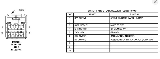

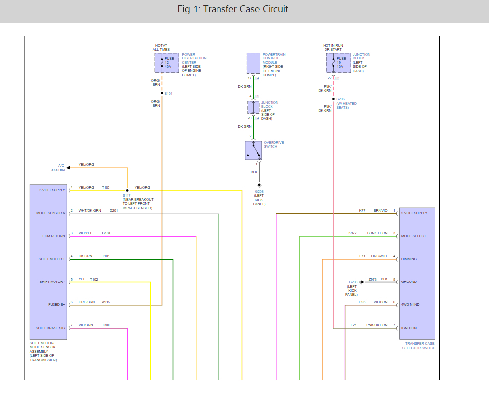

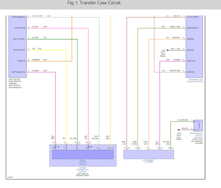

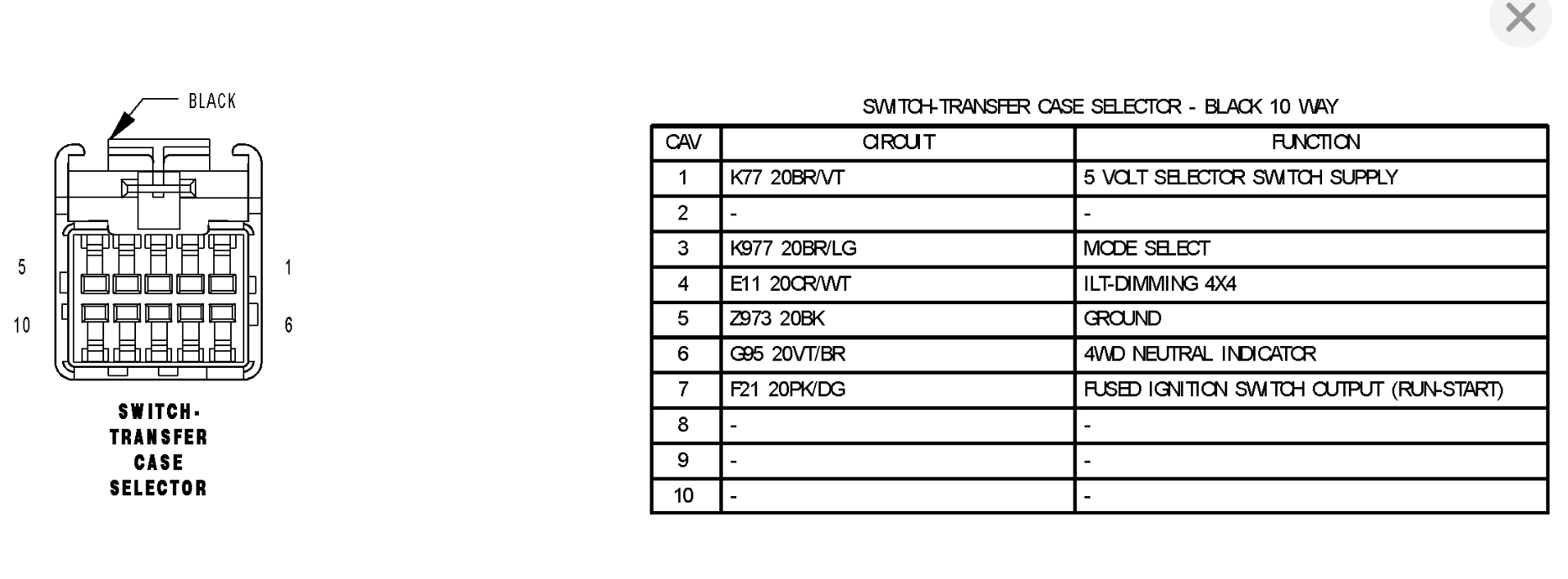

I just replaced the shift motor however you cannot shift between the modes now. Could this be the switch or something worse? Can you still drive the SUV with this light on?
Sep 17, 2022 at 7:20 AM
  • 55,433 POSTS
Yes, you can drive it with the light on, it just means the 4wd operation is not working. There are two fuses to check # 12 in the under-hood fuse panel and # 19 in the fuse panel under the dash on the left side. If they are okay it sounds like the switch has gone bad, here are the transfer case wiring diagrams so you can see how the system works. Also, you can do a CAN scan which will go over the entire truck, which is easy to do, you can get a CAN scanner (Controller Area Network) from Amazon for about $36.00.
