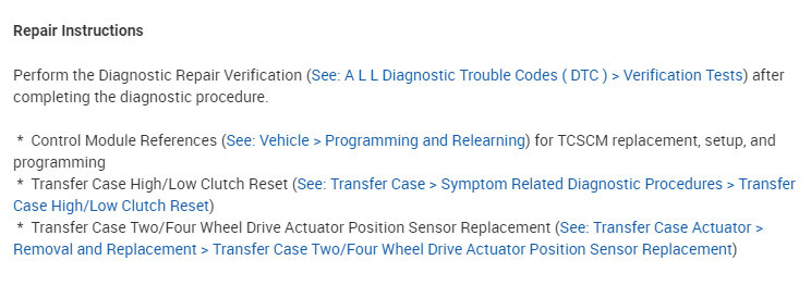

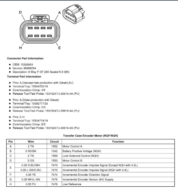

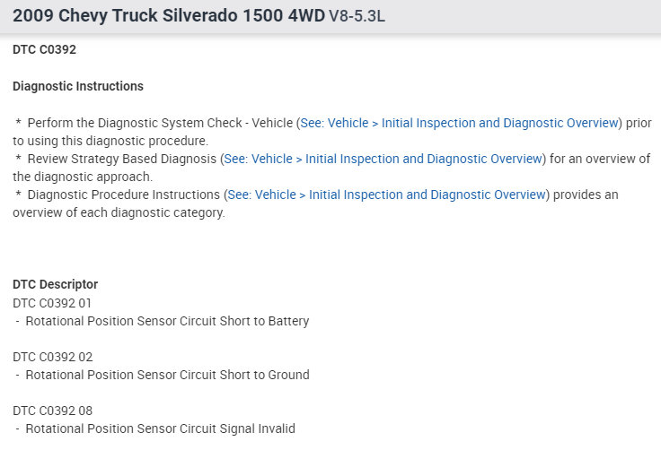

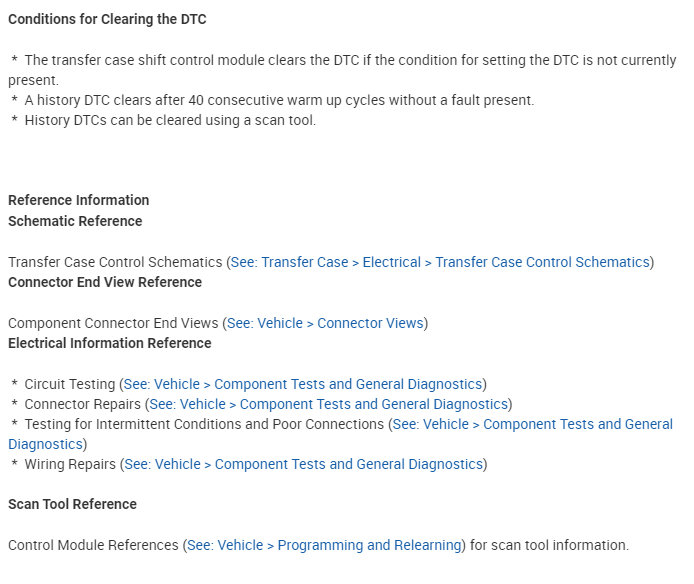

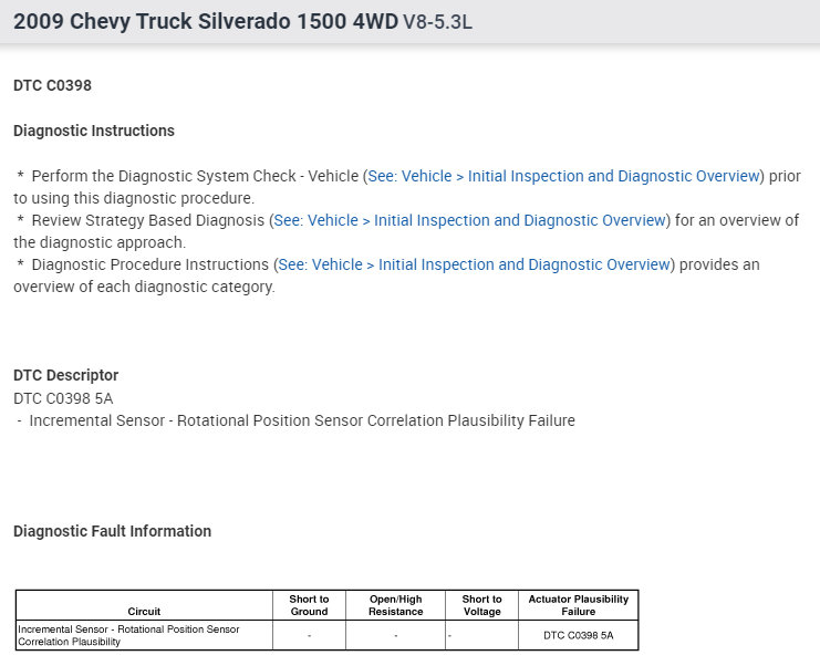

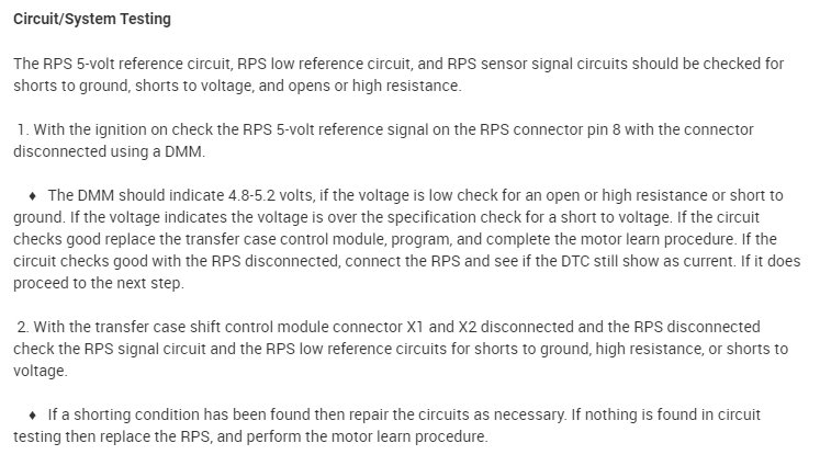

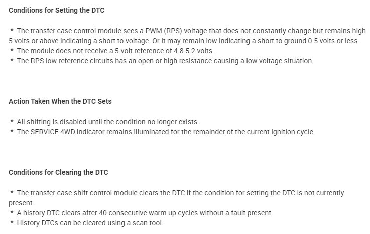

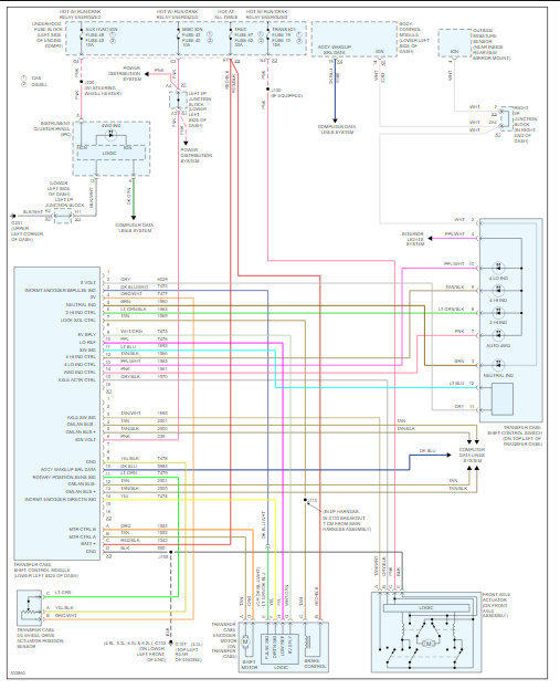

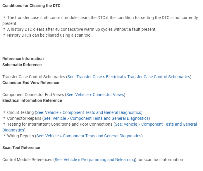

I'm having codes C0392 and c0398 I've changed the rps and it's still says service 4 wheel drive. I have also checked the wiring and from what I can tell their are no shorts and all connections are good. would really like a diagram for this.
Oct 8, 2019 at 10:48 AM
DANNY L
  • 5,648 POSTS
Hello, I'm Danny.
Here is a tutorial for you to view on how to test wiring:

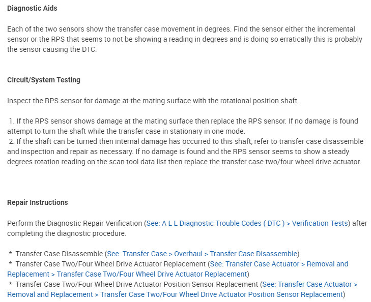

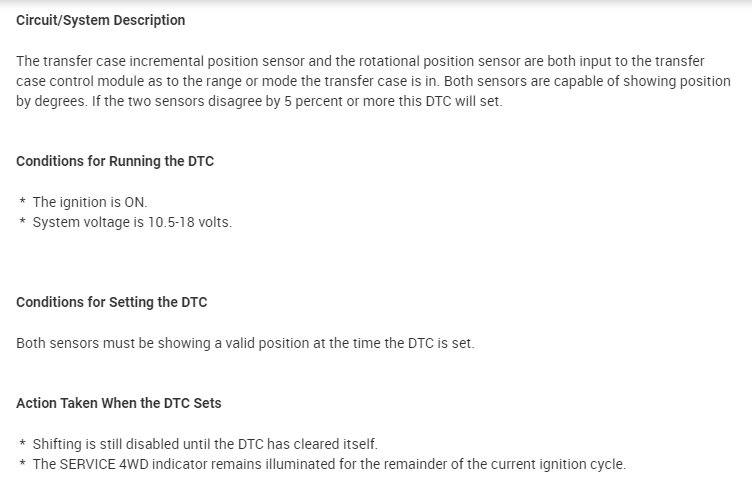

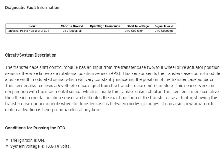

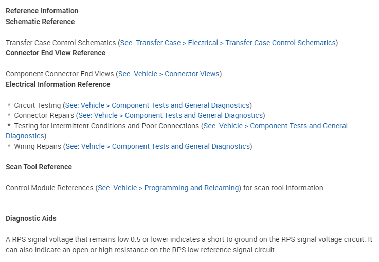

I've attached step-by-step instructions below on how to test/diagnose those 2 codes. The last few pictures is of the wiring diagram you requested. Hope this helps and thanks for using 2CarPros.
