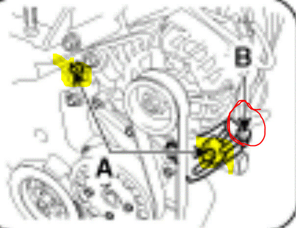

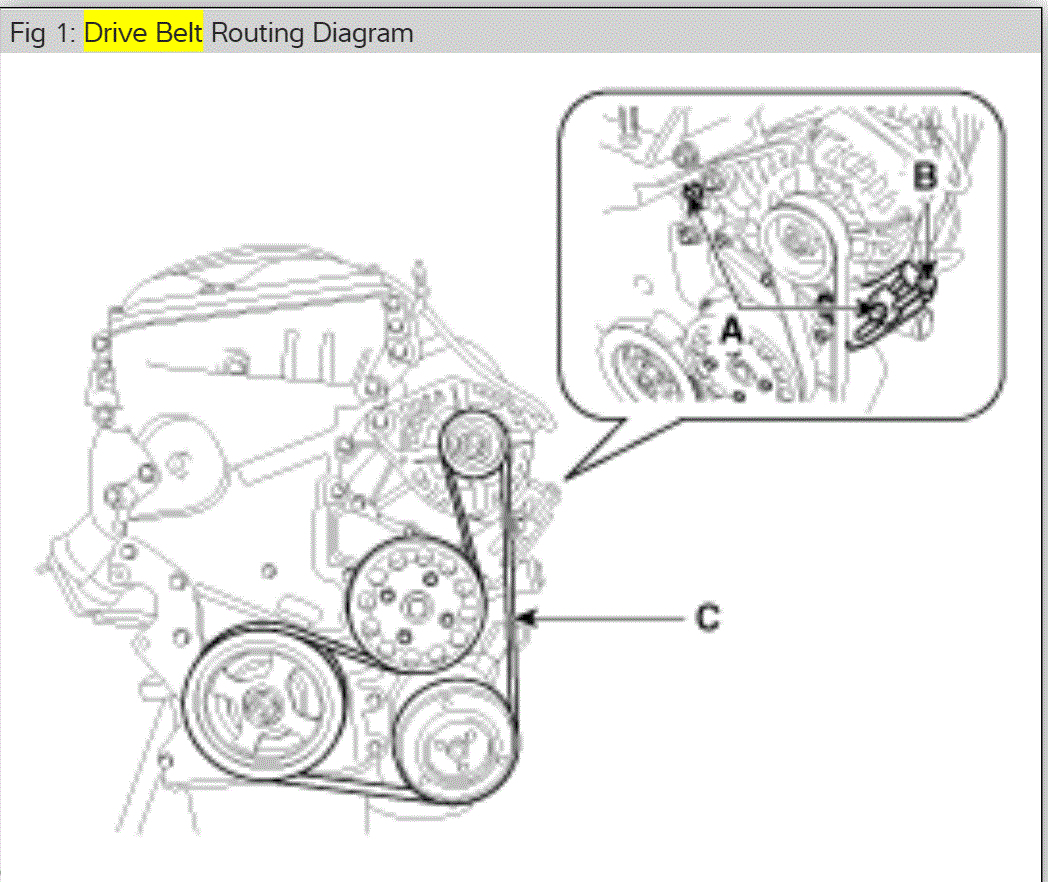

Need diagram for the car listed above.

As far as the diagram, I attached it below (see pic 1). Here is a link that explains in general how one is replaced:
Your vehicle doesn't have an automatic tensioner. If you look at pic 2, I highlighted two bolts that will need to be loosened. Then, I circled in red the adjustment bolt. Loosen or tighten the circled adjuster for proper tension.
See pic below.
