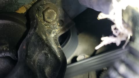

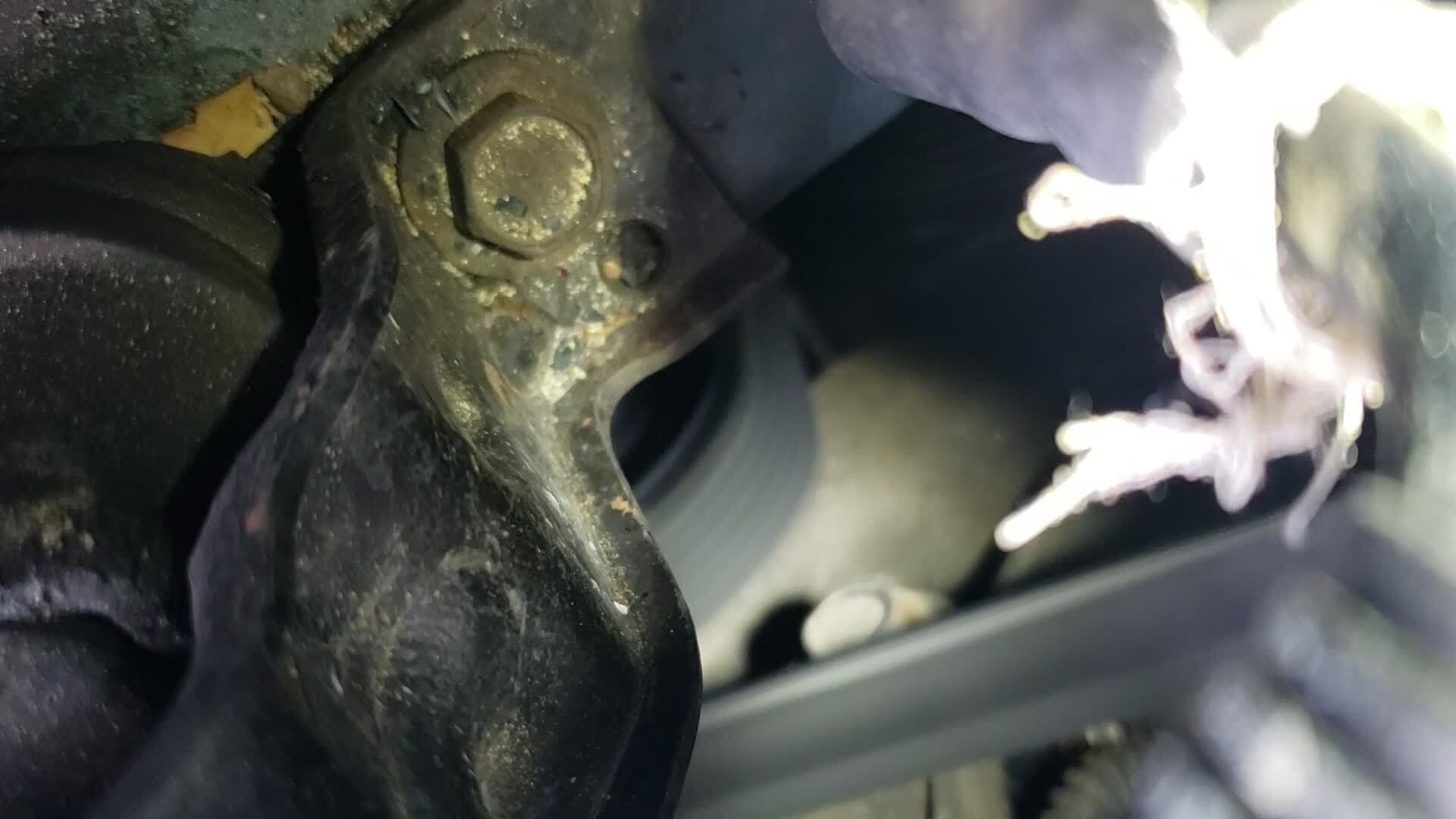

DRAKO2774
The belt is brand new, as is the water pump.
I am at a loss tensioner is mounted correctly I triple checked that when I saw the tab on the back. I have a short video I am uploading start with vol. Down it's kind of loud.

Thank you for the dandy video. It appears one of the items run by the belt has bad bearings on its shaft. You can see that by the way the belt is moving back and forth near the bottom of the picture. That is also causing the knocking noise.
I would remove the belt from one of the pulleys to release its tension, then rotate and wiggle each pulley to find the one with excessive movement. Let me know if that pans out.
