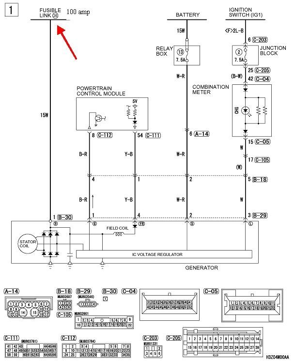

My husband learned everything from his dad who was a certified mechanic for thirty five years.We got a 180 amp alternator, upgrade, but it has a smaller pulley. So my husband said it is actually 90. Being overclocked because of smaller pulley.So when he put back on serpentine belt it was half inch too big because of smaller pulley.So he ran it different way to make it fit. So obviously it is braking and now I need to buy new serpentine belt. But my husband said it wont fit and I need to find one half inch smaller.This seems stupid to me. Or is this normal? I do not know. Any input would be greatly appreciated!

The bottom line is if you have a 90-amp generator, there is no possible way it will ever develop more than 90 amps. If you still need to use it on your engine, the people at the auto parts stores have listings for all the different belt lengths, widths, and number of ribs. They can look up the original belt to find its length, then they should be able to find one the next size shorter for you.
There is one potential hazard you should be aware of that mechanics might be unfairly blamed for. The only time an AC generator will ever develop the maximum current it was designed for is during the "full-load output current" test that is part of the standard charging system test. That test only lasts a few seconds but it can be long enough to blow the fuse or fuse link wire that is always in this circuit. The tester puts a very heavy load on the battery, and engine speed is increased to get the generator spinning at its most efficient speed. The voltage regulator sees the drop in system voltage, so it increases field current to get the output voltage back up to where it should be. It has to increase output current to do that, and that is the only time the generator will be running wide-open.
The standard generator for your vehicle is, in fact, a 90-amp generator. The fuse link is always selected at the factory based on the generator's rating, and for yours that is a 100-amp bolted-in fuse. That fuse will survive any system testing, . . . until you install a generator with a higher maximum output capacity. If you could actually find a 180-amp generator, and the full-load output current test is performed, close to 180 amps will be developed, and that will blow the 100-amp fuse. Before the mid 1990s, that fuse was a special fuse link wire spliced into the wiring harness and was usually not easily accessible or easily replaceable.
When multiple optional generator sizes were available during assembly at the factory, the output wire going back to the battery was always fat enough to handle the maximum current from the largest available generator, then, all they had to do was install the proper-size fuse or fuse link wire to match that generator. Your vehicle was available with an optional 110-amp generator. When those were installed, the fuse likely would have been a 120-amp or 125-amp fuse.
Wire # 15W in this diagram is of a large enough gauge to handle 110 amps intermittently, so it will also be fine with a 90-amp generator. It will not handle 180 amps. If you were to replace the 100-amp fuse with a 200-amp fuse, that will not protect that wire 15W.
