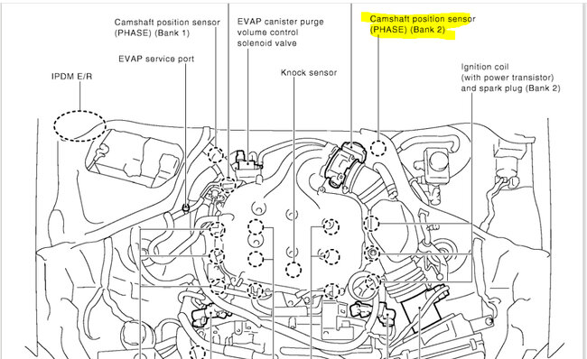

If that is the only code, there is only one sensor that is needed. Keep in mind, I've never heard that type of noise from a cam sensor, but anything is possible.
As far as the sensor is concerned, it will be on the rear of the cylinder head on the driver's side. Pic 1 below shows an approximate location.

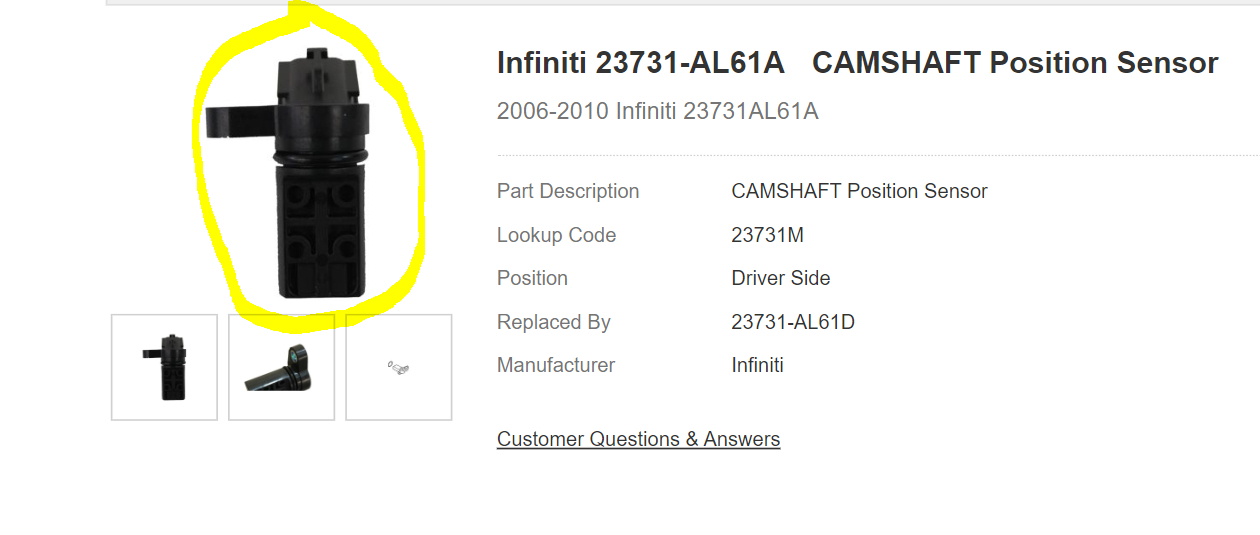

Next, there is a difference between the left and right-side cam sensors. The one you need is part number 23731AL61A. That is the OEM part number, so if you get an aftermarket one, it may be different. Just remember you need the one for the left, bank 2.

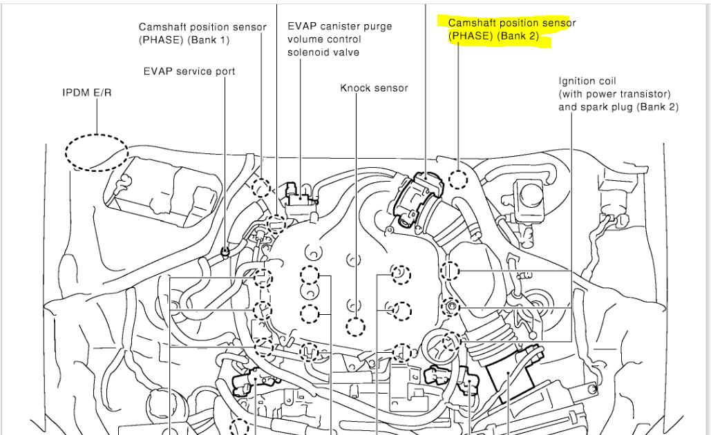

Pic 2 below provides a picture of the sensor you are looking for. There is one bolt that holds it in place. When you remove it, take your time and if the bolt is extremely tight, work it back and forth. You don't want it to break off.
