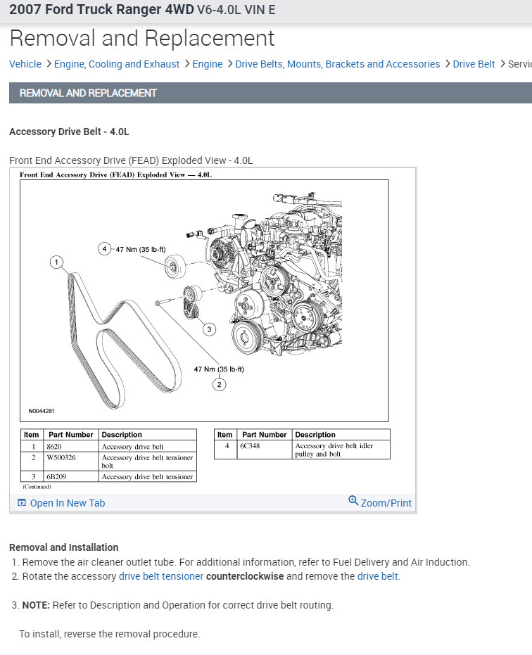

I need a serpentine belt diagram for the above truck without air. Thank you

Given these trucks had A/C from the factory, the manual does not provide any diagram for the belt without air.
I have attached the belt diagram with A/C. You can use that as a reference to route the belt without the A/C.
Let me know of any questions.
