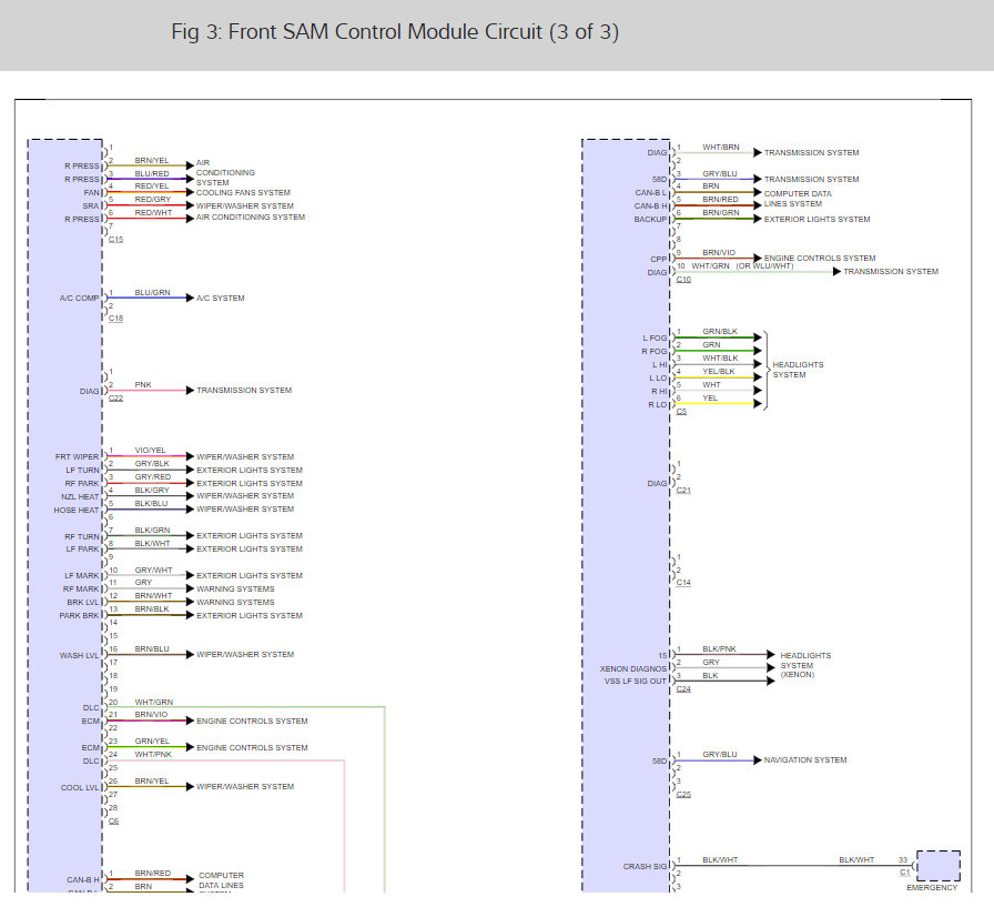

When ever the headlights turn on the dashboard comes up with check coolant level and windshield level. Also, the outside temperature goes to 185F to 44F back and forth. But when the headlights are not turned on it is fine.
Jan 19, 2018 at 7:43 AM
  • 55,381 POSTS

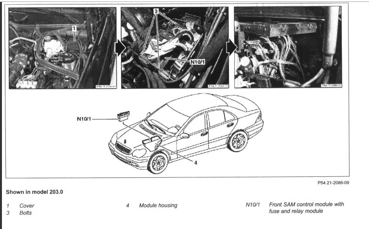

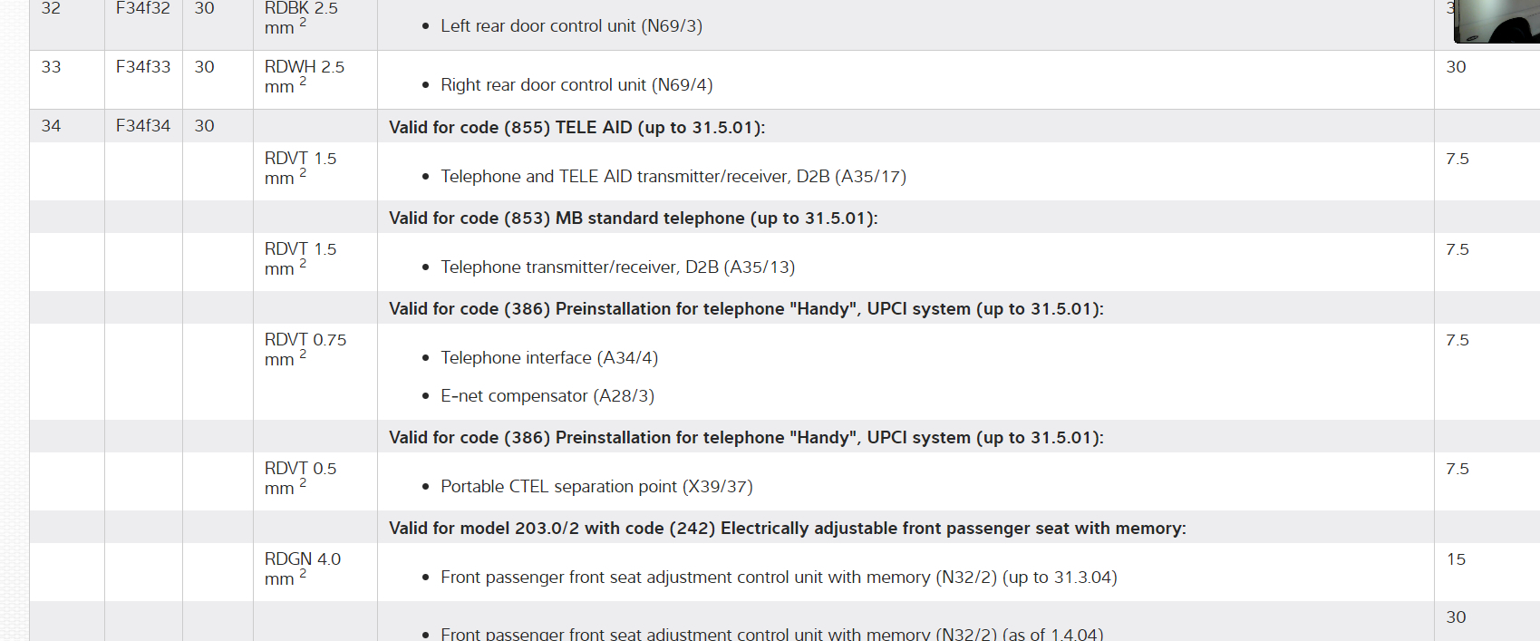

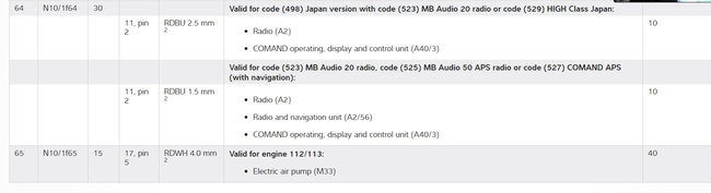

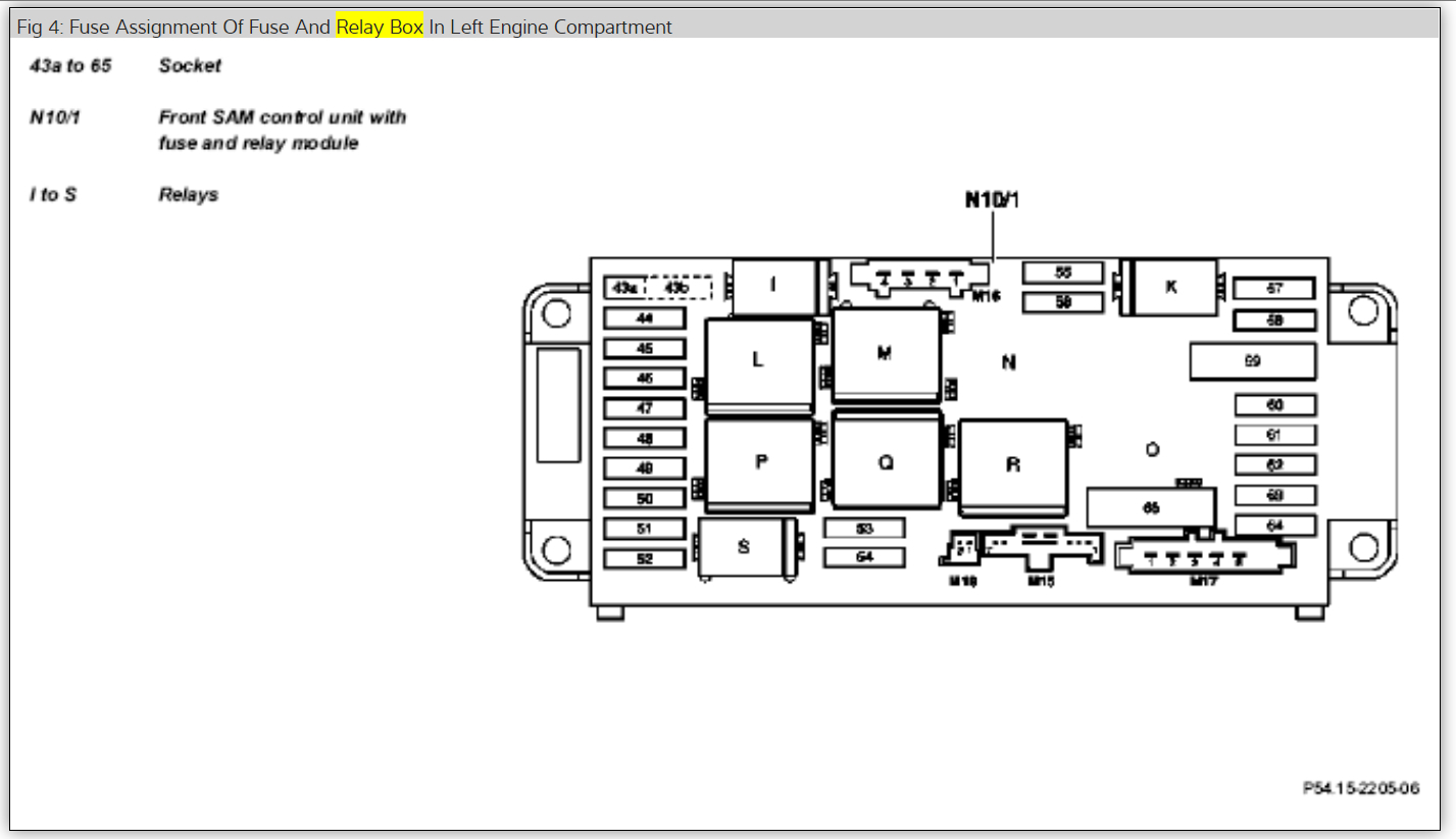

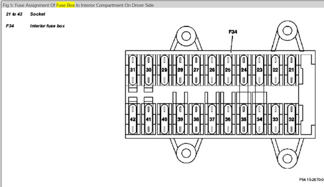

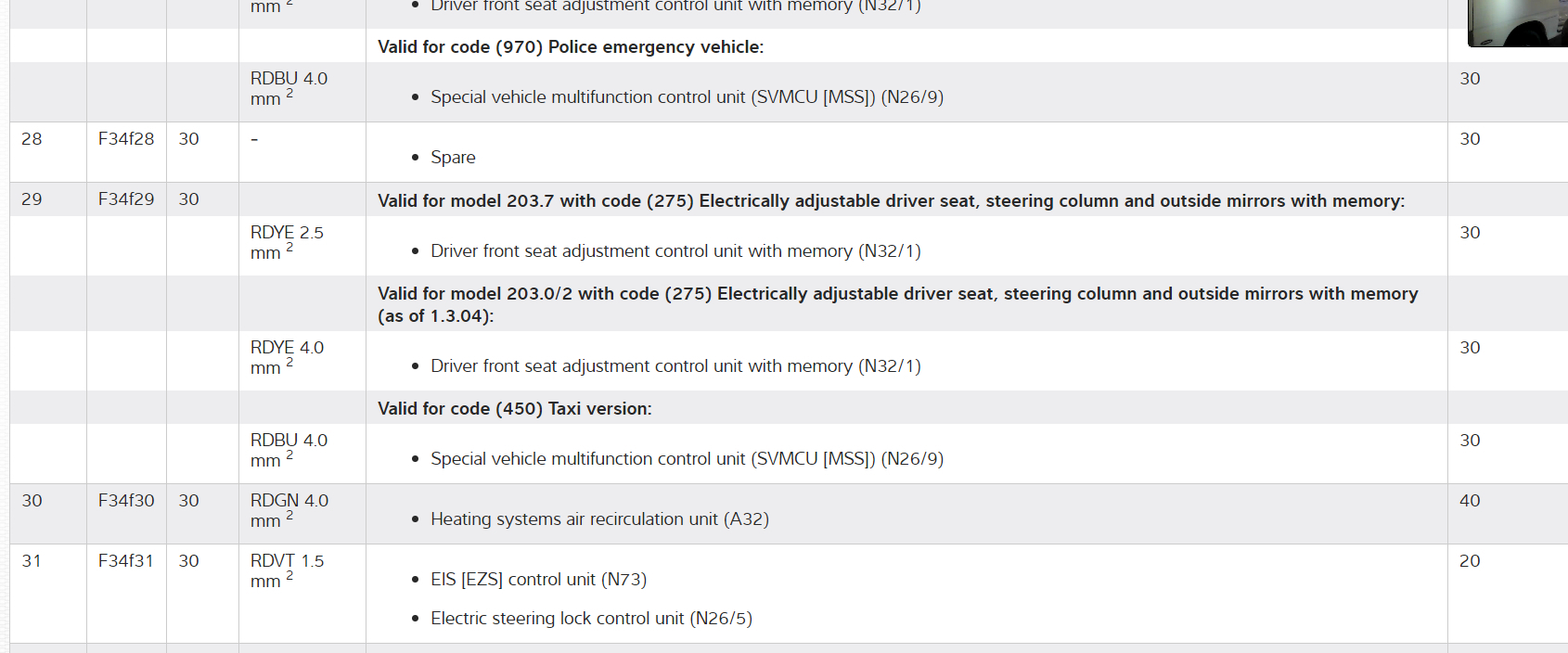

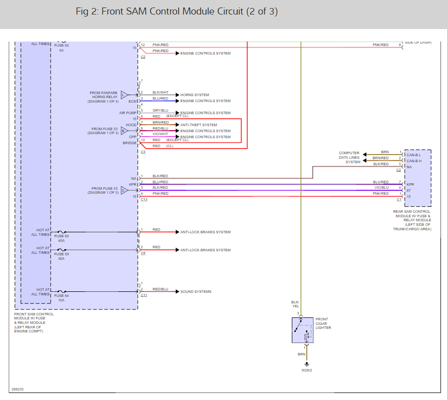

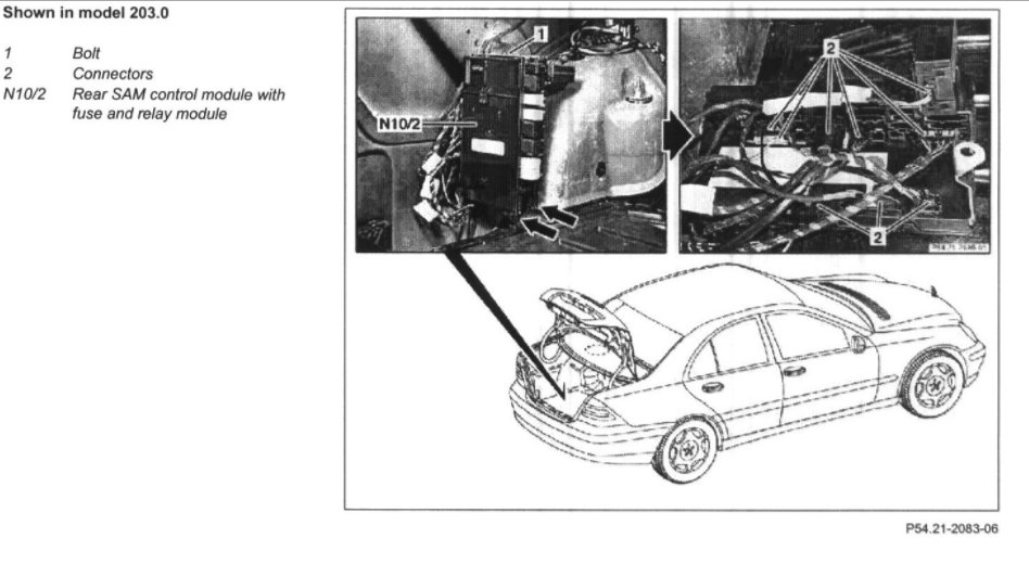

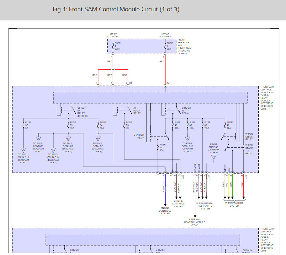

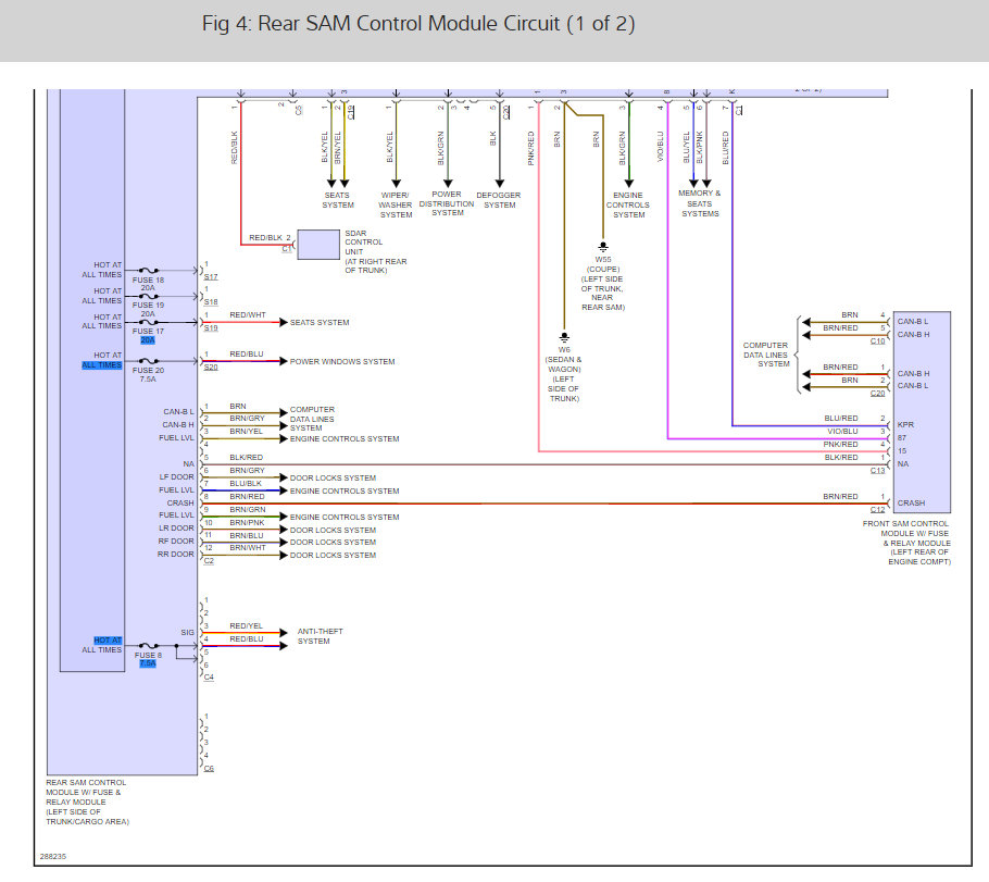

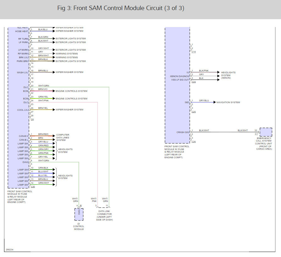

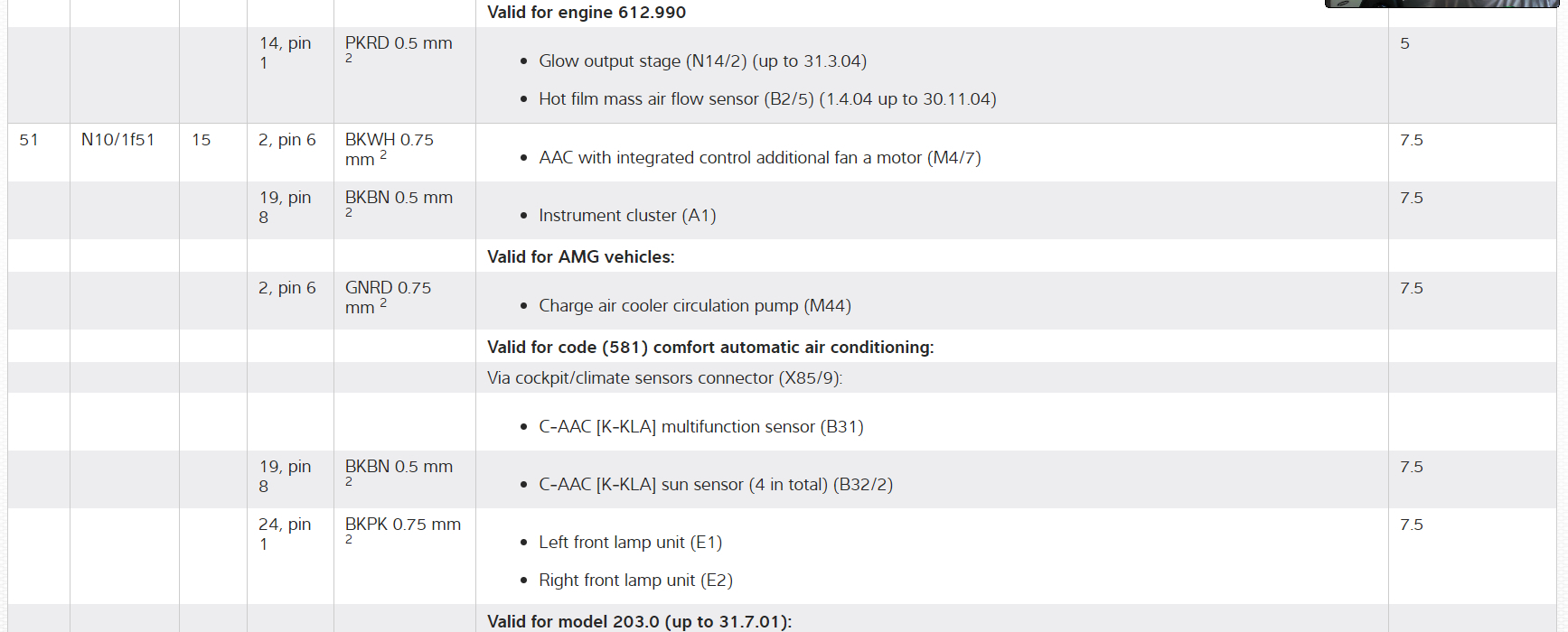

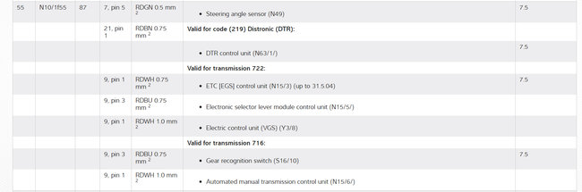

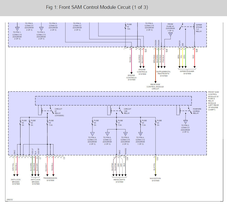

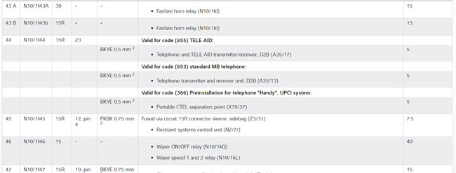

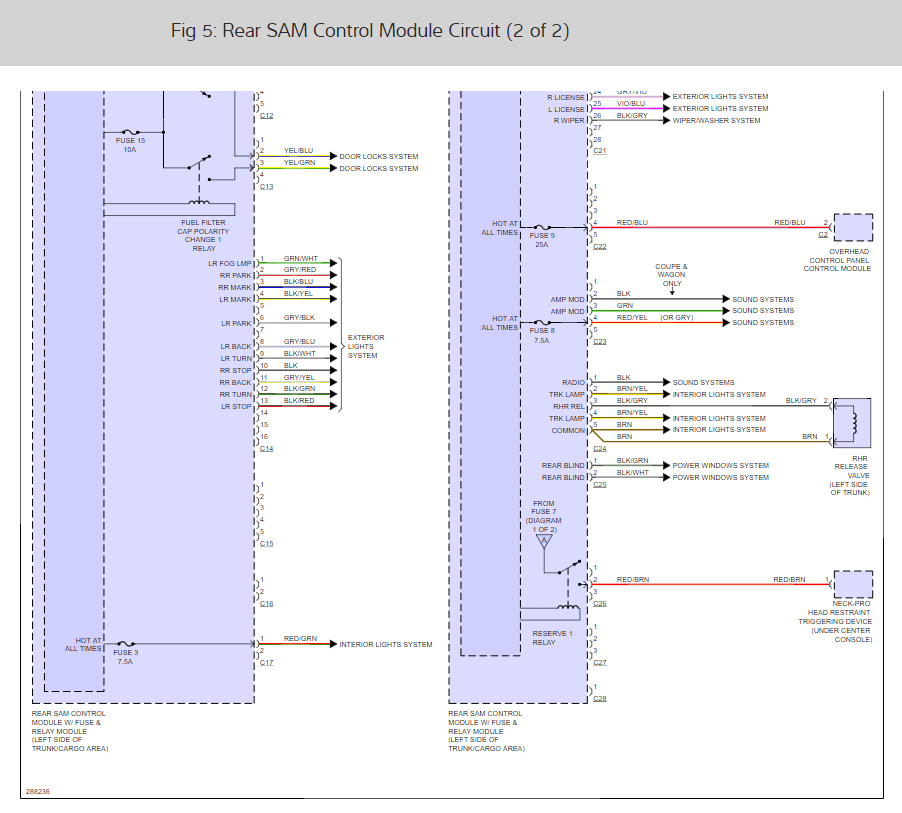

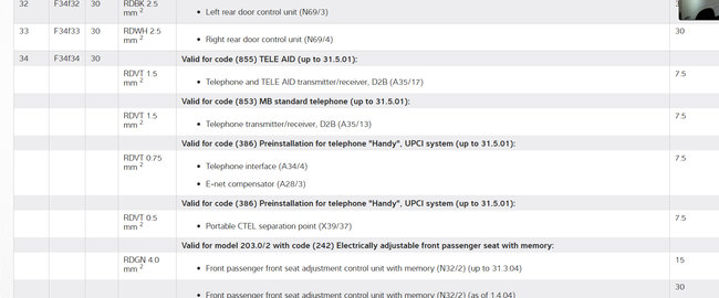

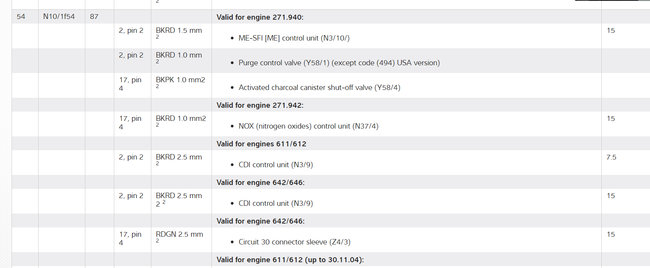

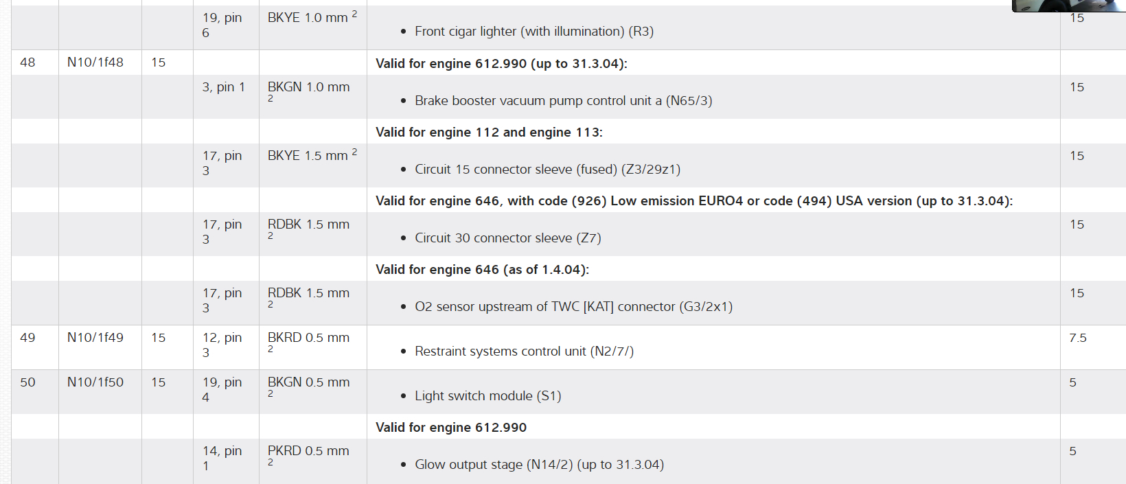

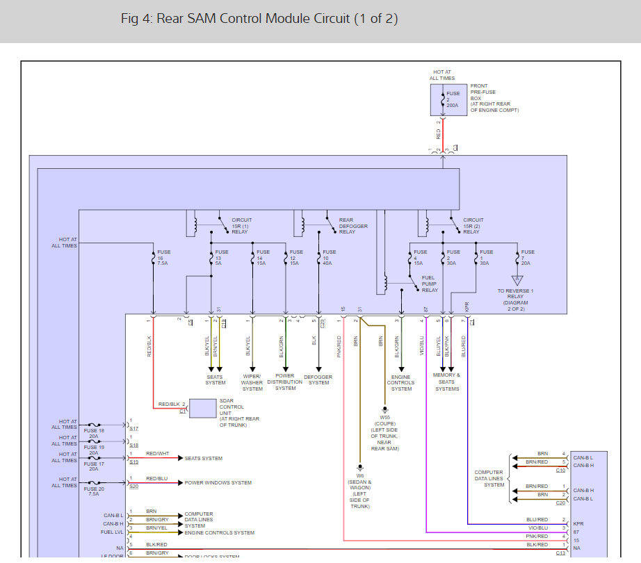

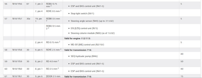

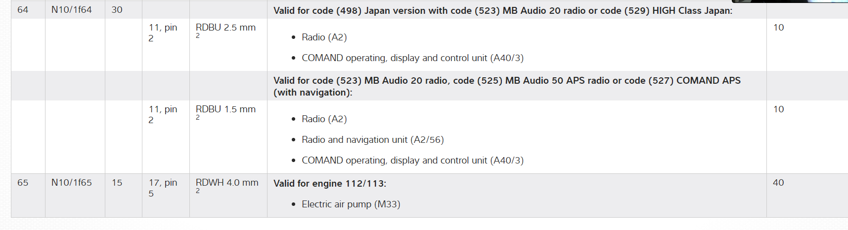

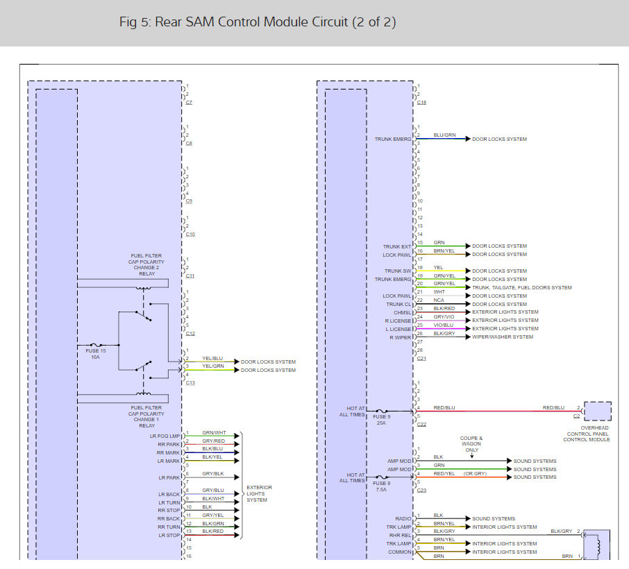

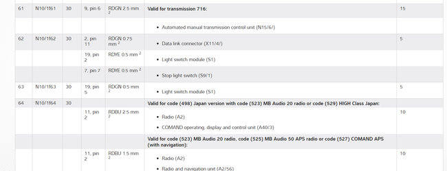

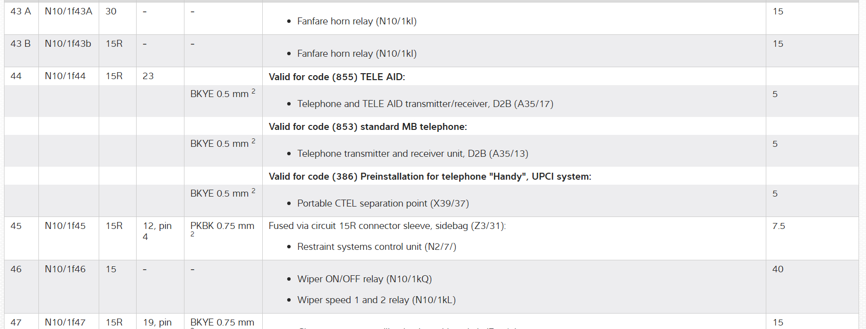

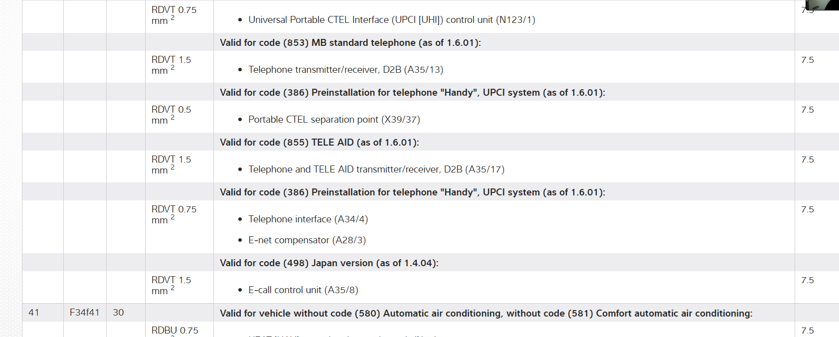

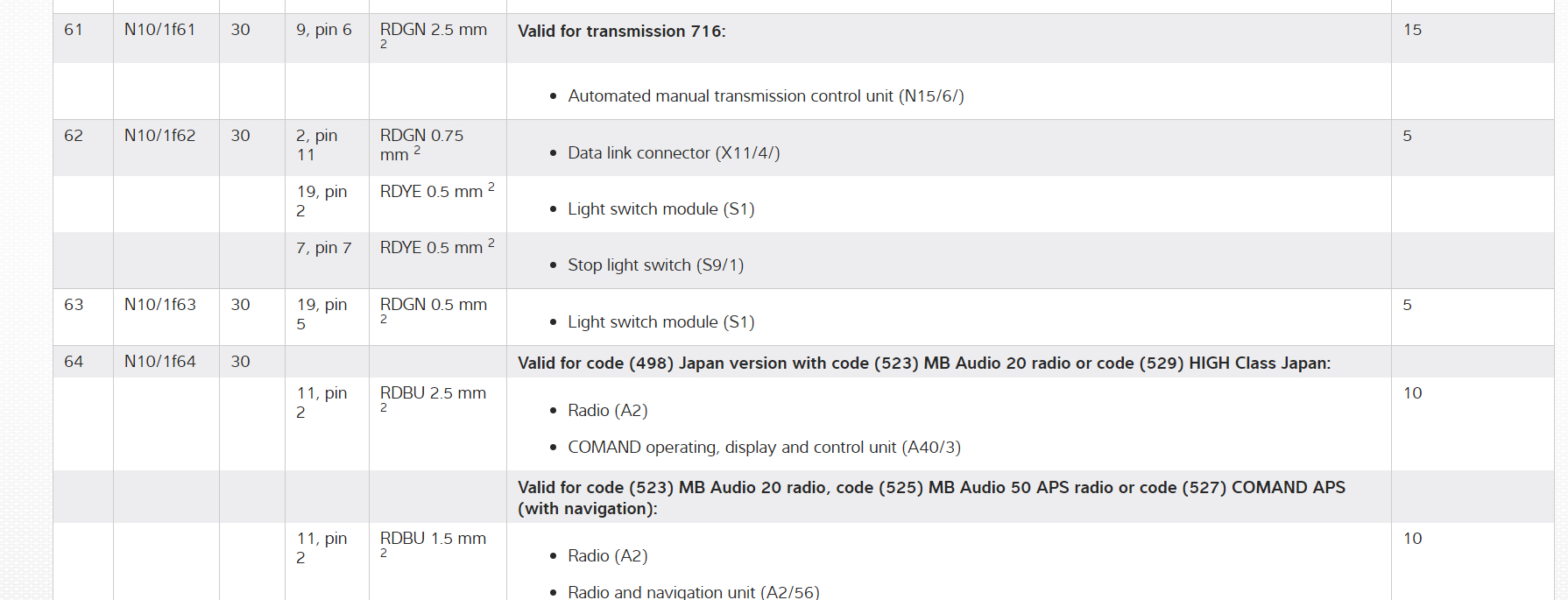

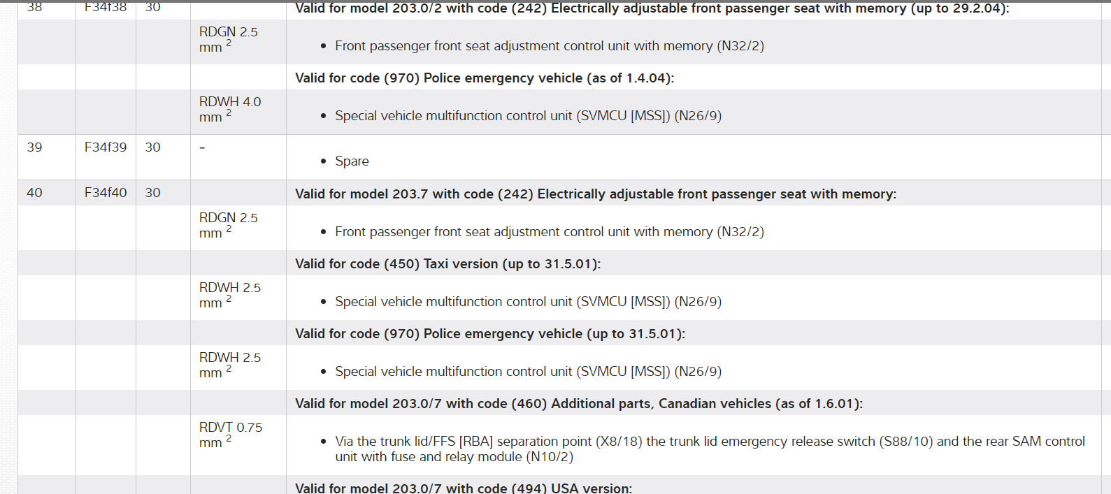

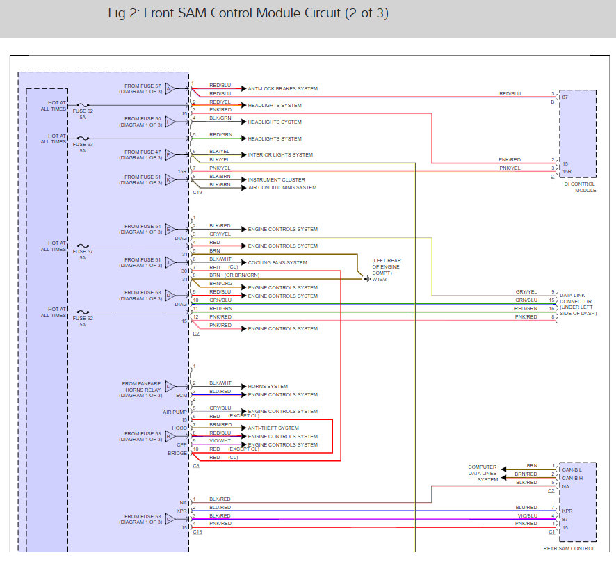

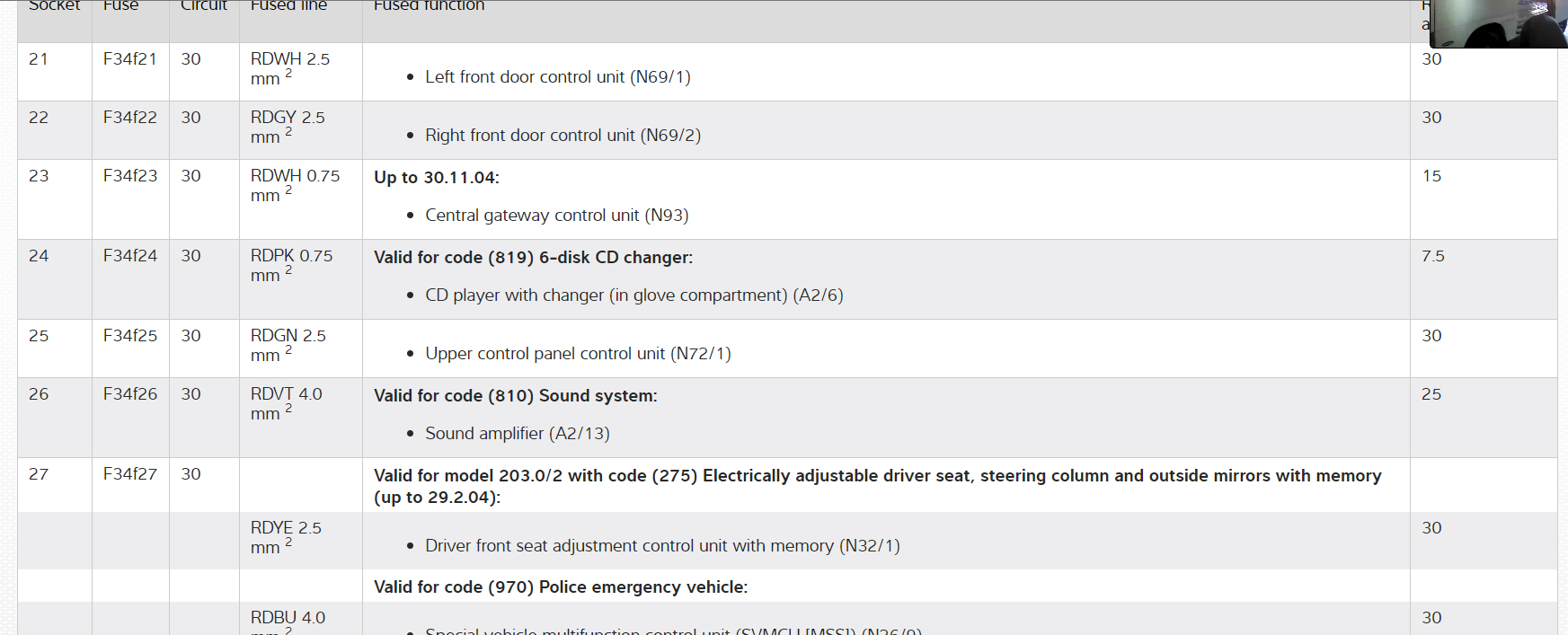

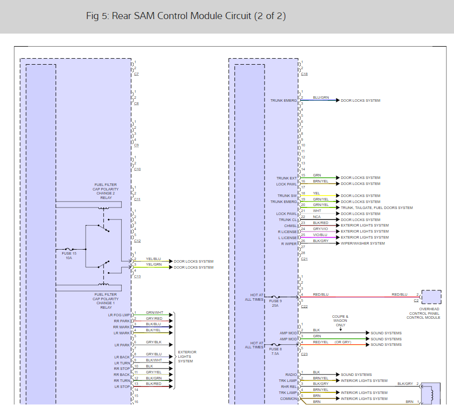

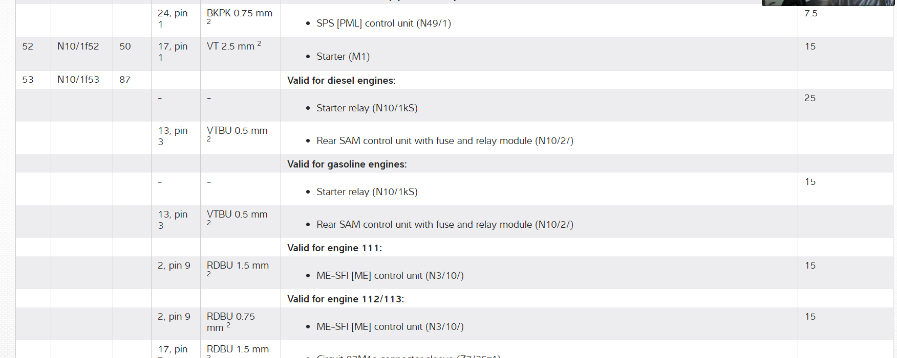

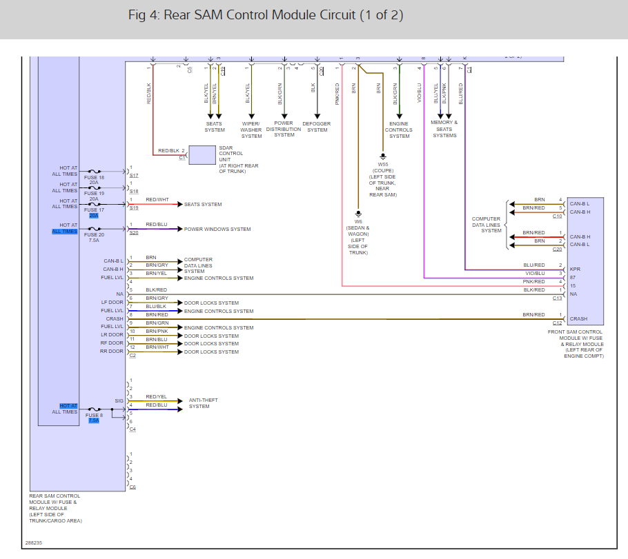

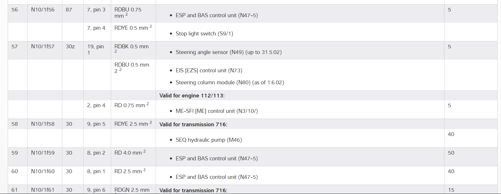

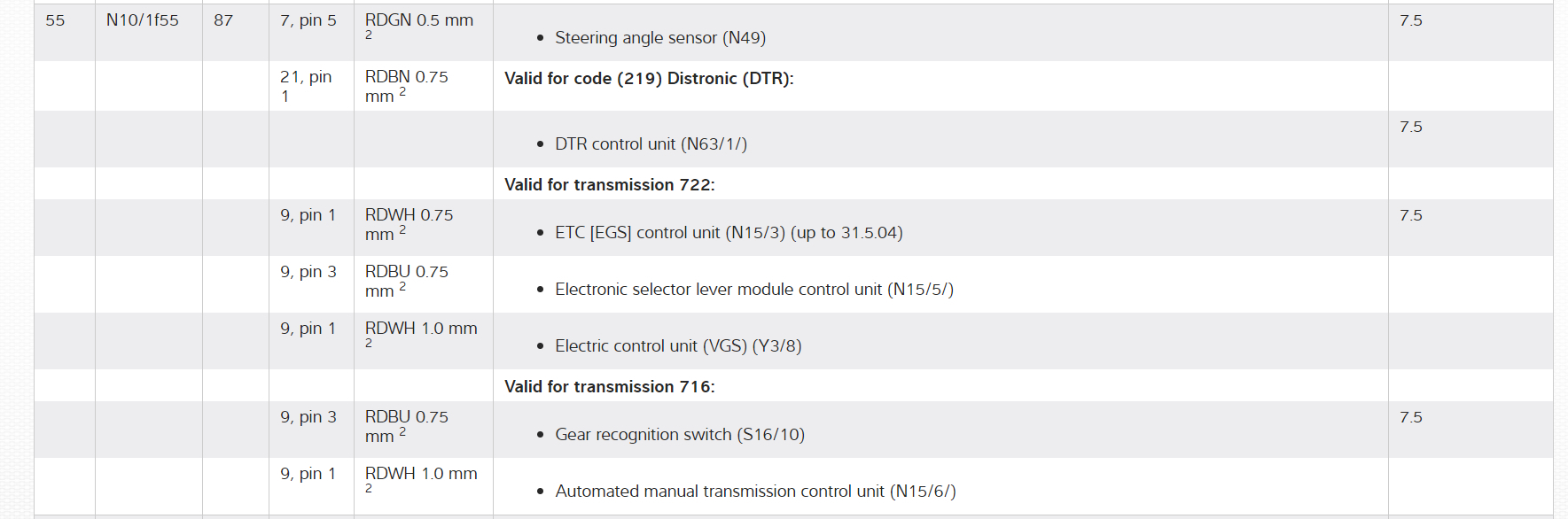

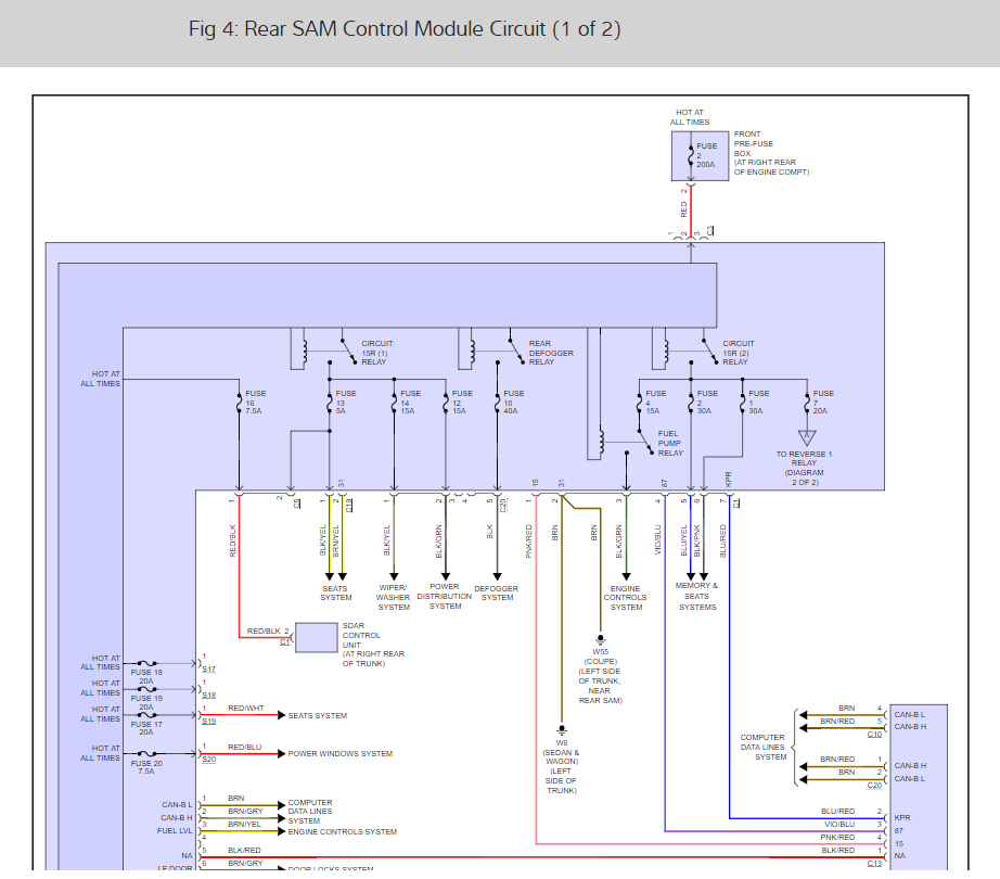

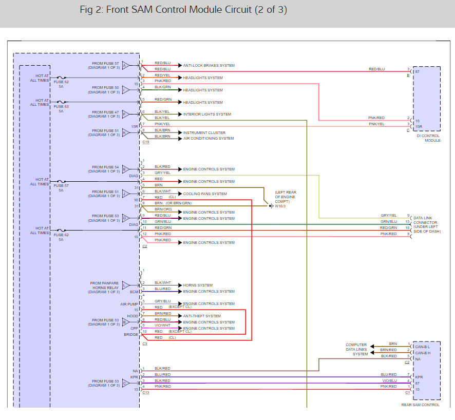

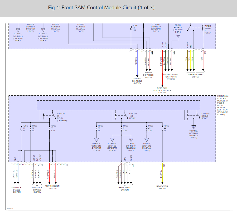

It sounds like you have problem with the front or rear SAM module I would disconnect the battery and then locate the electrical connector and remove them to check for corrosion.

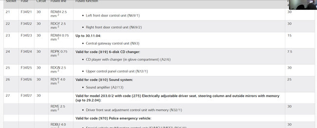

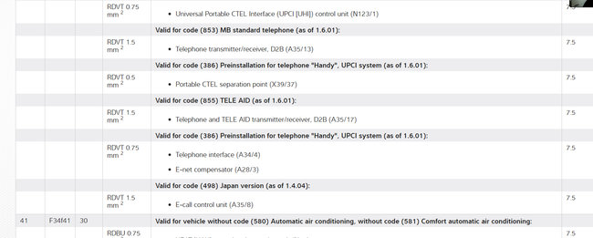

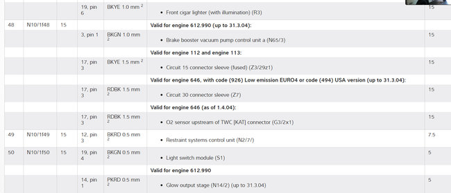

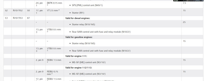

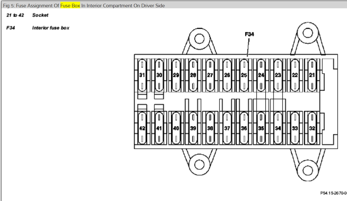

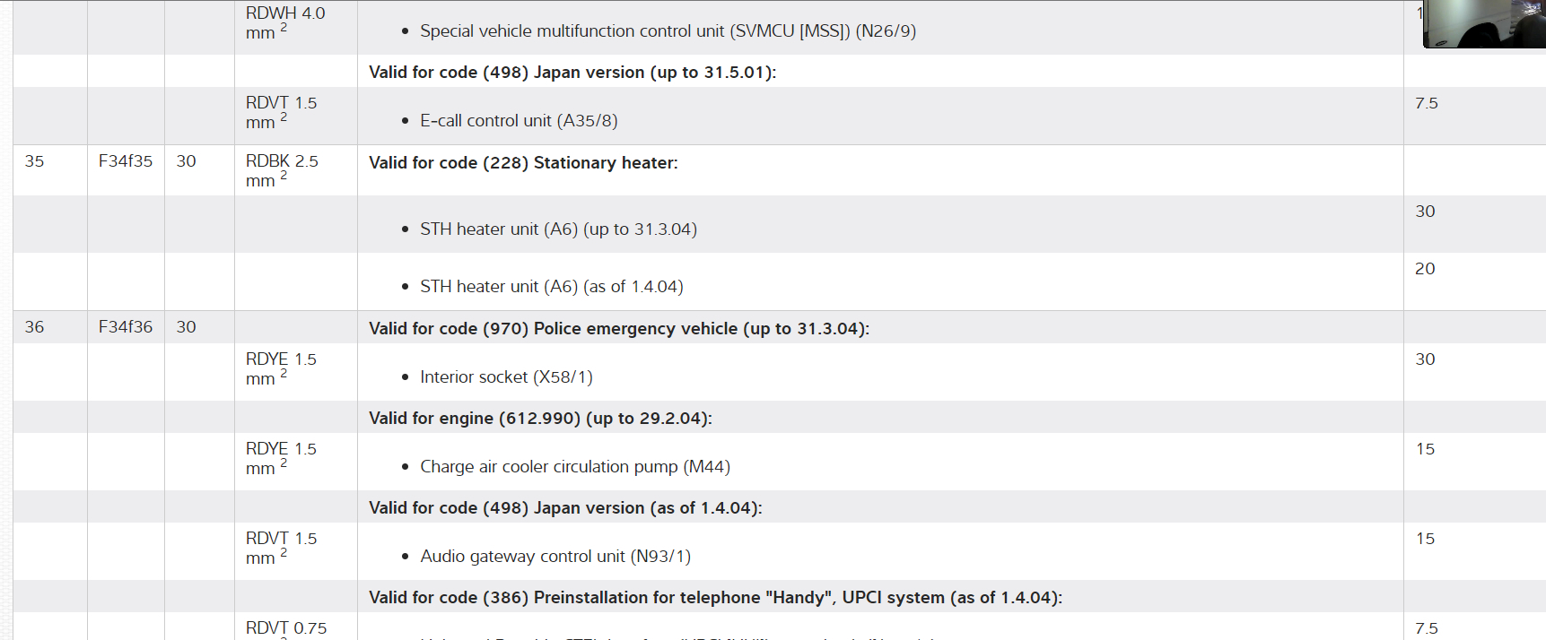

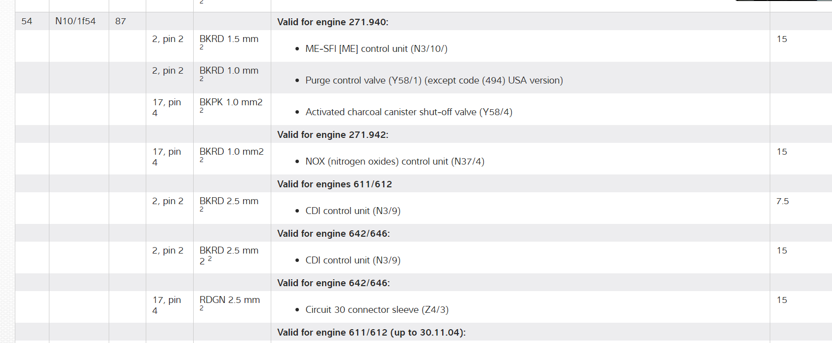

Also, check the fuses because the SAM units use many fuses to work the system. # 16, 14, 13, 12, 10, 4 ,2 ,1 and 7.

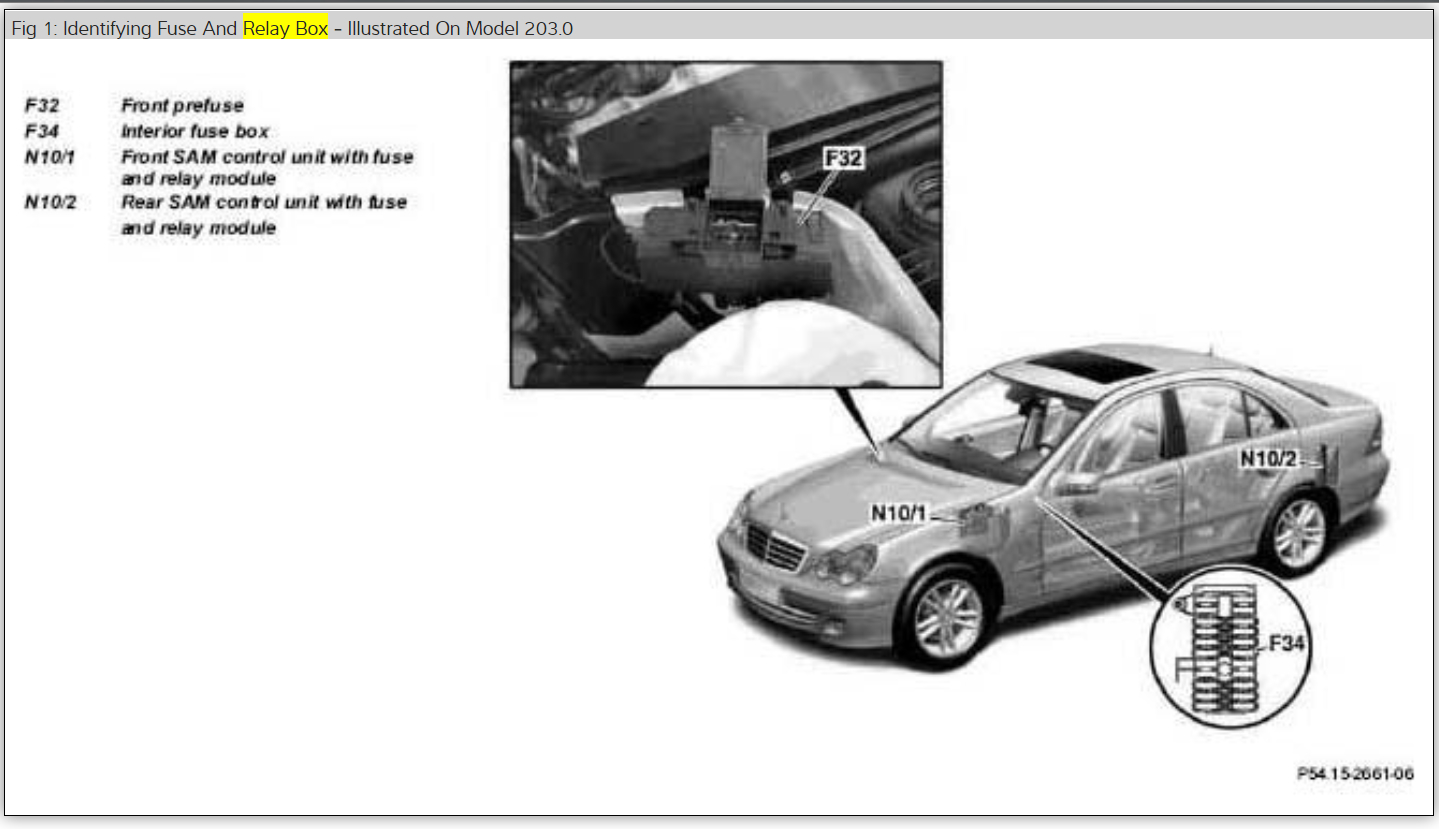

Here is a guide to help us get started:
Here are the SAM module locations and the wiring diagrams so you can see how the system works along with the fuse panel locations and identifications. You can follow this guide to check the wiring before you replace the SAM modules. This will need to be done by the dealer or a shop because they will need to be programmed.
