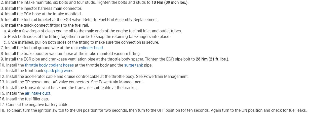

Where is the Knock Sensor location?
1997 CADILLAC DEVILLE
92,000 MILES
CHRISJMW78
Check engine light on code reads knock sensor, can you help with diagram or its location please?
Jun 25, 2022 at 3:01 AM
  • 110,244 POSTS

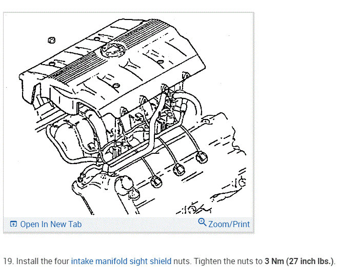

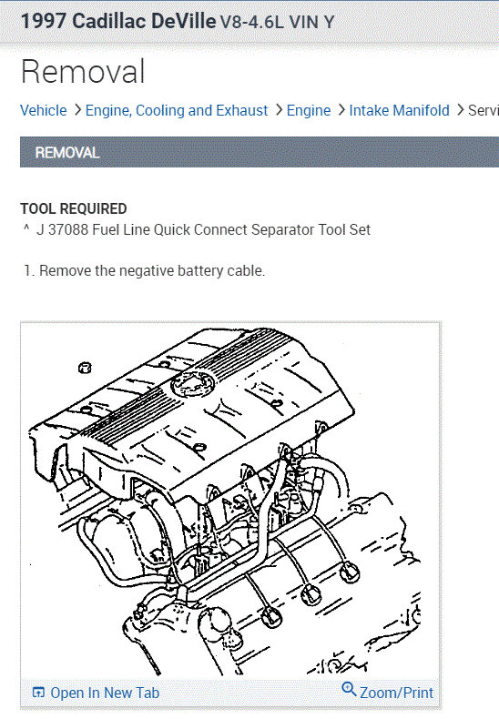

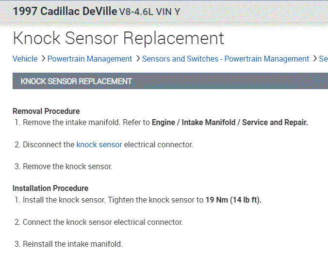

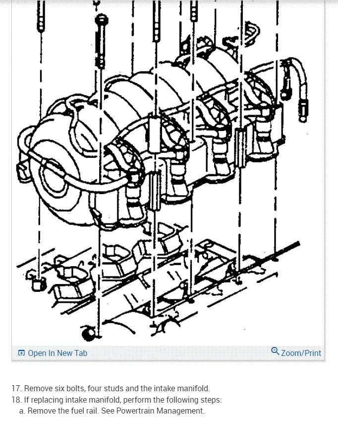

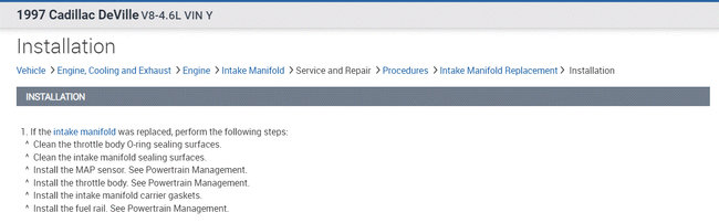

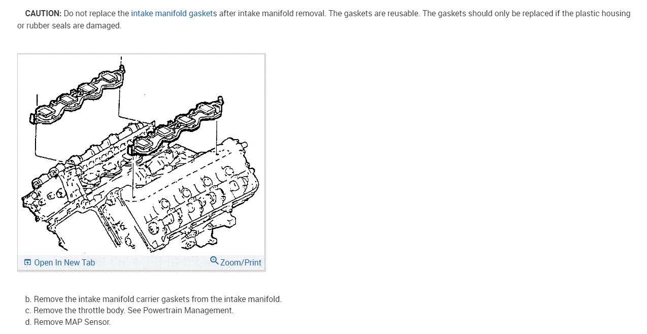

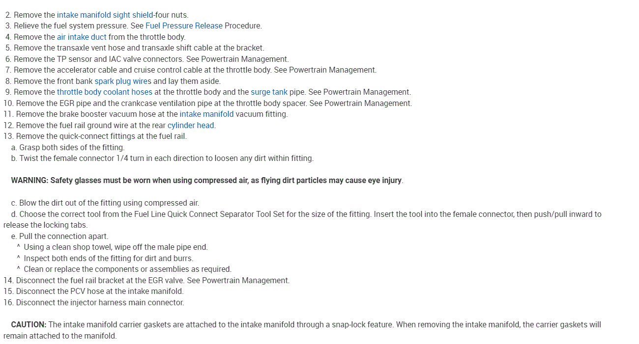

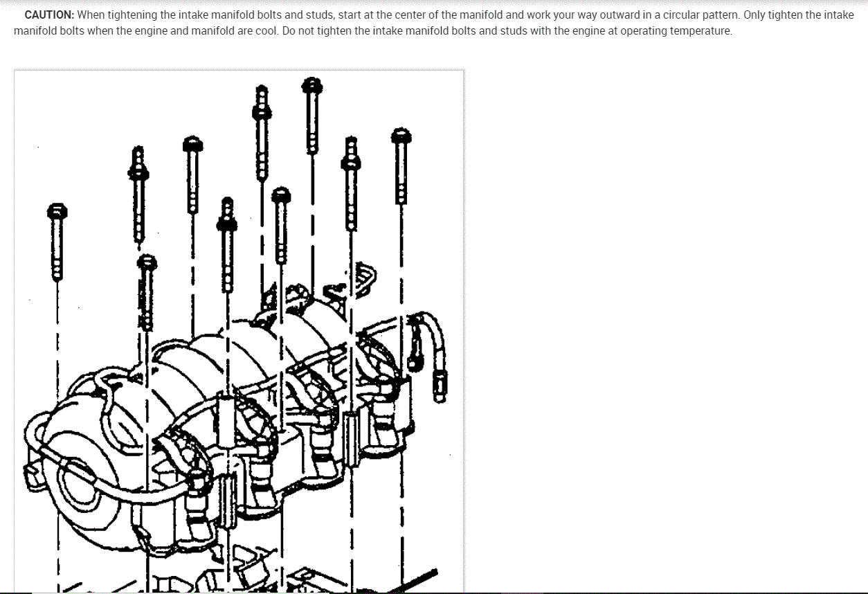

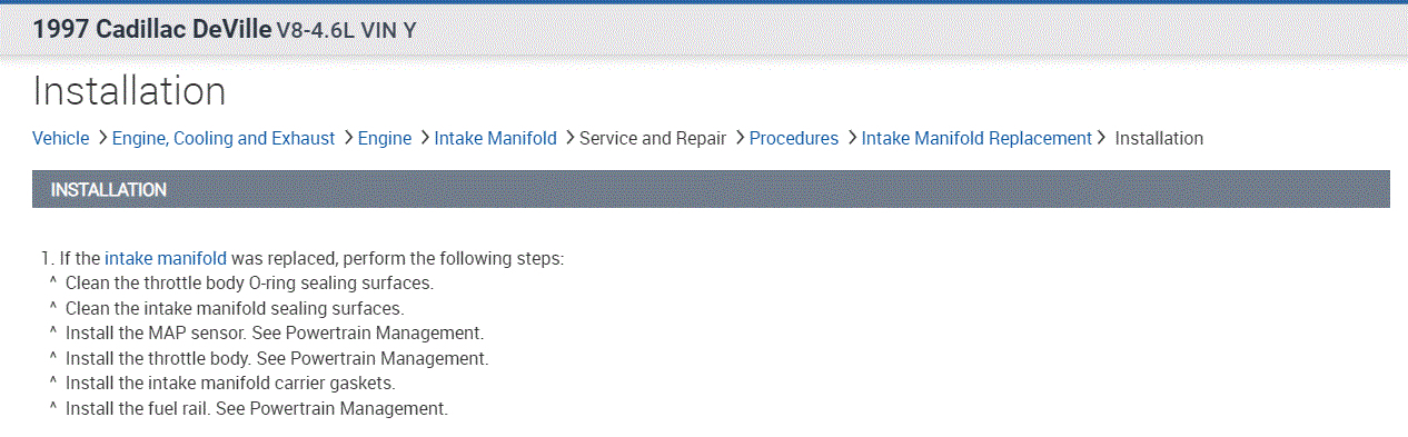

The knock sensor is located under the intake manifold. To access it, the manifold needs to be removed.
If you look below, I included the directions for the knock sensor. See pic 1. The remaining pics are the directions for removing and reinstalling the manifold. They make nothing easy. LOL
