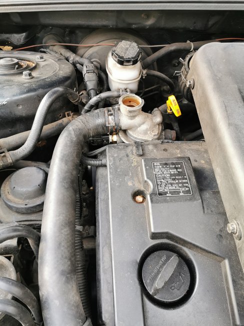

What is the sensor called on the thermostat housing
2004 KIA SEDONA
123,000 MILES • 2.9L • 2WD • MANUAL
KEZZ
Garage who I took the car to says it's the engine coolant sensor, but all the diagrams I've looked at says this is on the engine block.

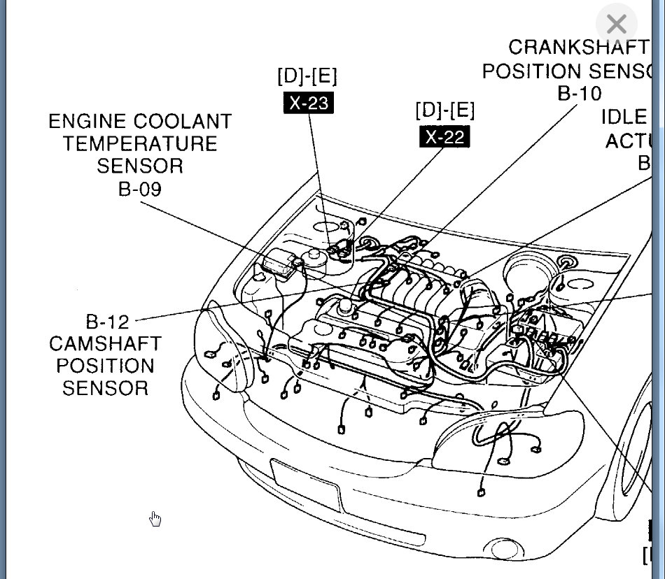

Part of the issue may be that I only show the engine option as a 3.5L. You said your engine is a 2.9L. Is this accurate?

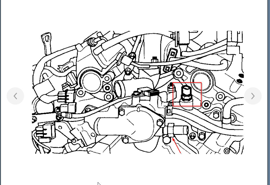

I have included the location for the ECT sensor. If you look at the second screen shot, you will see I put a box around the ECT sensor. The line that appears you are referring too is most likely a bypass hose in the even the thermostat is stuck.
Can you get a picture a little further back and we will see if we can locate your sensor assuming this is the same engine. Thanks

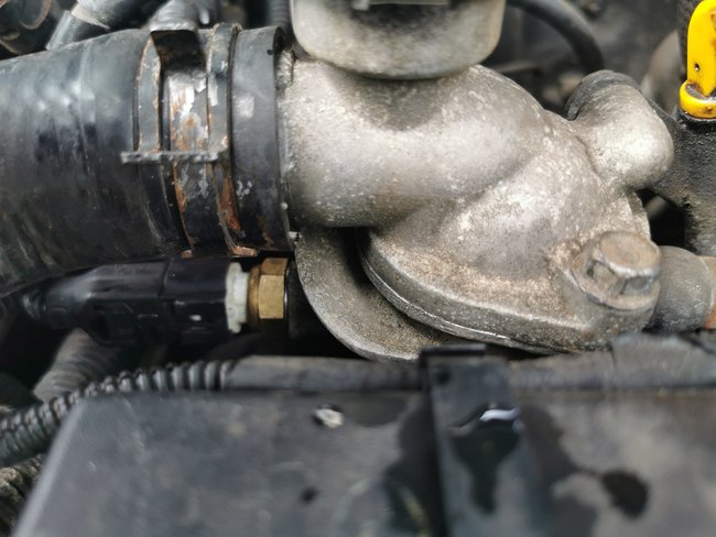

It's the sensor on the thermostat housing I can't work out, I can't find it on any diagrams, the big hose above the sensor runs into the radiator.

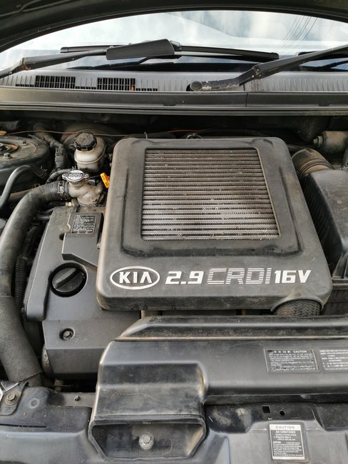

Which engine do you have? 2.9L or the 3.5L?
May 3, 2020 at 12:16 PM
KEZZ
It's a 2.9.
May 3, 2020 at 3:50 PM
So that is the issue. That is the coolant sensor but I too cannot find a diagram on it. We don't have a manual on it because we don't have the 2.9L diesel here in the USA. Plus I didn't notice the engine cover in the picture you took where it clearly labels the engine.
If you want to confirm this and you have a code reader, just unplug the sensor and you should set a code for the coolant temperature.
Sorry I don't have any detail on it but that is what the temp sensors look like and clearly it is in the cooling system.
