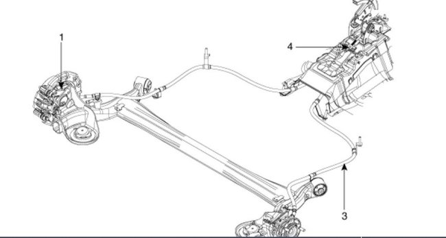

Hey, thanks Roy, I'm starting to wonder maybe cable froze up in winter weather by hand lever when each side attaches and runs in floor boards underneath to back, only since all was fine prior to deep winter. Do I have cable path diagram from handle to undercarriage etc?
Feb 14, 2020 at 9:40 PM
I attached the diagram of the cables for you.
There are 2 cables, one for each side from the handle to the rear wheels.
Feb 14, 2020 at 9:54 PM
MIGUY
  • 8 POSTS
Hey Roy, wanted to update ya. it was frozen interior some place let up. glad it did but get to brakes all around I'm spring, lol. thanks again.
