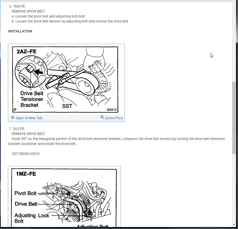

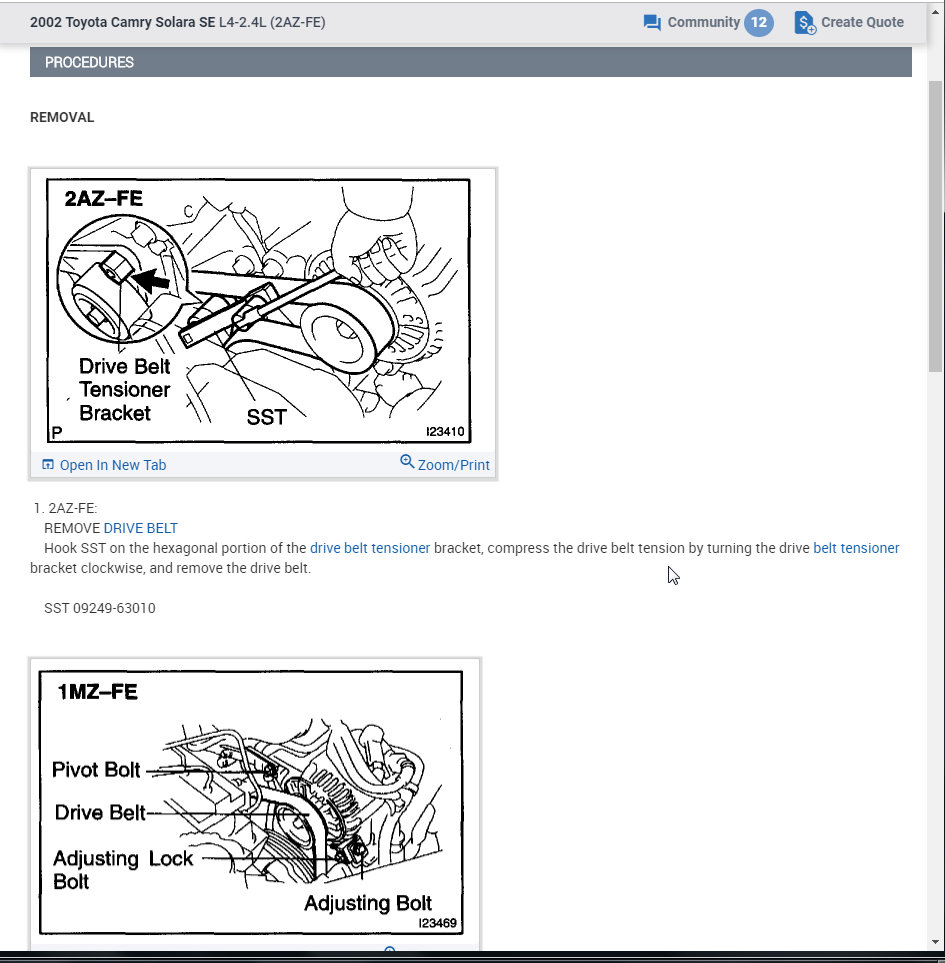

My mother's car's serpentine belt had broken and the alternator had seized when I tried to turn all the pulleys without the belt on I could not turn the A/C compressor by hand. wasn't sure if maybe it only engaged when started. so I put the new belt on and charged her dead battery when I tried to start it it would not turn over at all. so my questions are 1) Could this be the battery not having enough power? 2) What belt would I need to bypass the A/C compressor on this vehicle?
Jan 21, 2020 at 4:33 AM
If the battery is charged or new, it should start the engine. If the compressor is locked up then it could be the issue. I would just remove the belt again and start the engine. If it starts then clearly something on the drive belt system is preventing the starter from turning the crank.
At this point you have three options. Fix the pulley (compressor in this instance), bypass it with a pulley bypass, or get a belt for your engine with no AC and route it as such.
Let me know if you have questions but the next step is to see if it starts with no belt. If not we have another issue which may be the battery if it has a shorted cell.

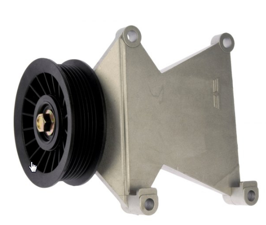

A/C compressor is definitely seized. could you tell me what belt to get to bypass it? I'm broke and can't afford an A/C bypass pulley. Thank you
Jan 23, 2020 at 11:34 AM
Unfortunately, I am not finding an option with no AC which means it comes standard. I am sure there is a belt out there but it isn't listed. The easiest thing to do is remove the belt and run a string around the pulleys and leave it off the AC pulley and then get a belt of that length as they sell belts in different length increments.
