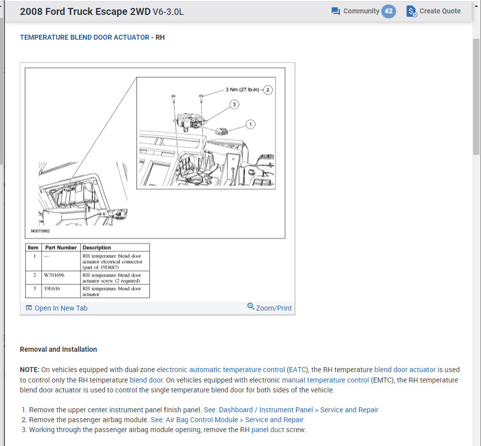

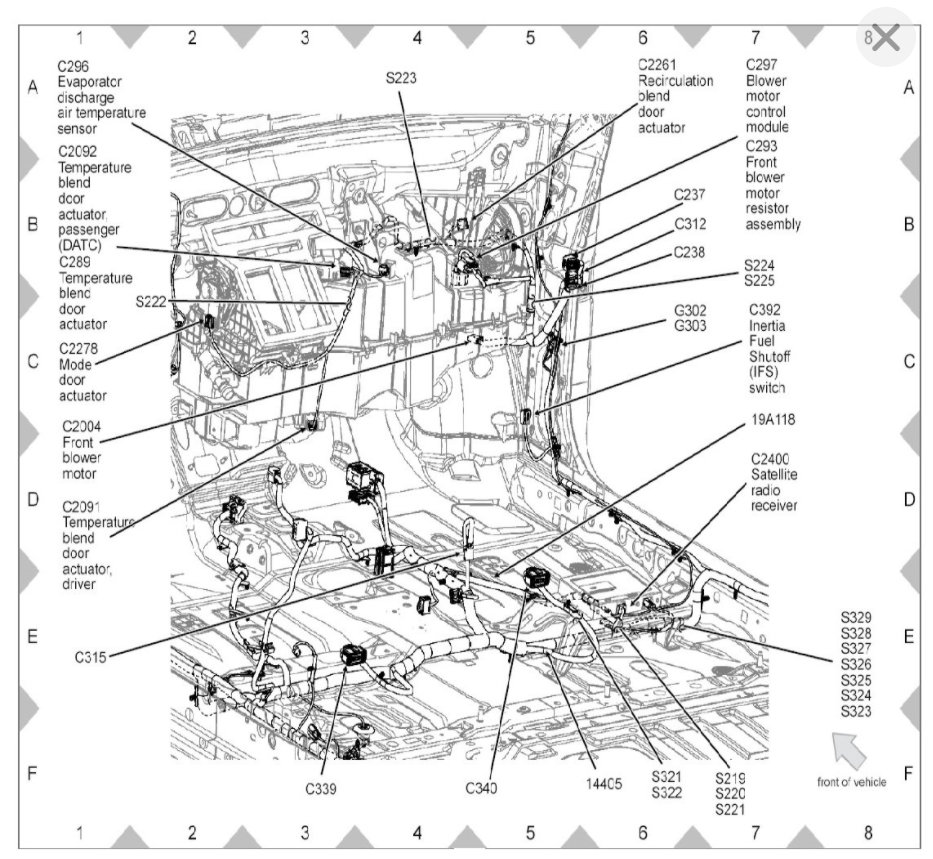

This is a blend door actuator that is on the passenger side. I assume you have dual zone temperature controls? Meaning you can control the left and right side temp separately?

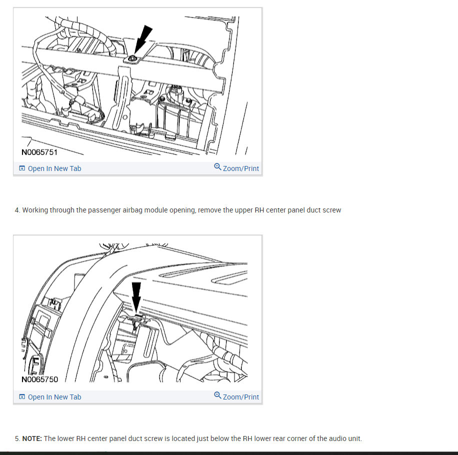

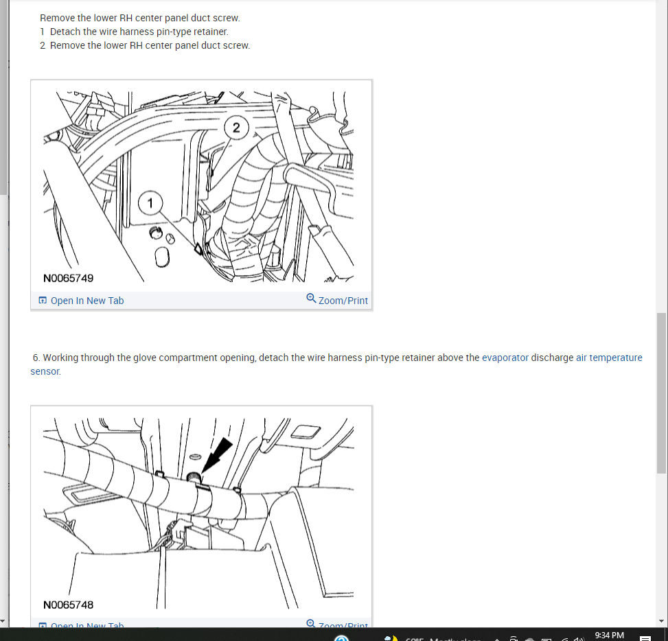

Here is a guide that will help with step by step instructions on how to replace this:
Below is the info from the manual on how to replace this. Please run through this material and let us know if you have questions. Thanks
