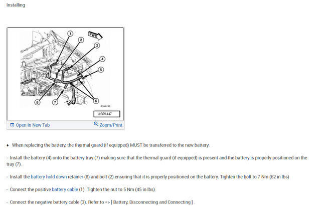

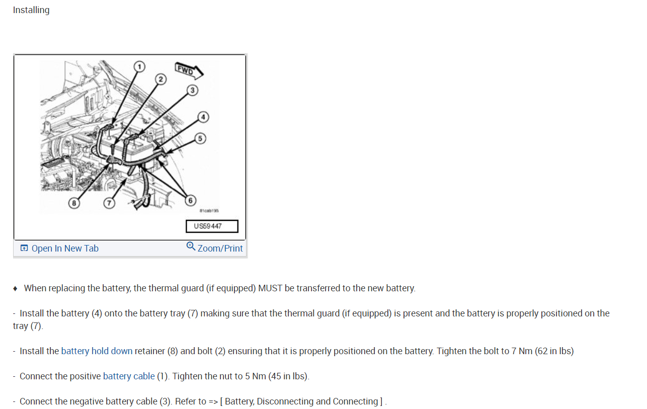

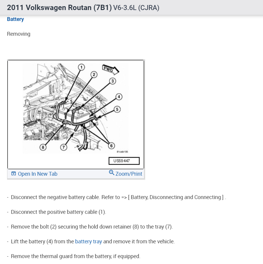

Is the security light flashing? Also, how old is the batter? When the voltage gets low strange things like this happen. If the battery is new, I would remove the negative battery cable overnight to help reset the system. This guide may help as well:
https://www.2carpros.com/articles/how-to-reset-a-security-system
This test can check the battery for you:
Here is how to change the battery out in case you need it. Check out the images (below). Please let us know what happens.
