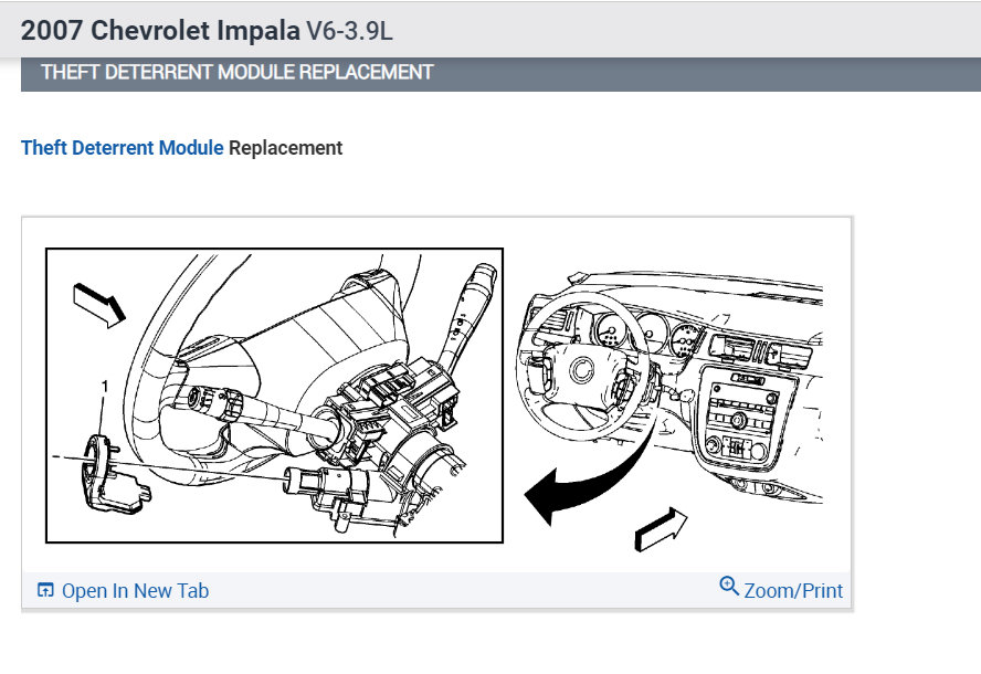

I replaced the keys and programmed it using ACDelco TDS Software. The security light will stay on (not flashing). Message on the dash states: Service Vehicle Theft Deterrent System. I also reprogrammed the Theft System. Vehicle will not crank.
Sep 3, 2022 at 12:44 AM
  • 55,224 POSTS

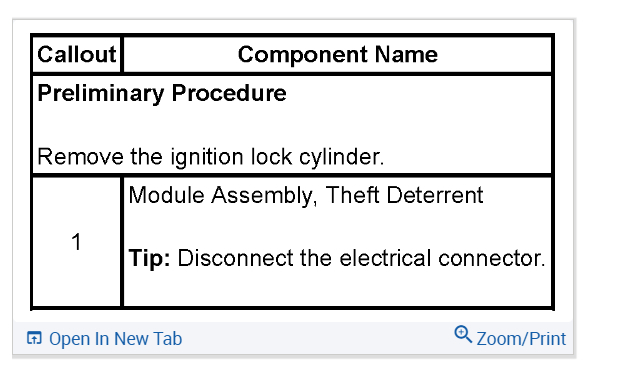

It sounds like the theft deterrent module is bad, here is how to replace it in the diagrams below, I have also included how to program it and troubleshoot steps in case there is a further problem.

Sep 3, 2022 at 1:29 AM
RONALD DEVOLD
  • 134 POSTS
I have a 2006 Impala SS. I put the wrong year in the ad.
Sep 3, 2022 at 4:28 AM
  • 55,224 POSTS
The instructions should work for both.
Sep 5, 2022 at 1:44 AM
RONALD DEVOLD
  • 134 POSTS
I have installed the new theft module, but the instructions you posted do not pertain to the programming software I am using. I'm using the ACDelco TDS software on a laptop with paid subscription. I will follow those instructions, It's almost similar. Once the vehicle is selected. I chose reprogram and replace, then chose Vehicle Theft Deterrent, replace option. I hope it works.
Sep 6, 2022 at 7:32 AM
RONALD DEVOLD
  • 134 POSTS
I meant to type Vehicle Theft Module, not Vehicle Theft Deterrent. The Service Vehicle Theft Deterrent message did not show after installing the new module.
Sep 6, 2022 at 7:34 AM
RONALD DEVOLD
  • 134 POSTS
Success. But I'm back to my original problem. Engine crank but will not start. I will go back to my other posted thread. Thanks for the help.
