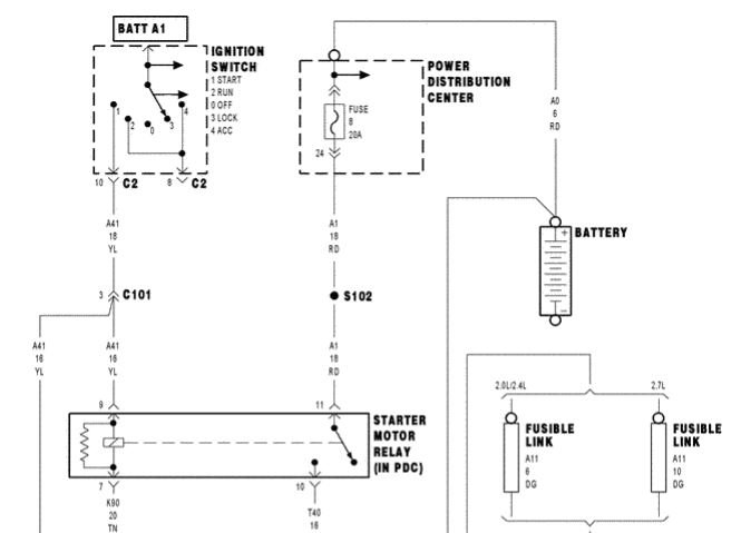

Bought this car a couple of weeks ago from a used car lot. It ran just fine except for needing to get the struts or shocks looked at. Last Saturday night I went out. When I was leaving to go home I nicked a metal pole on the drivers side and it ripped the bumper cover off. Both headlights were loose as well. While getting them back on enough to get home I noticed that the bolts that are supposed to hold the lights in place were rusted or bent. There were no nuts on them or anywhere around. And only one pin still holding the cover on. There was one that was still in place but broken. There were no pins on the ground. So I don't think that the lights or cover were attached how they should be when I bought the car. I drove it to a 7-11, and then home. The next day when my fiance tried to go to work the car would either try to turn over but not, or turn over and then turn itself off. We saw that there was a blinking red light on the dash. I looked it up and found out it was a security light and it was probably Pickering the car from starting. So, I put the lights and bumper cover more securely on the car, how they were when I bought the car it would seem. Then the car wouldn't turn over at all. I have tried everything that I have found to try to reset the system/computer/codes and nothing has worked. I have unhooked the battery, taken out the right fuses, checked all of the fuses for blown fuses, unhooked the PCM, turned the key to the on position and left it for a bit, held the key in the unlock position in the door for a bit, turned the key back and forth in the door, and used a code reader to see whats wrong and erase the codes. The code reader said no codes found. The hood of the car does not stay latch down completely, but it's been like that since I bought it. And I have now found water on the passenger floor, front and back, more in the back. What could be wrong and how do I fix it?

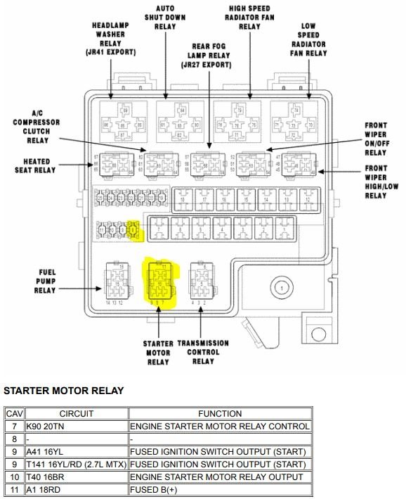

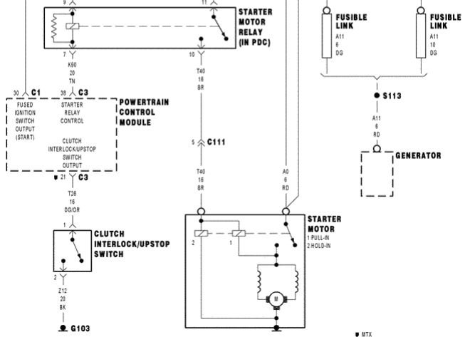

Okay, thanks for the update. Let's forget about the security light for the moment and focus on the no-crank condition. Security related issues on this particular vehicle typically don't cause the engine to not crank. That being said, we'll need to use a test light and go through the starting system circuits. The link below provides some details on how to test the starter fuse and relay(see Section 2). The two diagrams I've attached cover the complete starting system wiring diagram. The third attachment shows the location of the starter relay and Fuse 8 that supplies power to the relay. Read through the procedure to familiarize yourself with the testing process. What we'll need to start with is verifying you have battery power at Pin 10 of the starter relay while the key is held to the Start position.
Let me know what you find!

I apologize. Here is the link for the testing procedures:

Regardless, I would proceed with the starter relay test procedure as indicated previously. That will tell us which direction to go. If we do see output from the starter relay, we know the issue is downstream somewhere with the starter itself or wiring. If no output, we need to move upstream to determine why.
