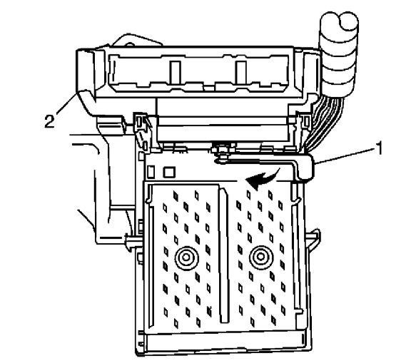

REMOVAL PROCEDURE
IMPORTANT: You must perform the new body control module (BCM) setup when replacing the BCM. Refer to Body Control Module (BCM) Programming/RPO Configuration.
1. Disconnect the negative battery cable.
2. Remove the console accessory wiring junction block.
3. Rotate the BCM retaining lever (1) to release the BCM from the console accessory wiring junction block.
4. Remove the BCM (2) from the console accessory wiring junction block.
