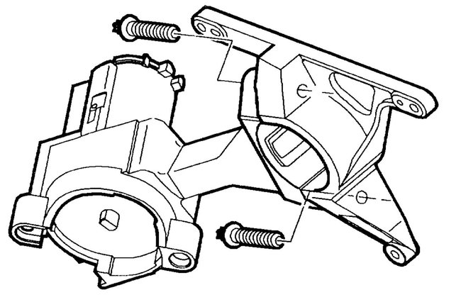

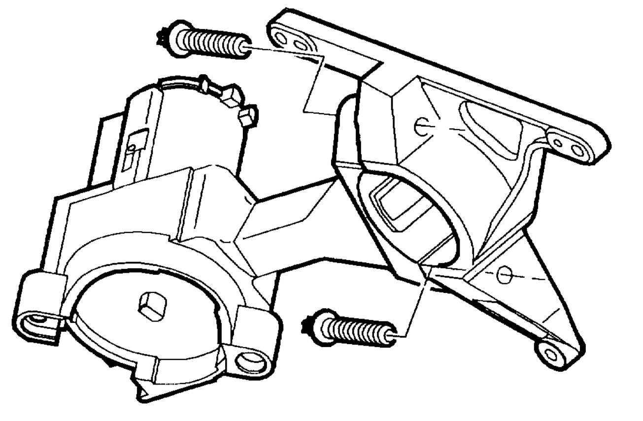

To repair it isn't that hard, you replace the lock housing and the lock cylinder. If you still have at least one key you can get a cylinder that can be keyed to match it. That way you still have one key to use for the ignition and other locks.

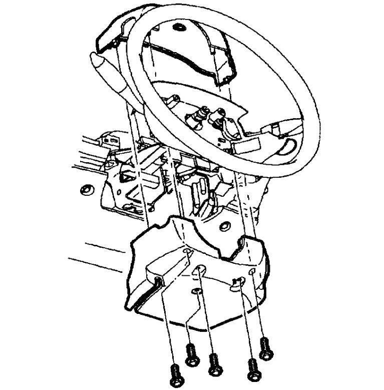

Replacement housings and cylinders are not that expensive rock auto has them for about 100 for both plus shipping. To replace them you need to remove the steering wheel, then the air bag clockspring and the housing. Once replaced you do a 30 minute relearn and the light will go out and you have a working ignition. Takes about 2 hours to do the replacement with the relearn.

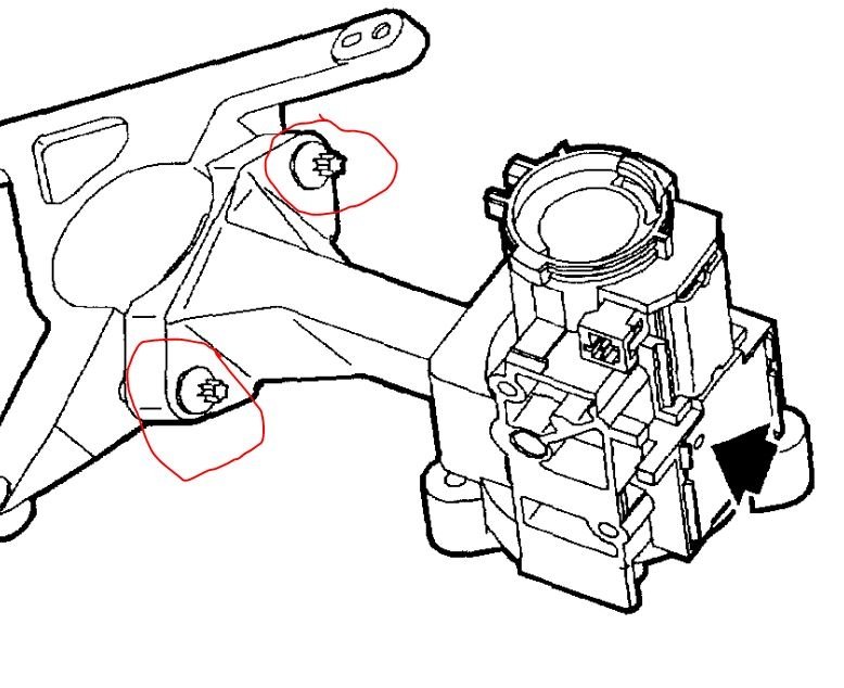

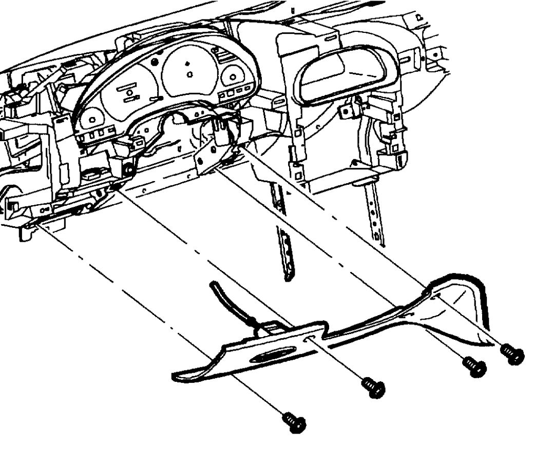

Removal isn't hard, you remove the panel under the steering column, then the plastic shrouds from the steering column. Then depending on the build date you need to look at the lock housing bolts. On some you can get to the bolts to cut a slot in the head or use a chisel to knock them loose. On others you will need to remove the air bag and steering wheel to get room to get the parts out. Once the bolts are out you install the new housing and lock cylinder. Plug in the wiring but don't put it all together yet. You now need to do the relearn process, If you have a scan tool this is fast if not it takes at least 30 minutes so attach a charger to the battery if it's dodgy.
