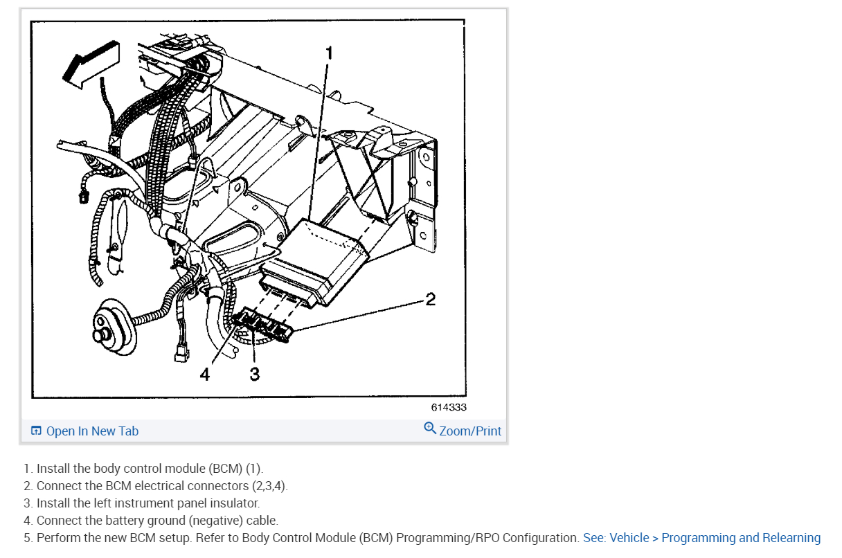

My car's security light is in my message center. my radio shows locked however it will still start and drive, but sometimes the radio wont show locked. when it does show locked my daytime running lights flicker so I have to manually turn on lights and they work. I don't have money to take to shop because I know labor is expensive. any suggestions? I also tried to get code for the radio and it wont pull up. I was told by someone it could be because it is an after market GM key.
May 27, 2019 at 12:39 AM
  • 55,554 POSTS

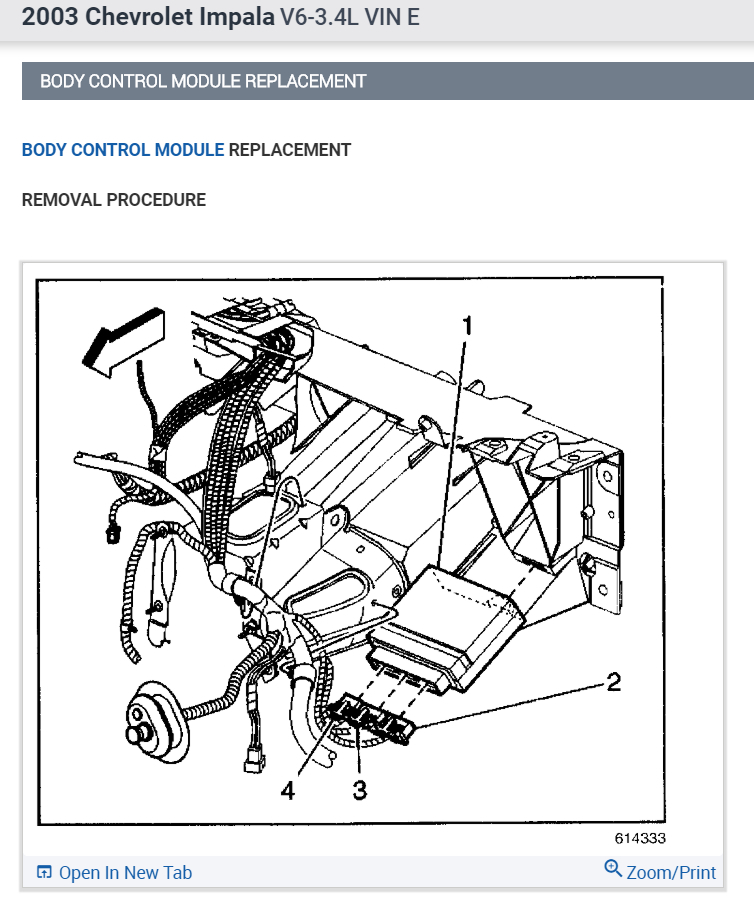

Both system are controlled by the BCM, I would check the unit and the connector for water damage or corrosion. If you need to replace it here are the instructions with the BCM location below

1. Connect a scan tool (Tech 2) to the Data Link Connector (DLC).
2. Turn the ignition switch on.
3. Select Diagnostics and input all of the required data when prompted by the scan tool (Tech 2).
4. Select BODY CONTROL MODULE.
5. Select SPECIAL FUNCTIONS.
6. Select Setup New BCM.
7. Note, Input all of the required data when prompted by the scan tool.
8. Select Setup SDM Part Number in BCM, and follow the onscreen directions.
9. Select New VIN, and follow the onscreen directions.
10. Select Option Configuration, and follow the onscreen directions.
11. Select Point of Sale, and follow the onscreen directions.
12. Exit back to the SPECIAL FUNCTIONS menu.
13. When the BCM, VIN, Point of Sale and Option Configuration have been entered, proceed with the Theft Deterrent Re-Learn procedure.
14. If the scan tool displays UNABLE TO PROGRAM BCM. BCM IS SECURED, then the BCM must be replaced and this procedure must be repeated on a new BCM.
