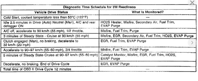

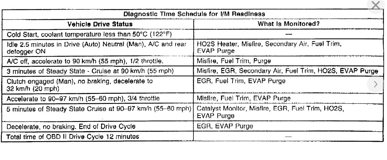

If you do not reset the codes or clear them, it will take fifty key starts with no fault in the system and it will clear itself.
If you cleared the codes, you will need to do a drive cycle to set all the monitors. It could take some time if you are doing it yourself. A shop can do a drive cycle in about one hour.
Did you clear the codes?
+1
Tuesday, September 4th, 2018 AT 2:07 PM
LEONLLNSRR
  • 6 POSTS
Yes, but the OBD still said it may or may not pass the smog test.
+1
Wednesday, September 5th, 2018 AT 1:37 PM
  • 52,797 POSTS
The scan tool does not tell you it will or will not pass the test. It has to run the test and it is either complete or incomplete.
Do the drive cycle and see if the monitors all set. They all need to be complete for you to pass your smog.
