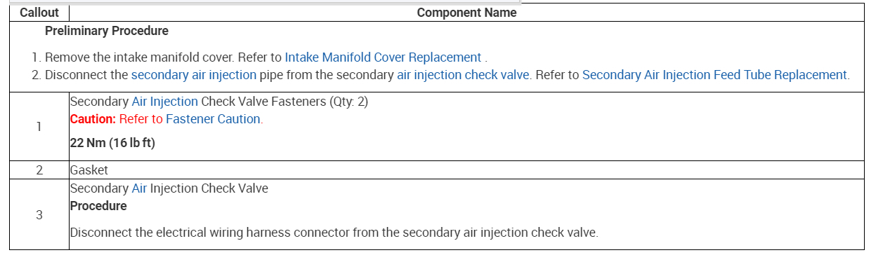

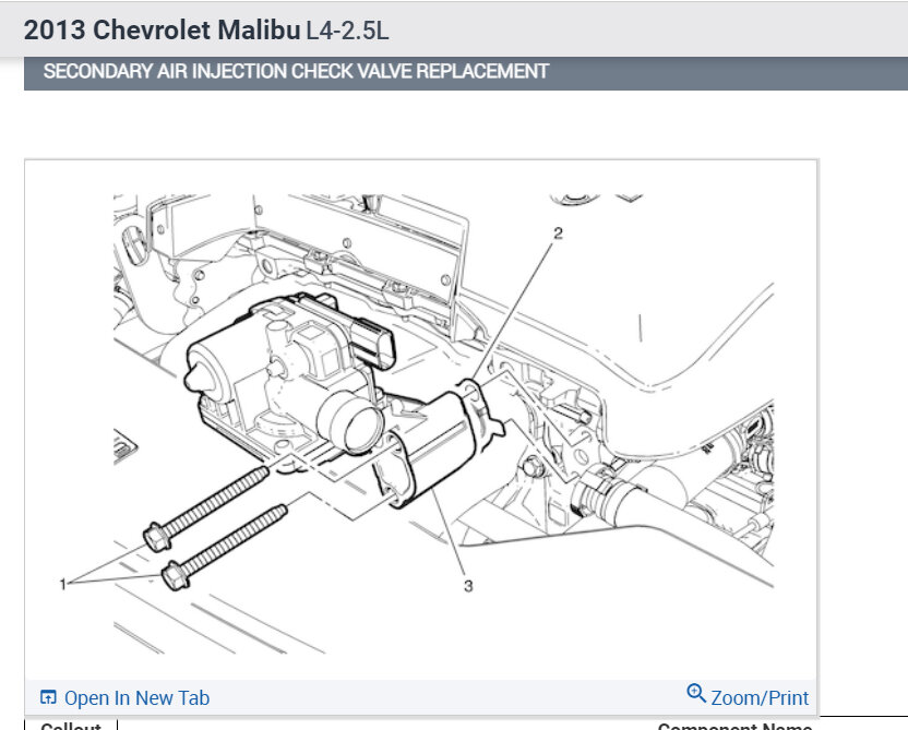

  • 55,837 POSTS
P2440 - Secondary Air Injection System Switching Valve Stuck Open, if so, you should be able to remove the valve and blow through it, I would try that first, you could have a defective valve, or something is stuck in it.

  • 55,837 POSTS
P2440 The solenoid (shutoff and check) valve is stuck open or a system leak between the pump and the valve has been detected.
Let's remove the valve and see if you can blow through it? It should not allow flow. Also recheck the hose connections to make sure there are no leaks.
