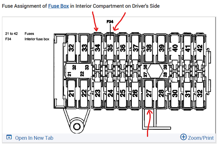

Both front seats do not move when i press the buttons?

Also, wipers do not work. Not sure if they are related. Where would the fuse be on this car?

Please start a new thread for the wipers, it sounds like you may have a driver's seat position adjustment control module that is not working but it is run by two fuses, #27 or #29 and fuse # 34 in he fuse panel on the left side of the dash. This guide can help and I have included the fuse locations as well.
If the fuses are okay there is a ground for the module, T19 at the right doorsill please check that as well. Check out the images (below). Let us know how it goes

I thought you meant the fuse box was under the hood, but I will check fuses tomorrow for under steering wheel. But when I bought this car it had a problem with the top, so I fixed the hydraulic cylinder and now the top works. Today I went under the seat on passenger seat, and I found 2 connectors, both unplugged, a small one and a large one, not sure why they were unplugged. The passenger seat moves now. The driver seat when I looked under found the small one disconnected, plugged it but nothing happened. Pressing the buttons does not create any clicks.

The switch might be bad, let's check the fuses and let me know please.
