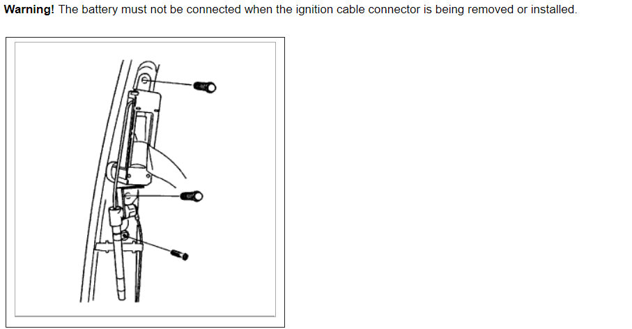

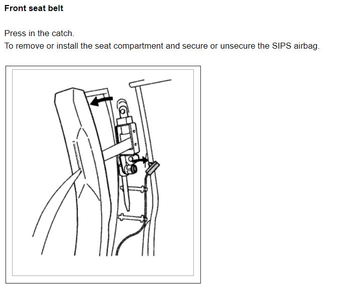

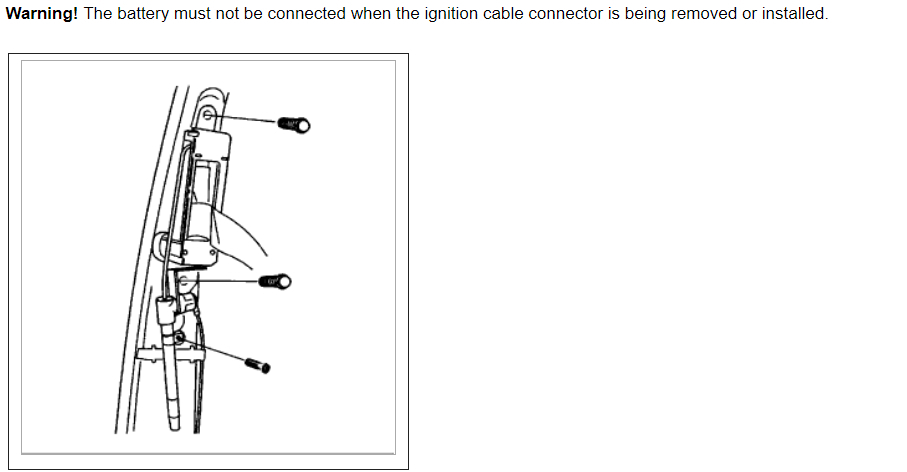

seat belt on driver's side will not retract.
Feb 23, 2018 at 12:20 AM
  • 55,399 POSTS
Can you look to see if the belt is folded over on itself? If not the re-tractor will need to be replaced. Here is a guide to show you what you are in for when doing the job.
Feb 24, 2018 at 4:22 AM
KRAMERDAD
Thanks so much Ken, ten minutes after viewing the informative you sent my problem was solved.
