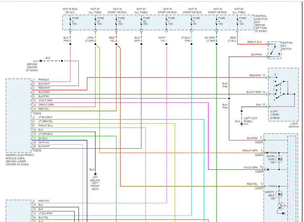

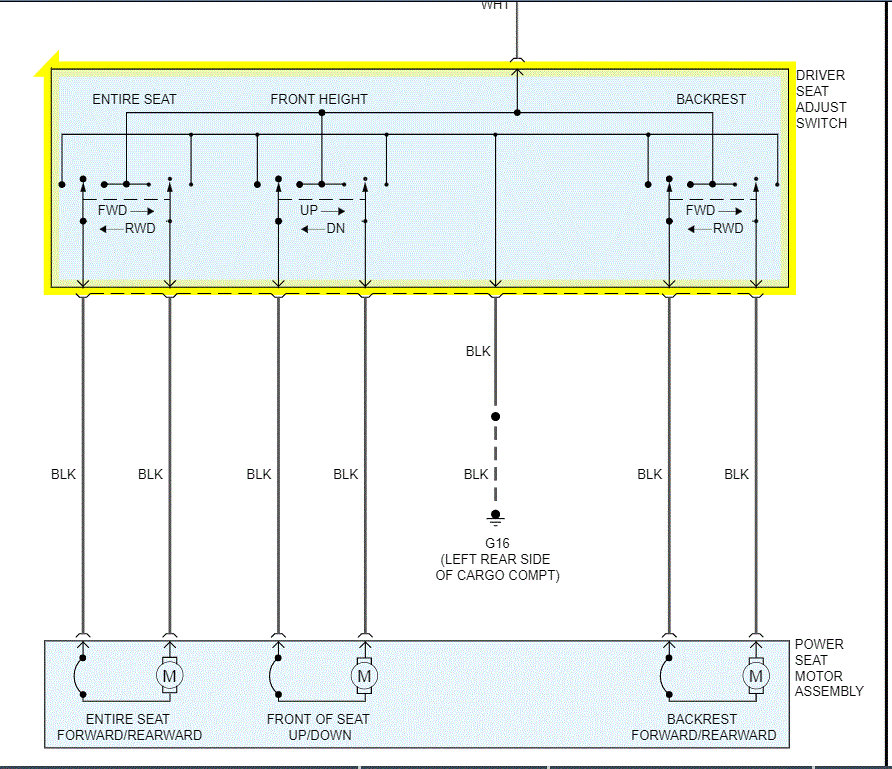

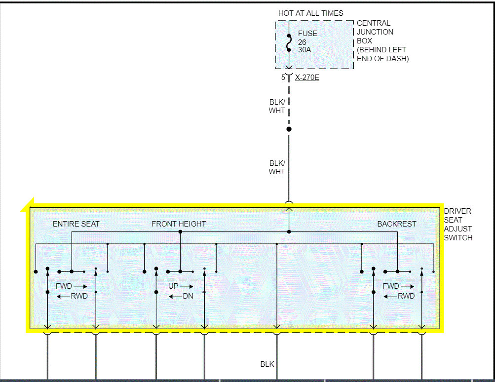

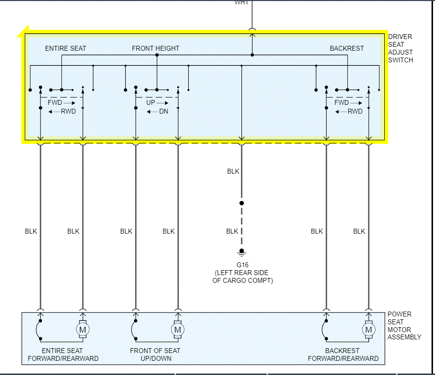

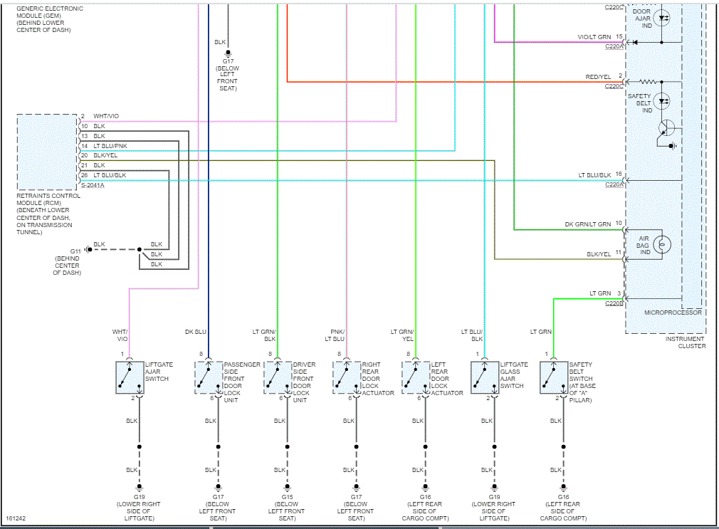

If you look at pictures 1 and 2, I attached the wiring schematic for the power seat. I cut it in half to make it more readable for you. I did overlap it so you can easily follow it. Pictures 3 and 4 are the only ones I can locate for the seat belt warning system.
Let me know if this helps or of you have other questions.

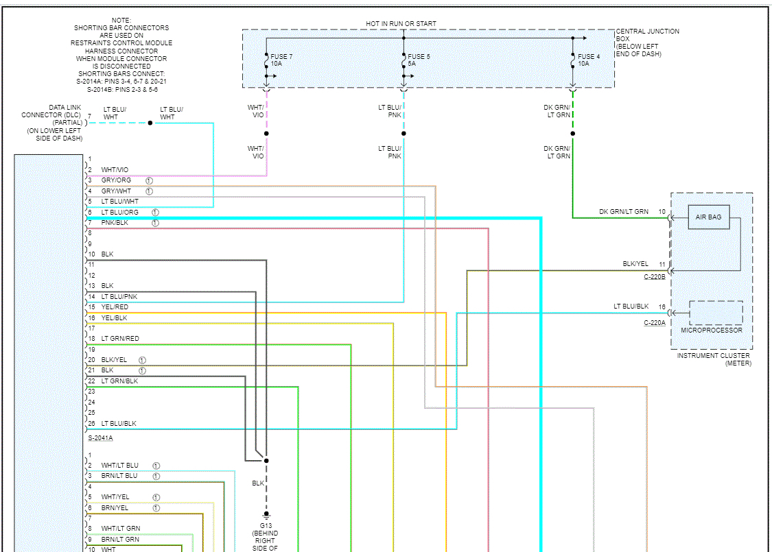

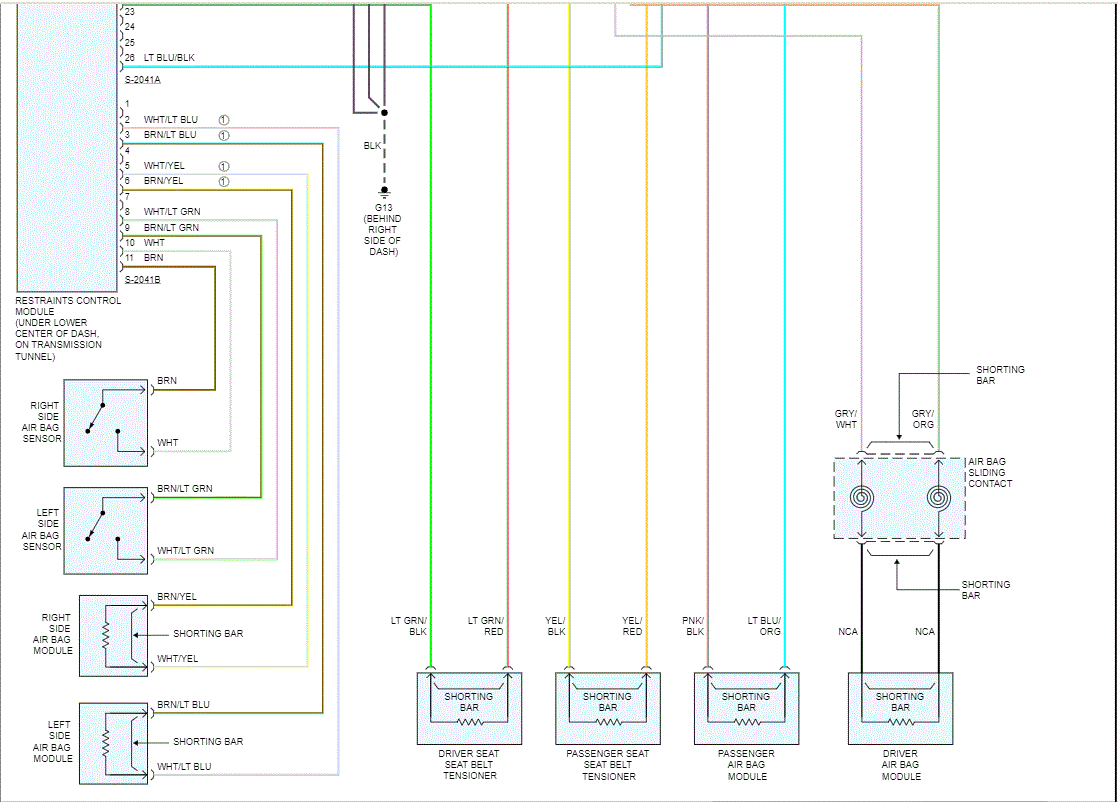

Joe, Thank you so much. Do You have access to the schematics to Supplemental Restraint System? I'm wondering if that's what the yellow tubes on the side of Belt receivers are?
Apr 27, 2020 at 12:34 PM
  • 110,240 POSTS
Yellow tubes? I'm not sure I understand. However, I attached two pics below of the schematics related to the supplemental restraint system. I overlapped them so you could follow them.
Let me know if this is what you wanted.
