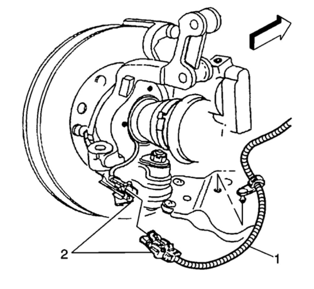

3. Disconnect the wheel speed sensor electrical connector (2), if equipped.

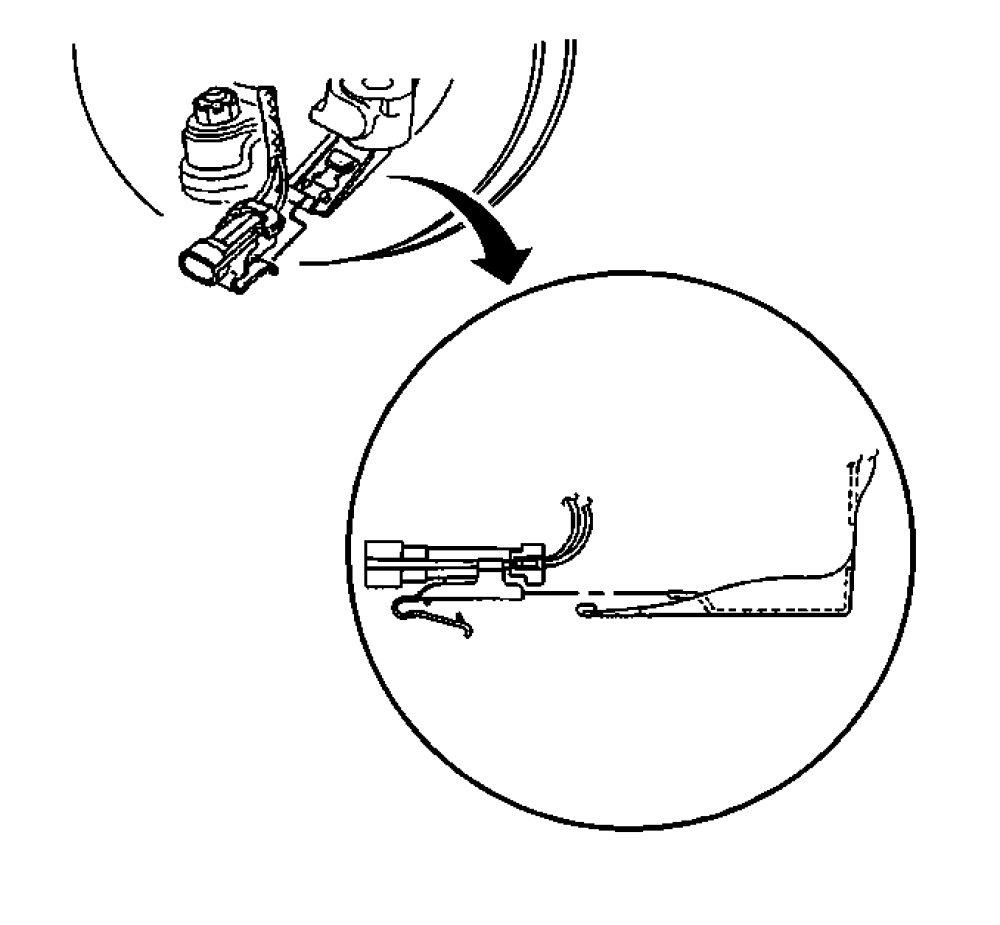

4. Remove the wheel speed sensor electrical connector from the bracket, if equipped.

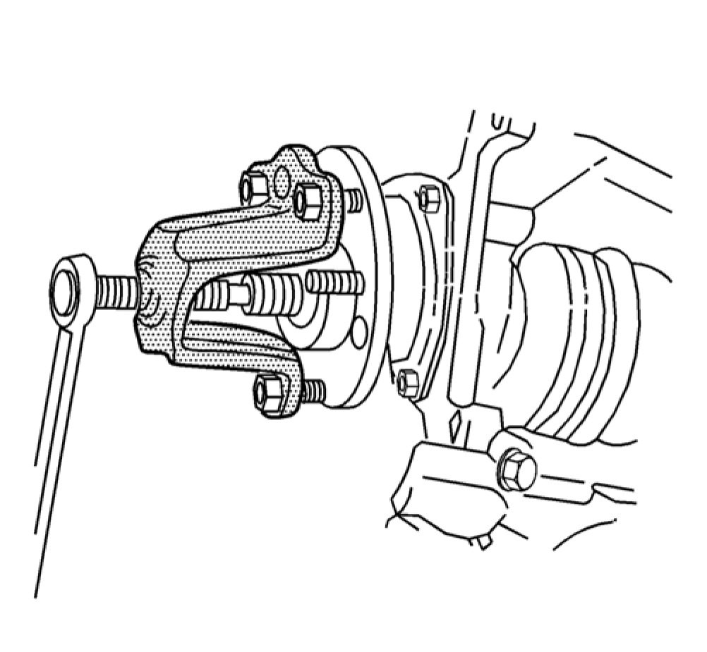

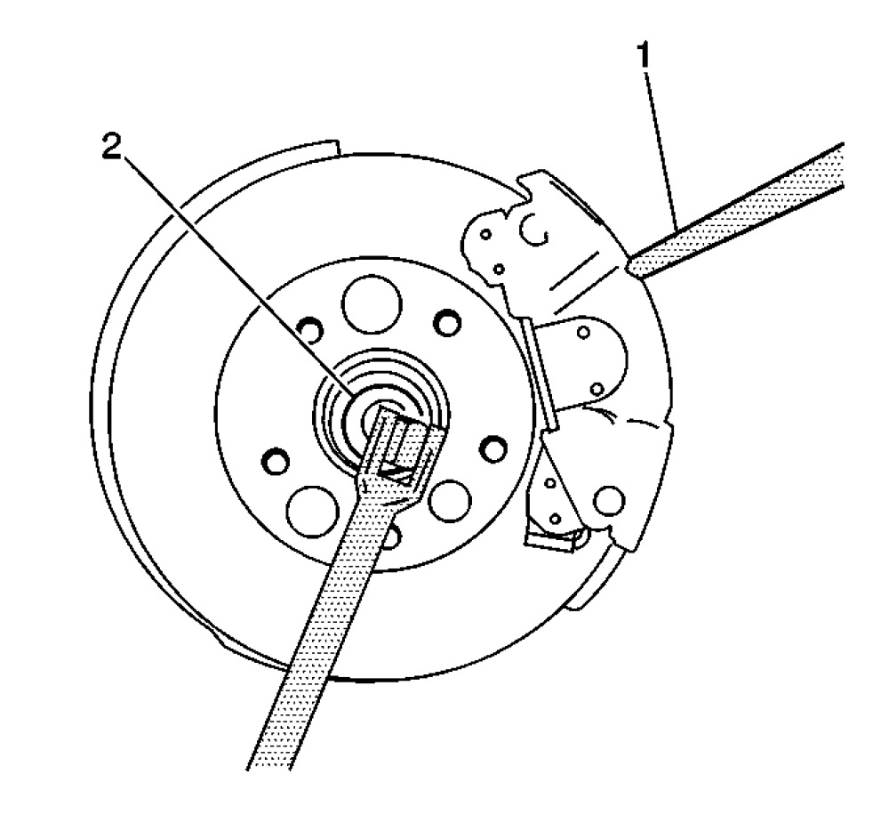

5. Remove the front wheel drive shaft nut (2). Insert a drift or flat-bladed tool (1) into the caliper and rotor to prevent from turning.
6. Remove the brake rotor. Refer to Front Brake Rotor Replacement See: Brake Rotor/Disc > Procedures.
pic 4

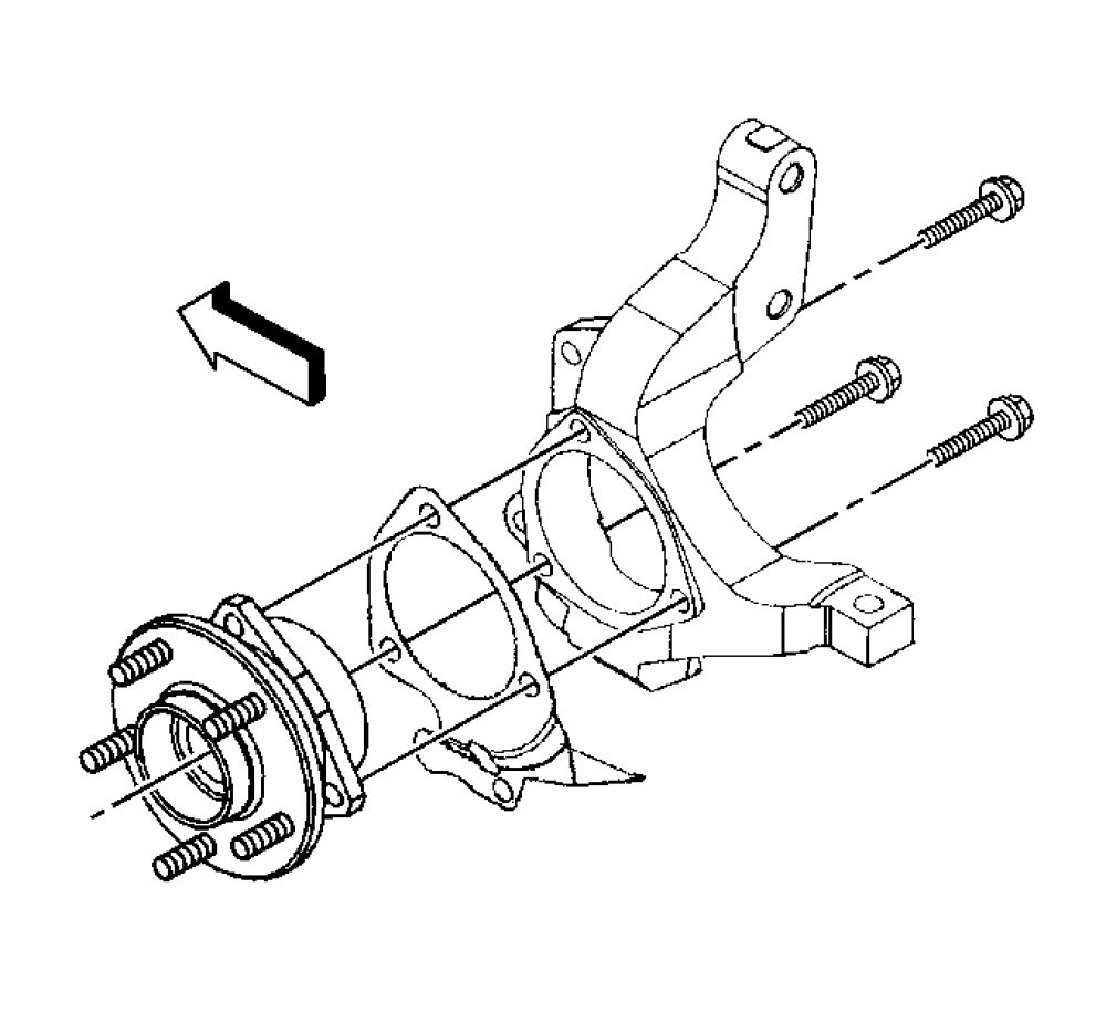

1. Install the wheel bearing/hub with the splash shield as noted during removal.
