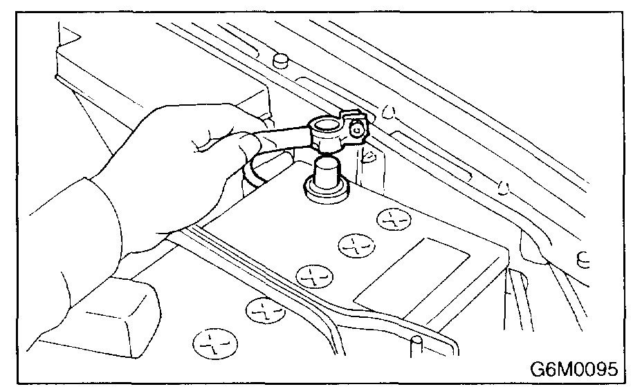

1. Disconnect battery ground cable.

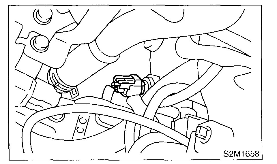

2. Remove air intake duct and air cleaner assembly.

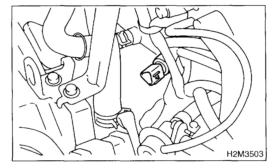

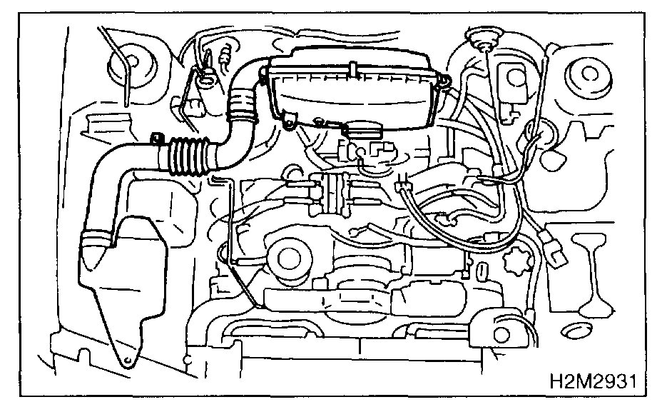

3. Disconnect connector from engine coolant temperature sensor.
4. Remove engine coolant temperature sensor.
