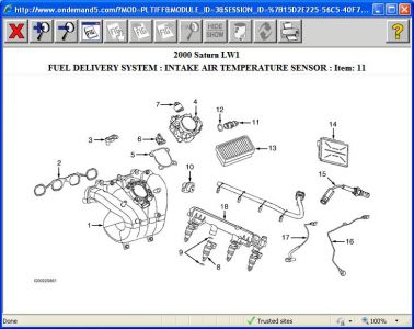

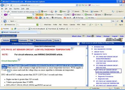

https://images.2carpros.com/forum/automotive_pictures/416332_2000_lw1_iat_1.jpg
https://images.2carpros.com/forum/automotive_pictures/416332_2000_lw1_iat_local_1.jpg
in the diagram its figure 11.let me know if u have any more questions.
