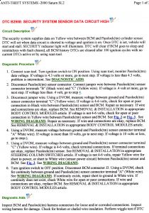

ok car starts runs for a short time then turns off when it shuts off the security light flashes 5 times then goes steady, a friend with a diagnostic checker got back a b2958 code which is security how do we fix this.

https://images.2carpros.com/forum/automotive_pictures/416332_img014_1.jpg
heres the trouble tree for that code follow it and let me know what u find.
