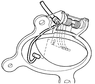

i need to change tne ignition or the lock cylinder for my car...how?
Jan 25, 2010 at 7:27 AM
  • 75,992 POSTS
Ignition Lock Cylinder - Removal REMOVAL 1.Disable the SIR system. (Refer to Disabling the SIR System in Diagrams/Diagnostic Aids/General Troubleshooting Procedures/The SIR System. ) See: Diagrams\Diagnostic Aids Ignition Switch: Removal

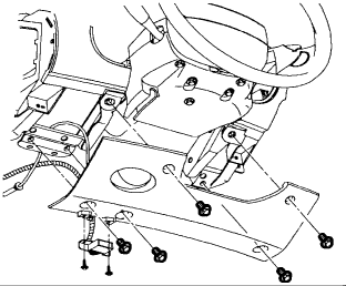

2.Remove two screws holding Data Link Connector (DLC ) to filler panels. 3.Remove the five steering column filler panel screws.

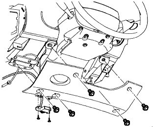

4.Remove hood release cable from lever by releasing cable housing, then rotating cable downward to cutout. 5.Remove steering column filler panel. Ignition Switch: Removal

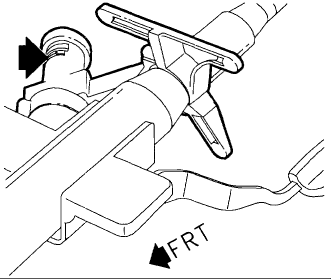

6.Remove two upper-to-lower steering column shroud screws and three lower steering column shroud-to-steering column screws. 7.Remove upper steering column shroud. 8.Insert ignition key into ignition lock cylinder and rotate ignition key to ACC position. Ignition Switch: Removal
https://images.2carpros.com/forum/automotive_pictures/12900_isi4_1.gif
9.Depress the square locking button on the top of the ignition lock cylinder module and slide ignition lock cylinder assembly from ignition lock cylinder. Ignition Lock Cylinder - Installation INSTALLATION 1.Position new ignition and start switch (P/N 21024682) to ignition module assembly and install two screws and tighten. Torque: 2 - 3 Nm (18 - 27 in.lbs.) 2.Connect electrical connector to ignition and start switch. Ignition Switch: Installation
