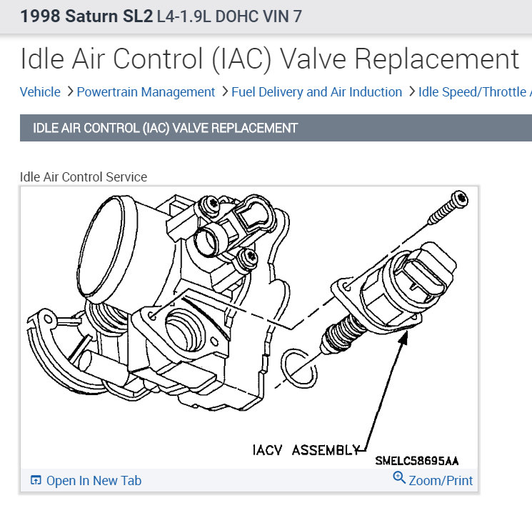

When started maintains 1900 rpm when driving and to a stop. After about 20 minutes or more it comes back down I took it to dealers they cleaned out throttle body and replace a throttle body switch it and still accelerates. What could I do to fix it myself?
Monday, July 5th, 2010 AT 1:44 PM
8 Replies
SATURNTECH9
  • 30,869 POSTS
It soin slike they missed the IAC which sounds weak. Here are two guides that can help us fix this problem.
https://www.2carpros.com/articles/engine-idles-too-high
and
https://www.2carpros.com/articles/how-to-replace-an-idle-speed-control-motor-iac
Check out the diagrams (Below). Please run this test and get back to us.
Monday, July 5th, 2010 AT 4:05 PM
ALBERTAMABISCA
They replaced idle air control valve, cleaned throttle body bore and cleaned injectors they did not mentioned any codes that poped up. Still had the same problem in the morning for. It wasnt cheap!Should I try replacing ects sensor? Thank you very much
Monday, July 5th, 2010 AT 7:46 PM

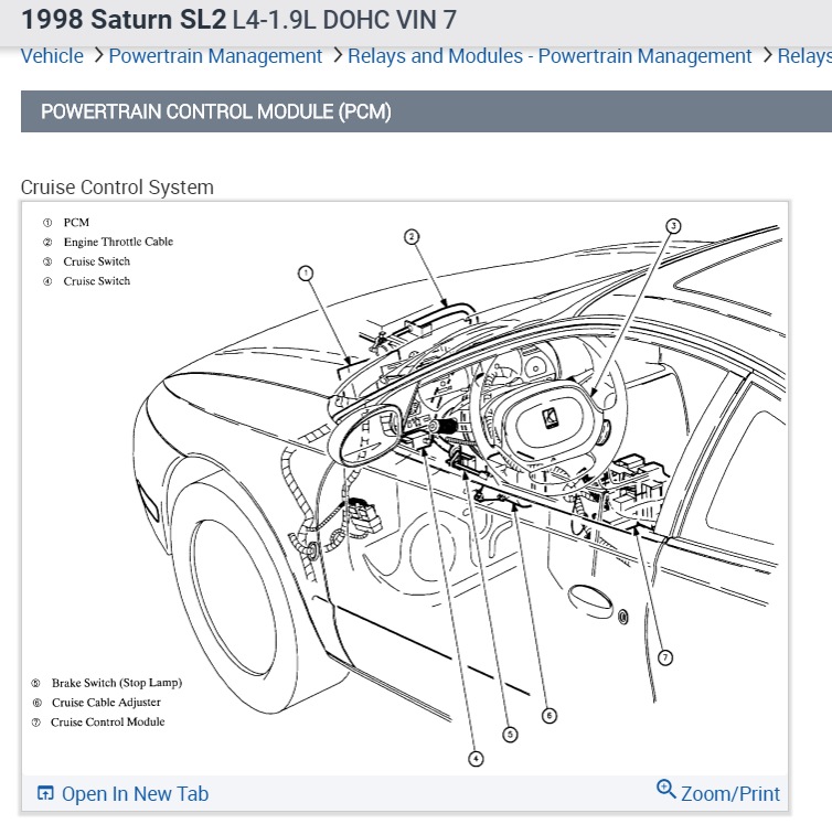

SATURNTECH9
  • 30,869 POSTS
It sounds more like the PCM is not working right I would try a rebuilt or used unit here is the location. Check out the diagrams (Below). Please let us know what you find. We are interested to see what it is.
Sunday, July 18th, 2010 AT 7:14 PM
SHANNON_PRIV
A used PCM cost me $70.00 worked great!
Tuesday, January 22nd, 2019 AT 11:33 AM
