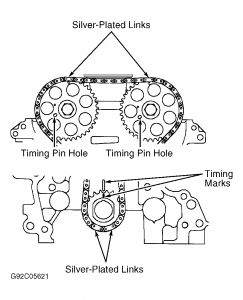

How do you get the bottom gear and the chain to line-up correctly? Always seem to be one-link off.

We are trying to replace the timing chain on our vehicle because the engine quit running after making a lot of friction noise. We discovered that the plastic material on the top and side guides were totally worn out and the chain's tension-er was seized. When installing the new timing chain kit as per the Haynes Book's instructions we were able to align the two top camshaft sprockets so that the two sprocket pin holes could be filled with a drill bit to stop the two camshafts while the new chain's black links can be positioned at twelve o'clock of each camshaft sprocket; however, now I cannot align the bottom crankshaft sprocket with the twelve o'clock mark on the engine block. It is as if there is some kind of internal crankshaft blockage which prevents me from turning the crankshaft. I am able to reach approximately the 12:05 position instead. At this point I can not move the crankshaft counter-clockwise. Initially, when I tried this procedure I was able to reach the twelve o'clock position and I manually turned the crankshaft several complete turns. Then when I put everything back together I disconnected the fuel pump's relay and cranked the engine to test the pressure in the cylinder. then I realized there was no pressure. I attempted to manually turn the crankshaft and discovered that I could not pass the twelve o'clock mark on the engine block. It was at this point when I discovered the crankshaft blockage. We would appreciate any one who could give us some advice on how to resolve this problem. Thank you.

Okay as I am reading this: You replaced the timing chain and tested the engine. Then discovered that you had no pressure in that cylinder.
That is an interference engine and the blockage you feel is the valves hitting the pistons because it is now out of time.
Probably the best solution would be to remove the chain, remove the head and verify that there was/was not contact. Then proceed from there. Especially when you had no compression in that cylinder when you tested. It may have already bent a valve or two when the tension-er and guides were bad initially.

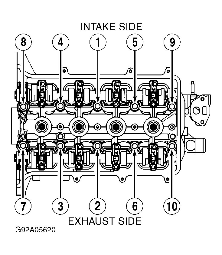

STEVE W.
  • 15,345 POSTS
As a general rule I don't re-use head bolts.
However the book says they can be reused. Just clean the threads and oil them. Then torque in sequence to 22 ft.lbs. (30 N.m) then torque in sequence again to 37 ft.lbs. (50 N.m) Then install an angle gauge and torque in sequence an additional 90 degrees.
Jul 31, 2019 at 11:03 AM (Merged)
SATURNTECH9
  • 30,869 POSTS
Replace the bolts any bolts with a torque angle are stretched and need to be replaced.
