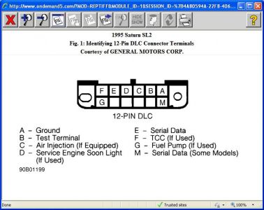

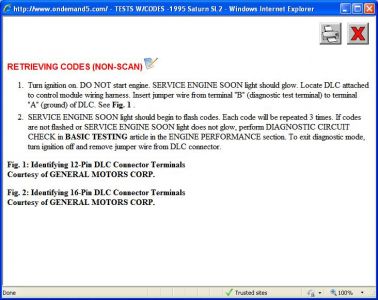

https://images.2carpros.com/forum/automotive_pictures/416332_1995_SL2_code_retrival_part1_1.jpg
https://images.2carpros.com/forum/automotive_pictures/416332_1995_SL2_code_retrival_part2_1.jpg
I posted how to get code's without a scan tool see what code's you have and let me know what number's you have.Code 11 means you have transmission code's.A torque converter doesn't make sense they rarely ever go out on your car.Let me know what code's you have.
