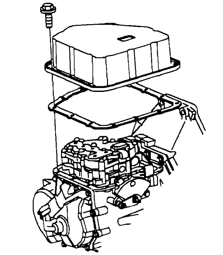

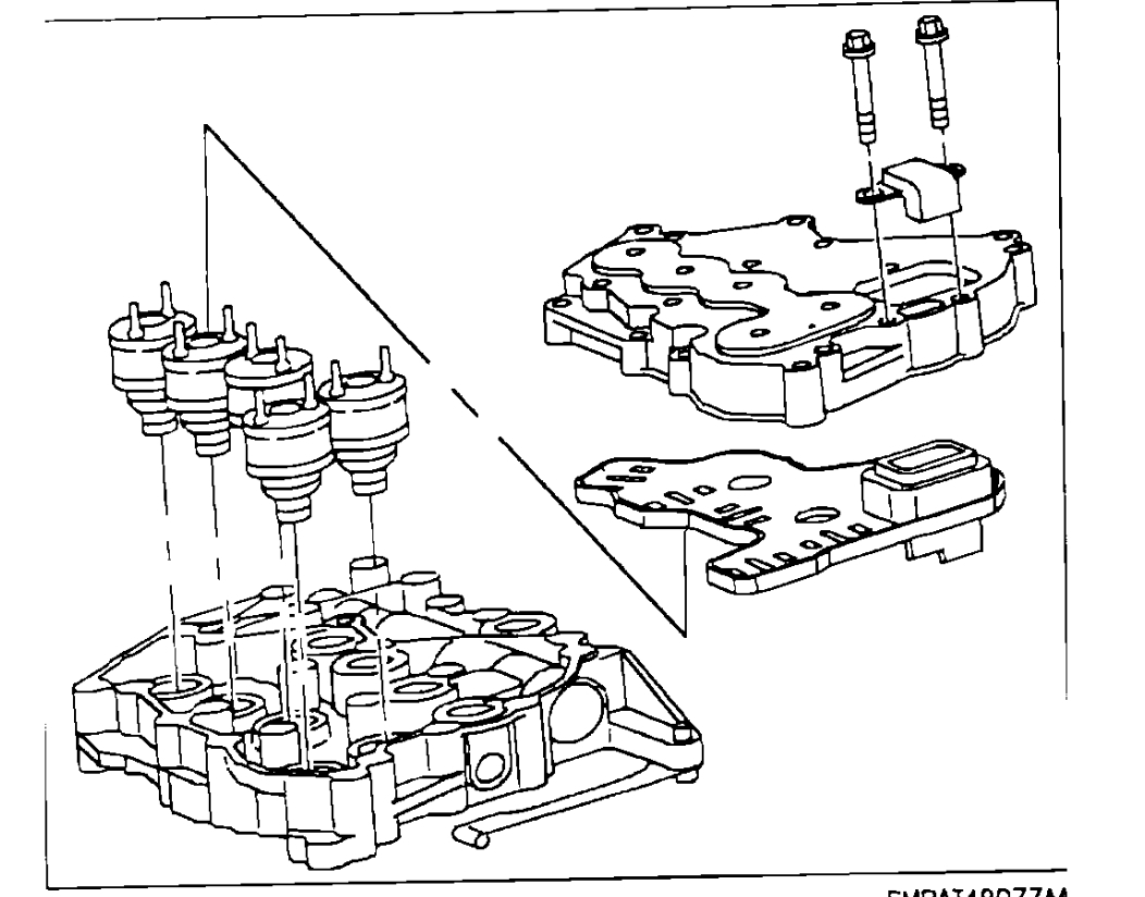

NIXER
I have this same exact problem. Any link to the gear solenoid?
Saturday, February 2nd, 2019 AT 6:36 AM
KEN L
  • MASTER CERTIFIED MECHANIC
  • 47,536 POSTS
Yes, here are the location of the shift solenoids and how to change them. Check out the diagrams (below). Please let us know if you need anything else to get the problem fixed.
