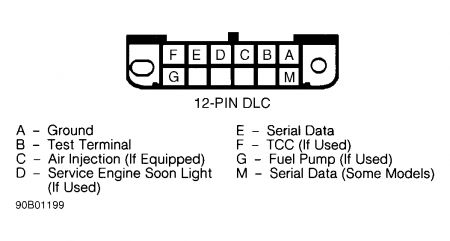

A bad cooling fan relay can cause thequad driver code. Try swapping the cooling fan relay with another one (a/c, something not vital) and see if it fixes the overheating and the check engine light.You will need to clear the codes first by using a jumper wire to go from terminal "B" to terminal "A" (see pic)with ignition on, touch the wire across those 2 terminals 3 times within 5 seconds and it should clear the codes
this connector is located under the dash, drivers side
https://www.2carpros.com/forum/automotive_pictures/1639_saturn_1.jpg
