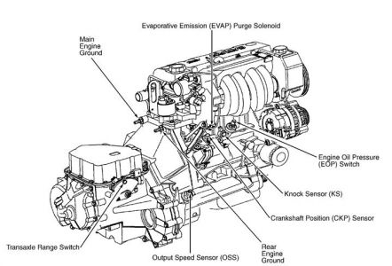

Can you tell me where the cam shaft sensor is located please?

Hi Miser,Welcome to 2carpros and TY for the donation. This model does not use a camshaft position sensor however it uses a crankshaft position sensor. Here is what the manual says This model does not use a camshaft position sensor. "The following is from DTC P0341. The EI module uses capacitive pickup plates located under the 1/4 coil pack to determine the polarity sequence and voltage amplitude of the cylinder 1/4 secondary ignition. The PCM supplies 5 volts on the signal line and expects to see the cylinder #4 signal wire go low after every 14 crankshaft pulses (2 revolutions). This is used to determine the position of the camshaft, except under decel. The PCM only uses the transition from 5 to 0 volts as a valid TDC compression #4 cylinder signal."
https://images.2carpros.com/forum/automotive_pictures/12900_c_28.jpg
