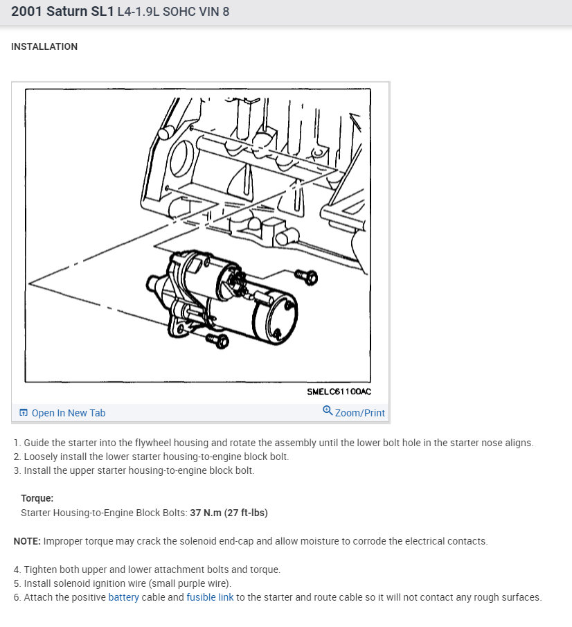

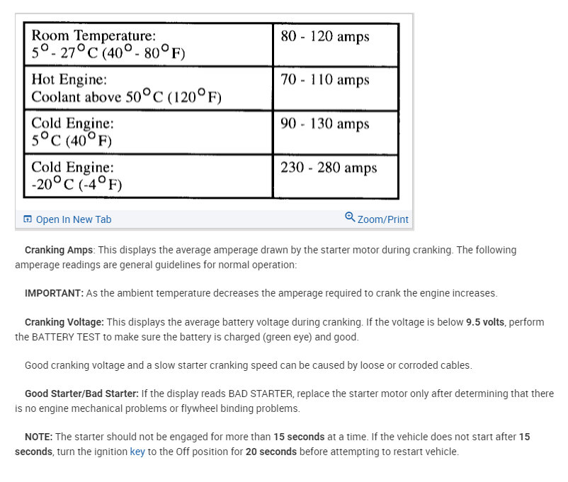

My problem is in the morning I start my car and drive it a short way. When I stop and cut it off, it will not start back up for a while. When it starts back up their is no problem. It has been doing this for a couple months. I have no idea what the problem is.

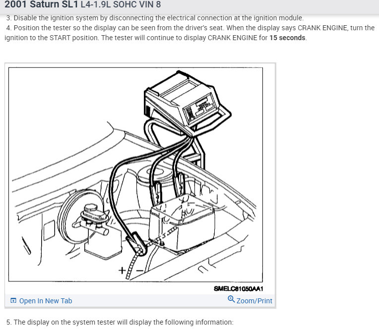

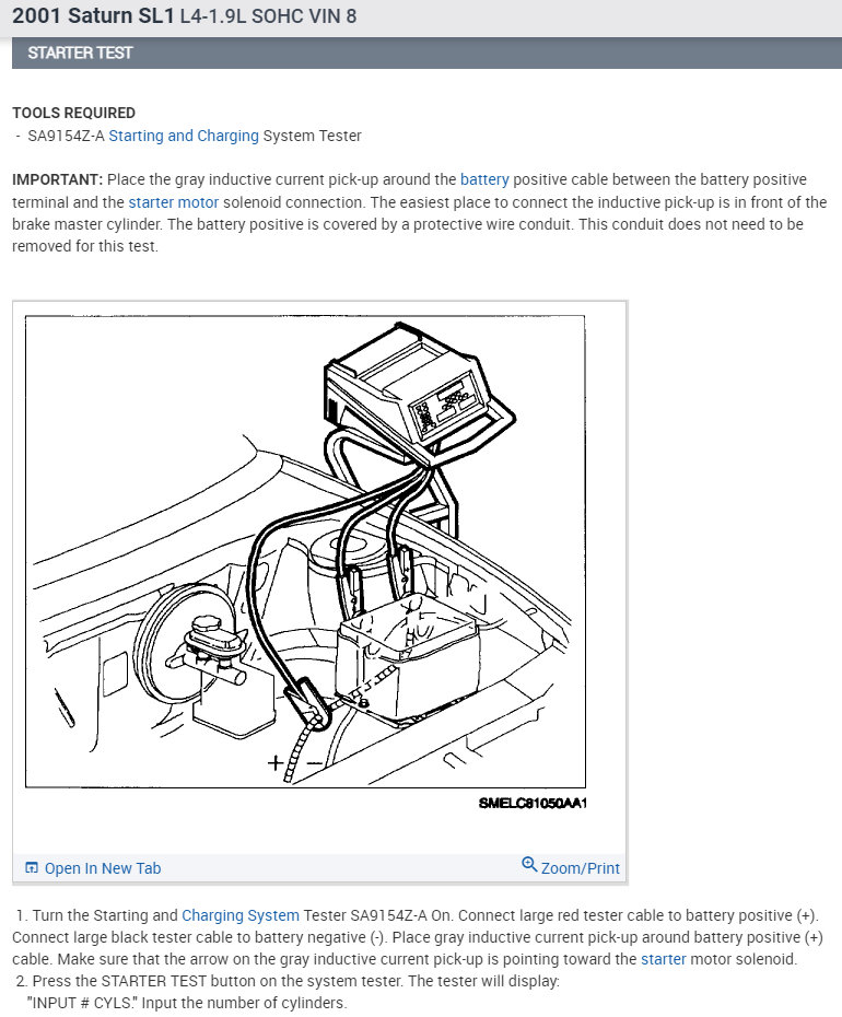

This sounds like the starter is having problems or the battery needs to be load tested these guides can help us fix it.

No crank and no start. It does nothing man. I have tried to jump it and it still does nothing. Some say its the starter and some say its the ignition switch. I hope you can help.
Tuesday, April 20th, 2021 AT 11:16 AM
RONIVEY187
Thank you so much. I have been told it was by the dealership. You are right. Its the starter.

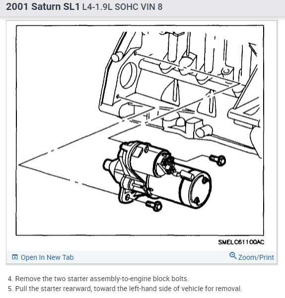

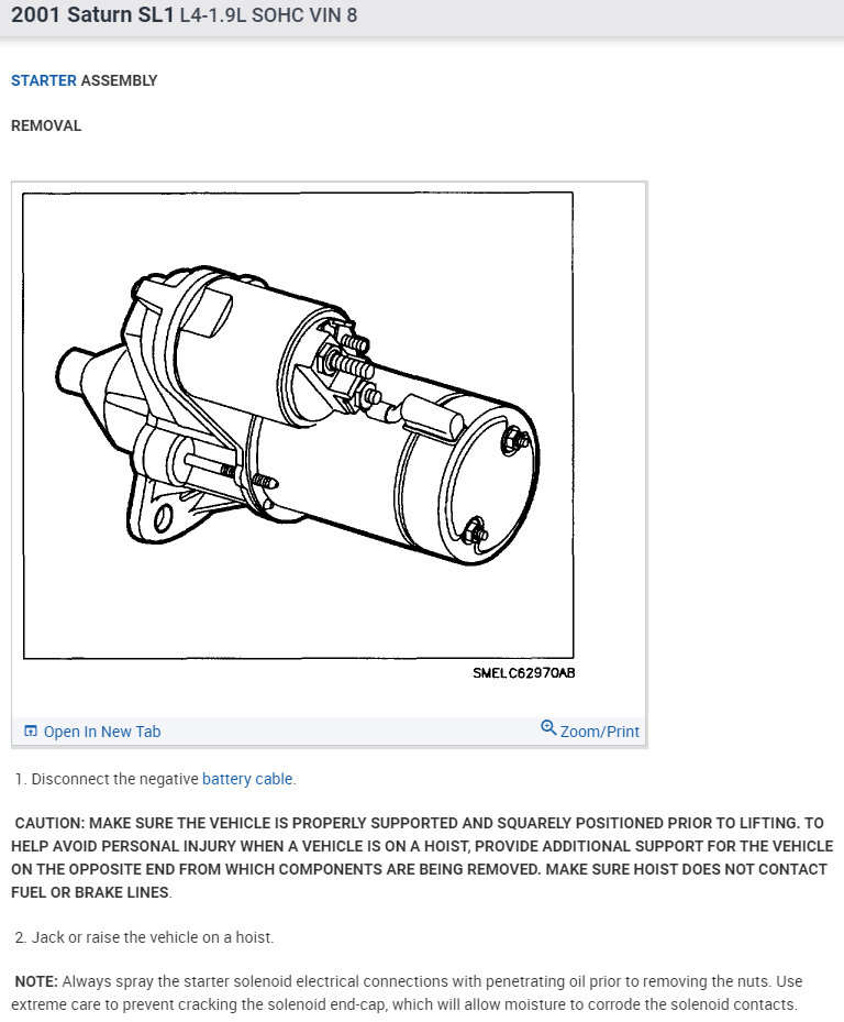

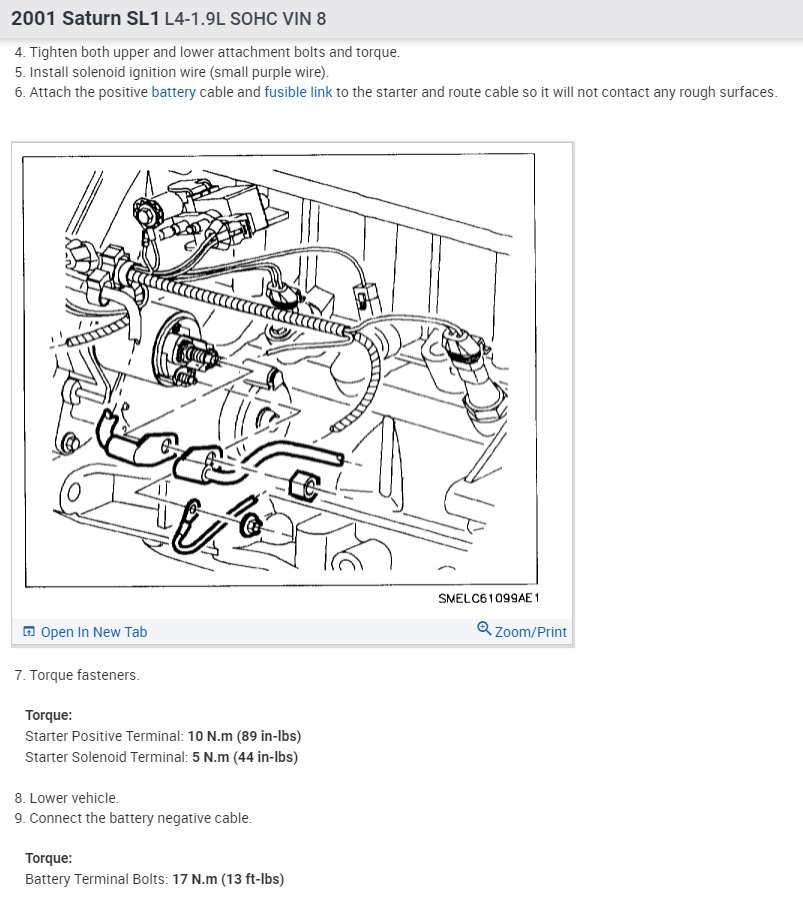

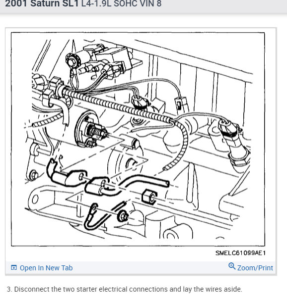

I have attached the starter replacement procedure for this vehicle, for any one else who might be looking for the instructions.
