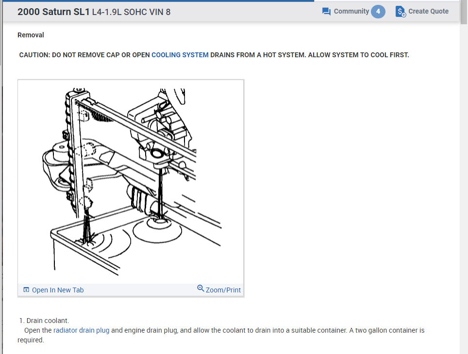

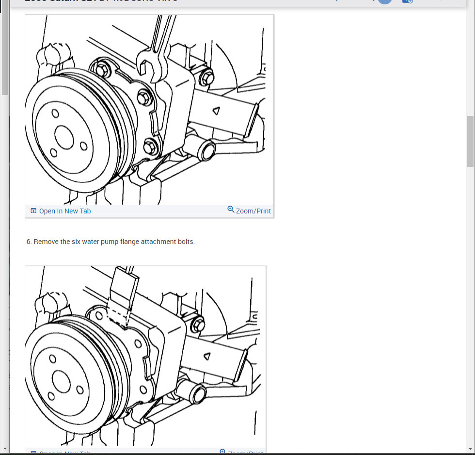

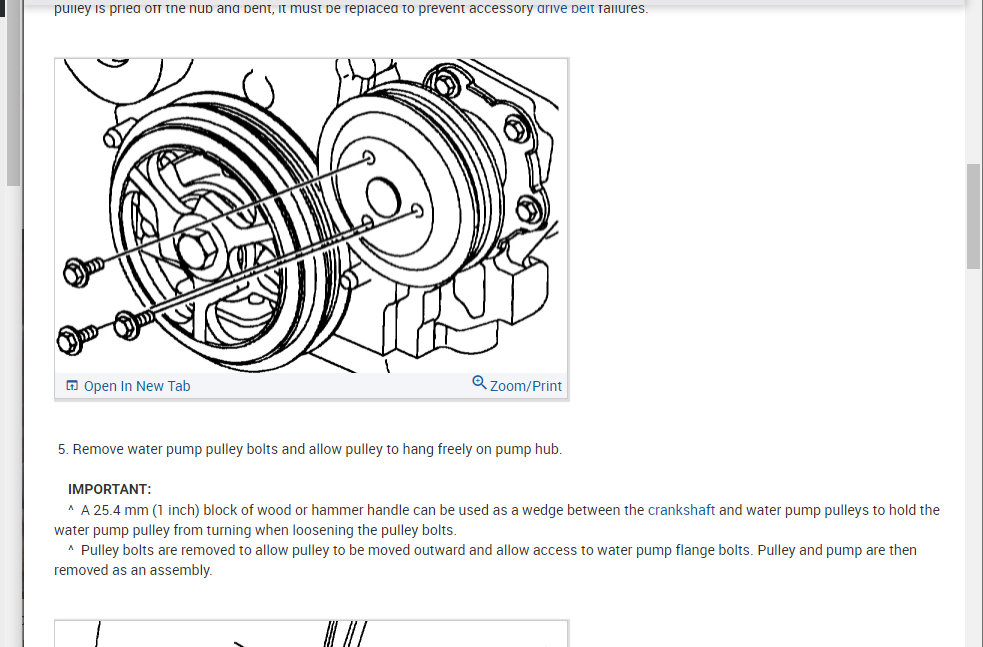

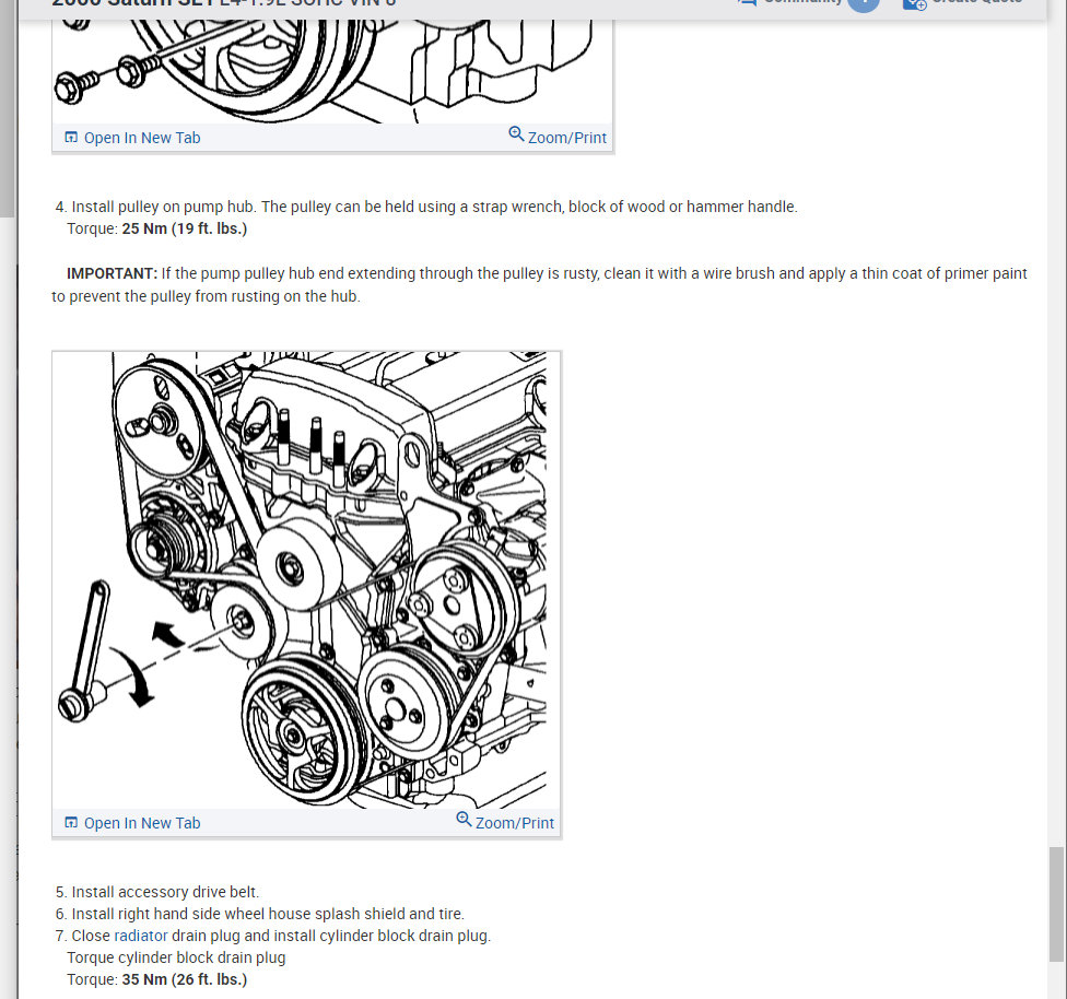

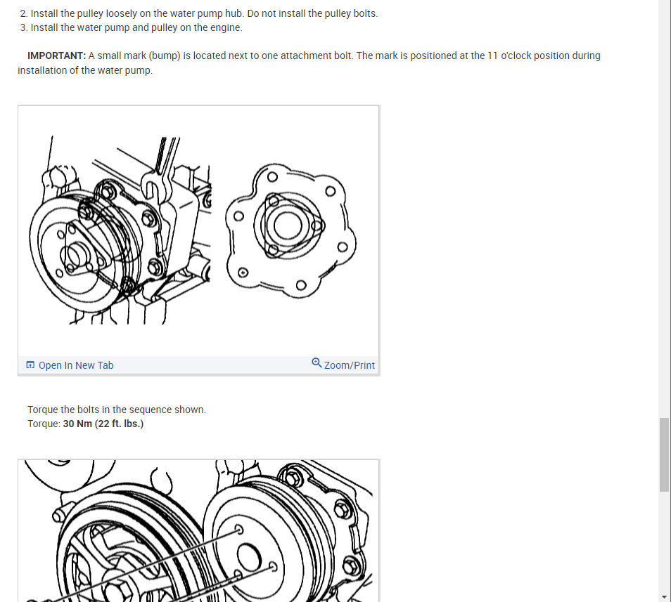

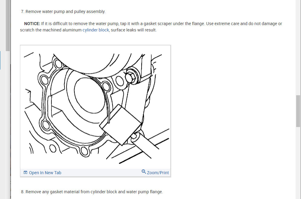

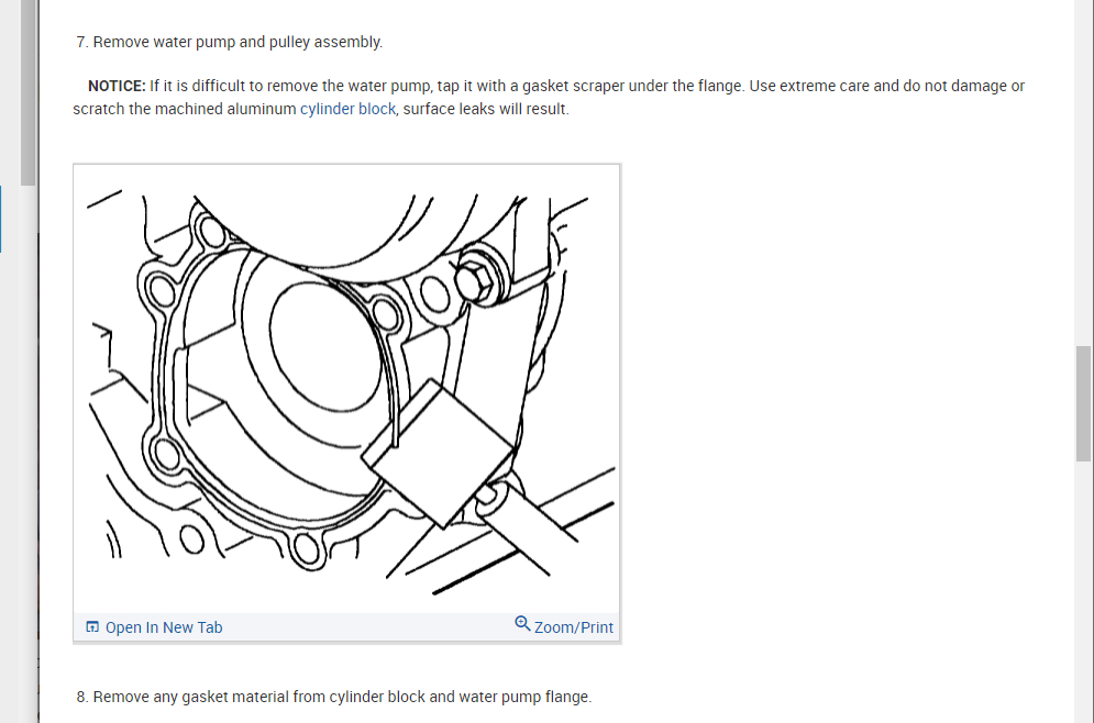

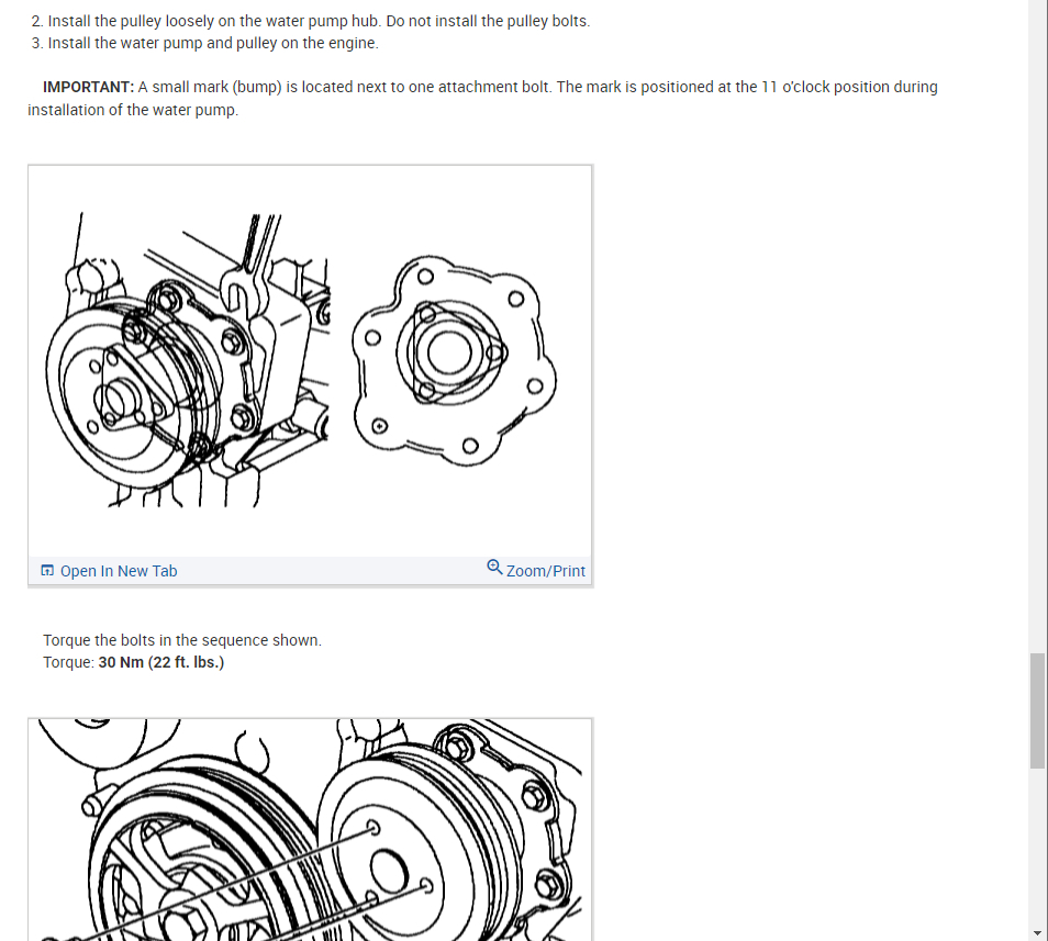

I was wondering how to install a new water pump on a 2000 4-cylinder ls1?
Wednesday, February 10th, 2010 AT 3:02 PM

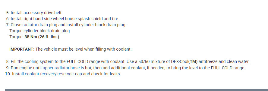

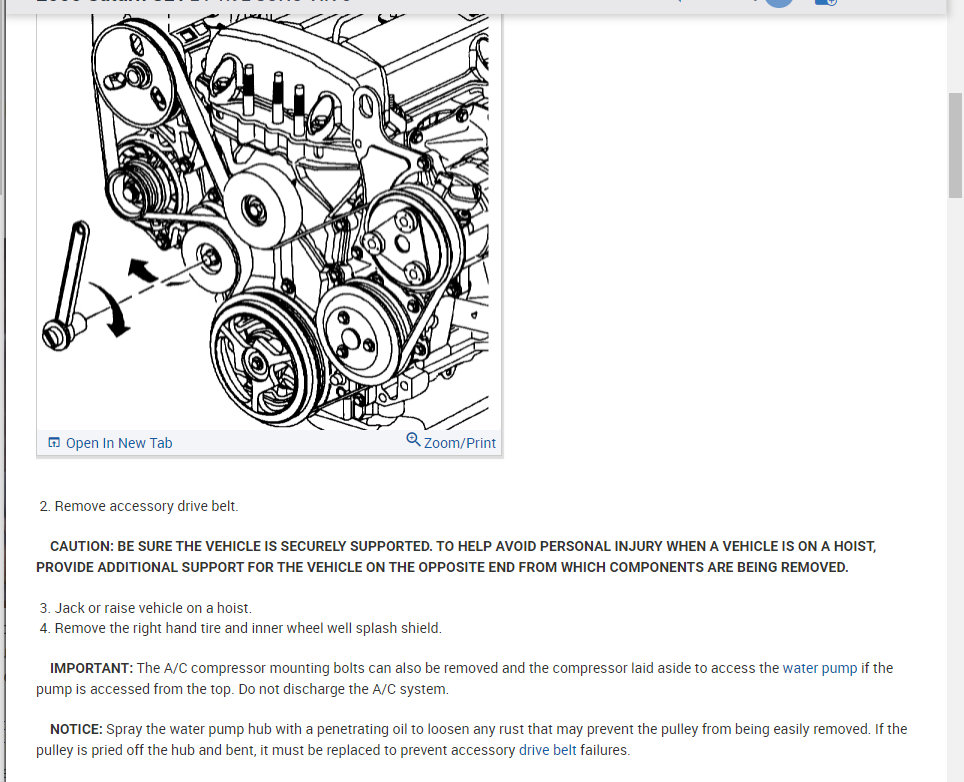

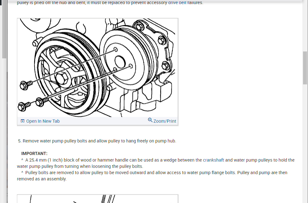

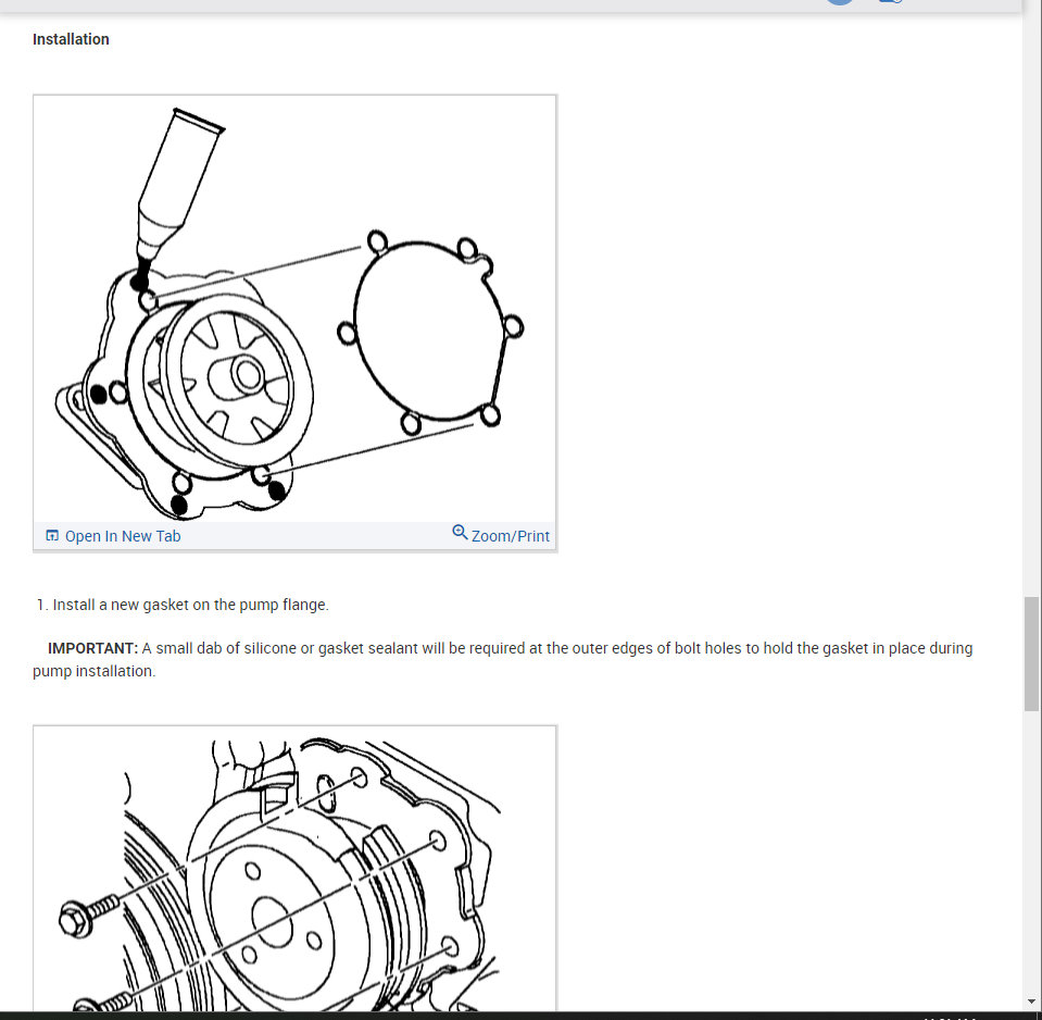

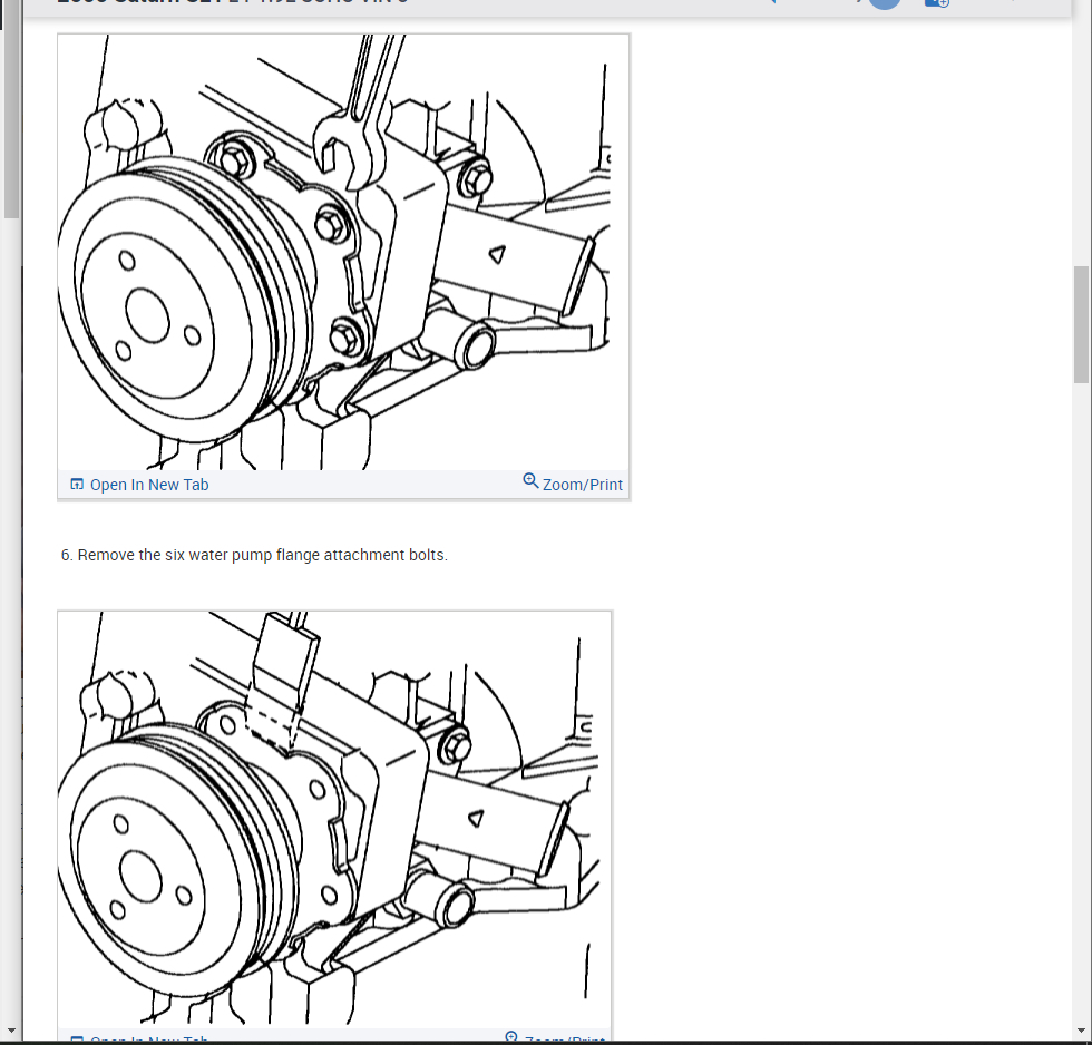

Here is a guide that will help with this:
https://www.2carpros.com/articles/water-pump-replacement
This is not an incredibly difficult but there are a couple steps that need to be done specific to this vehicle.
Below you will find the process from the manual that will help with getting this done.
Please run through this material and let us know what questions you have.
