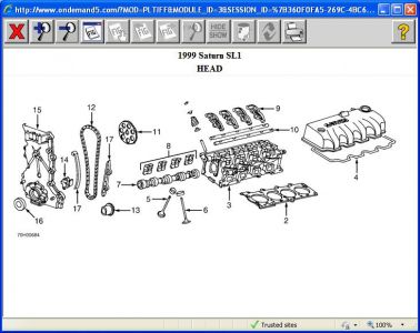

https://images.2carpros.com/forum/automotive_pictures/416332_1999_sl1_valve_cover_1.jpg

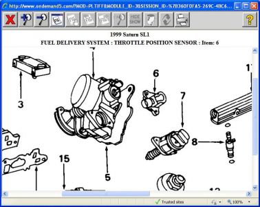

https://images.2carpros.com/forum/automotive_pictures/416332_1999_sl1_iac_1.jpg
if u dont live in california u can get ur codes checked for free from any auto parts store like autozone.u cant find the s shaped hose maybe u have a sl2 and not a sl1 i posted a pic of the sl1 valve cover does urs look like that?if not u have a sl2.so the engine dies when u cover the hole?ok next step then i posted a pic of the throttle body and the idle air control valve its figure 7 i want u to tap on it while the car is idling really high dont hit it hard enough to knock it off of course.just a good tapping see if the idle comes down.and see about getting me some codes if u dont live in california at the auto parts store.let me know what u find.

I tapped on that with no result but i can get it to idle down by partially covering the small hole by the butterfly. What do you think
May 11, 2010 at 9:04 AM
SATURNTECH9
  • 30,868 POSTS
It sounds like the idle air control valve is causing the high rpms but we don't know if the motor is frozen up or if carbon is keeping it from closing the proper depth or if we have a wiring issue keeping it from getting power to the motor to move it in and out.if we saw if it had codes or not that would help also.I would try getting a good brand of carb spray and removing that valve and cleaning the plunger tip and that hole u cover to make the idle go down real good and see if that helps.let me know what u find.

I got the codes this morning. TPS - P0122. I ordered a throttle position sensor. Now I need a drawing to find out where that is. Thanks again.
May 12, 2010 at 3:05 AM
SATURNTECH9
  • 30,868 POSTS
The pic I posted with the throttle body has the tps in it it's figure 6.u can try replace the tps but u could very well have a wire or terminal tightness or some other issue instead.but if u would like to try swaping it that's up too u.let me know what u find.
