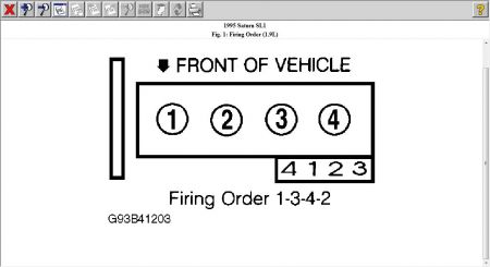

I have a 1995 Saturn Sl1. I need to know the firing order. I have been reading forums and there sems to be a two firing orders for this car. Does any one else have the same make model and year that can help me with this. And also a diagram if possible.
Jan 30, 2009 at 4:18 PM
  • 75,992 POSTS
Here you go-See below for 1.9L
https://images.2carpros.com/forum/automotive_pictures/12900_fo_35.jpg

Ok can anyone tell me how the wires go
