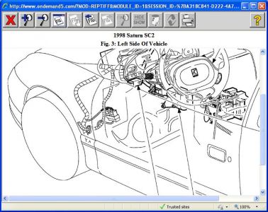

https://images.2carpros.com/forum/automotive_pictures/416332_1998_sc2_chime_module_1.jpg
ok on the back side of ur inside fuse box there is a chime module on the diagram i posted it shows the chime module best pic i could find.the smaller square relay is for the flasher for the turn signal the one below that is ur chime module its larger and rectangler its usually orange brown white blue red one of those colors.remove it by pushing down the release tab at the bottom of the chime module.now take it out look at all the pins on it for corrosion anything like that or bent pins.if it looks good then put it back in make sure its seated tight all the way down then see if the car will start.also check all the fuses.again do u have a multimeter?let me know.

Ok, i removed the chime box and it looked fine. No corrosion or anything like that. Although sometimes it will chime, sometimes it wont. I have a new volt meter but have never used it. Also, just realized my day time running lights arent working either!
