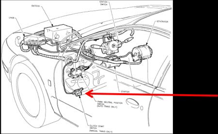

1998 Saturn SC2 4 cyl Two Wheel Drive Manual 100K miles
The car has been balky starting because it was difficult to depress the clutch far enough to allow the engine to satart. It has now failed. Is it something I can easily replace myself. I have just been laid off and don't need to have the car towed to a mechanic if I can avoid it.

Hello - I have attached the pic of where it is located. It must be pretty easy to install as there are not any directions for it. I think Auto Zone has them for about $6.00. Sorry to hear of your job loss..........
