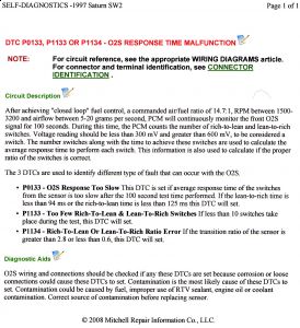

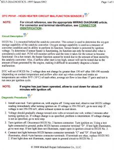

sounds like u found the grounds and they sound like there attached.heres some info on ur codes and a trouble tree for ur p0141.let me know what u find there u could just have a couple of bad o2 sensors.the fronts going bad are pretty common.
https://images.2carpros.com/forum/automotive_pictures/416332_img005_1.jpg
https://images.2carpros.com/forum/automotive_pictures/416332_img006_2.jpg

Thanks! Appreciate the info! The documents are too small/blurry for me to read though? Can you email them, or post them bigger?

Private message me ur email I'll email u those pages.ur front o2 sensor is probably bad real common for those to go bad.not as common for ur rear one to go bad but there's a trouble tree for ur rear o2 sensor follow it.let me know what u find.
