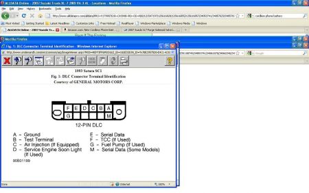

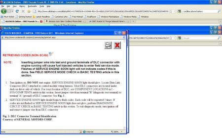

SATURNTECH9
  • 30,869 POSTS
https://images.2carpros.com/forum/automotive_pictures/416332_1993_SC1_code_retrival_part1_1.jpg
https://images.2carpros.com/forum/automotive_pictures/416332_1993_SC1_code_retrival_part2_1.jpg
I was talking about getting your car's trouble code's that are set when your car has when thing's go wrong with it.I posted how to get them let me know what they are.

ok i havent taken it in to get trouble shooted but how do i get these diagrams off this site i cant get them in regular size????? the car over heats quickly and looses power and over revs when it gets hot should i changed the temp sensor aswell so my engine fan actually kicks in it seems like it doesnt kick in at all could this be a problem with the PCM ????? if you could tell me how to get this diagrams off here it would be awesome ........but like i said it seems to lightly clunk into 2nd and clunks hard into 3rd and looses power and revs at high rpm and sometimes doesnt kick into gear at all

I emailed you the info i posted the website we use to get that info is a pay site that all the moderator's on this site use.Which sensor did you replace the top or bottom one?Was the connector going to it corroded?Also how hot does it get when it over heat's?The fan doesn't come on in that car till 3/4 or sometimes the tip of the red.Let's start with what code's you have before we start guessing what is wrong with your car.We still over thing's to check before we know what's going on with your car.
