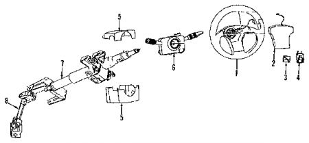

Thanks for the help. One thing though. The wiper switch isn't on the turn signal lever. It's on the right side of the steering wheel. How could it be a bad turn signal switch?
For the interim, would it be advisable to pull the fuse to stop it from running? I'm fearful that leaving it as is could cause the wipers to eventually scratch the windshield or burn out the wiper motor from running the blades against a dry windshield.
Feb 10, 2007 at 6:15 AM
PEPPERMRJ
  • 1,158 POSTS
That would be the combination part of a turnsignal/combination switch. See the illustration number 6. I would pull the fuse and reinsert as needed. Is there anything else weird going on?

The last chrysler minivan that was in my friends shop with a wiper problem had to have the computer replaced.
I found it hard to believe that the switch tells the computer to turn on the wipers. The computer then tells the motor to begin. that is exactly how the system works.
never ever saw another fail like that but boy what an expensive fix.
the dealer may be correct. Each componenet should be tested including the wiring.
Good luck and let us know. :)
