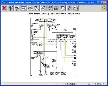

Recently, my passenger mirror was knocked off of my car. Almost immediately thereafter, the door lock/unlock buttons on the doors themselves failed to operate( key less entry still works) Additionally, I can no longer open my trunk( wagon ) door, even with a key. It is locked out and if you hit the key less entry trunk button, the 4way lights flash in the car and there is a click but the trunk doesn't open, still even manually. The light for the odometer is also out. The insurance company is saying it is unrelated to the mirror accident. Could it just be coincidence? Can't find any burned our fuses...haven't checked the breakers yet. Any ideas where I should begin? It is really a pain.

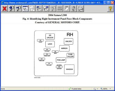

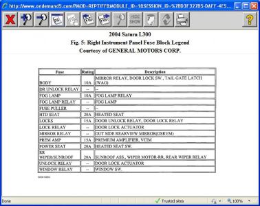

i would start by checking and making sure that ur body fuse in ur right hand fuse box has power to both sides of it.if u look at the body legend i posted it feeds power to ur door lock switchs ur rear lift get and ur mirror.so check that out and let me know what u find.
